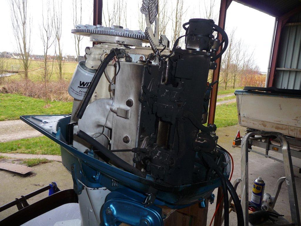

Hi Homelite folks, my name is Chris from the Netherlands and I would like to share this disaster. After a few initial succesful startups and some more finetuning of the ignition this happened due to a backfire in combination with dripped fuel and fuel soaked tissues I forgot to remove. How stupid of me to become so careless in this final stage!!
A compression test proved that one of the cylinders has a sticking/bad valve which must have caused the backfire.
I looks worse than it is, but my recently refurbished carburettors are more or less finished due to melted internals. I am glad to have another 2,5 of these engines...

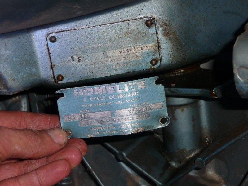

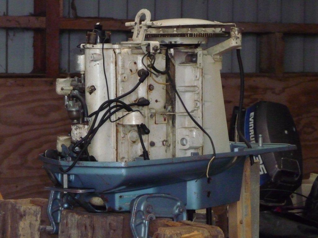

Funny thing: the serial number from the Homelite I purchased recently is only 1 digit up from the engine I bought last september and is now running (with a replaced lower motor pan).
