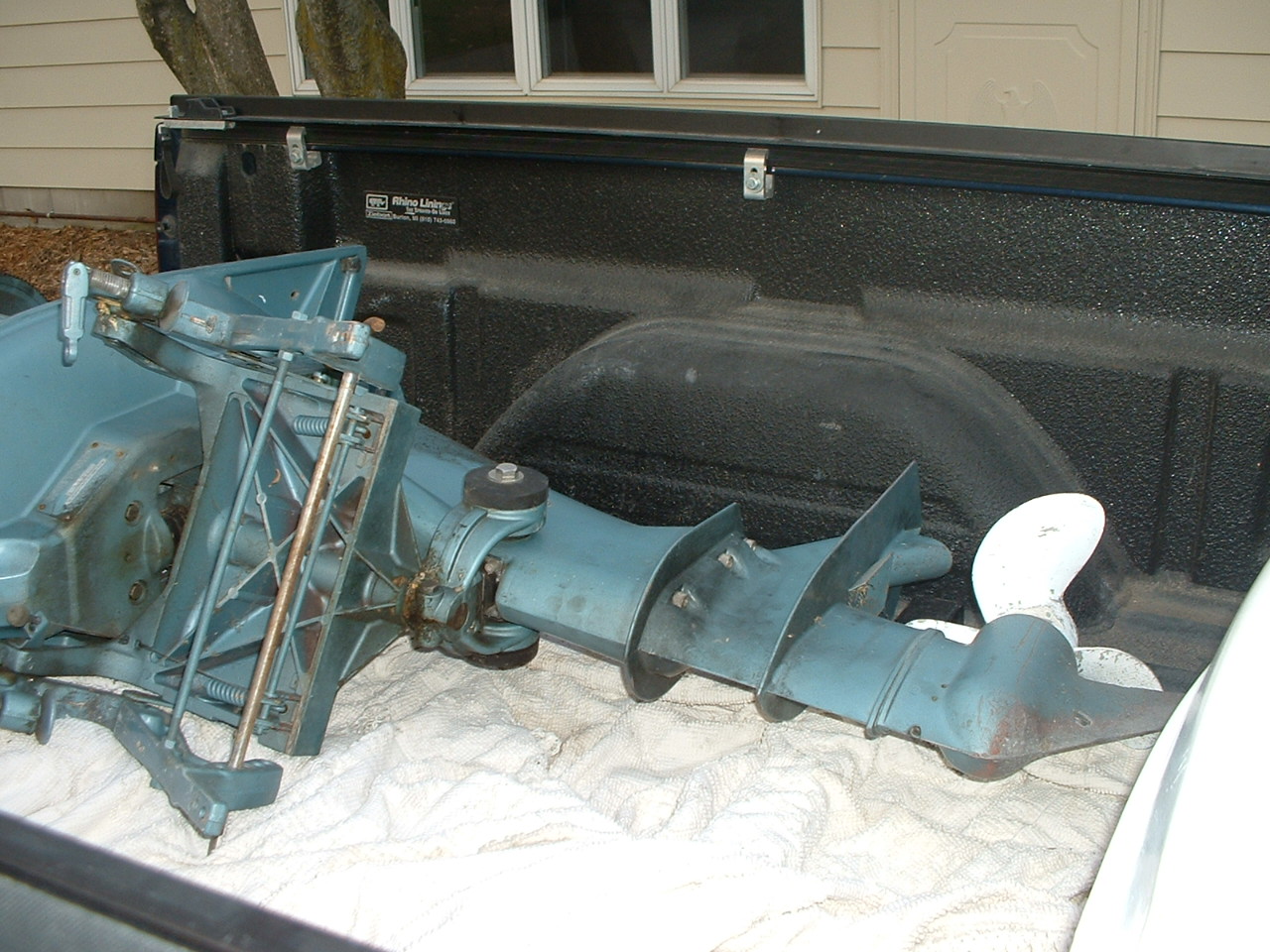

Bill, great post. Nice to hear from you. Did you see the repair I did on the pivot bracket? I can now move on. As I go thru this outboard, there are alot of parts that need to be replaced and some that are even missing. Check it out.
Craig

Nice Craig! Those break frequently because they are a tilt lock, not a trailering lock.

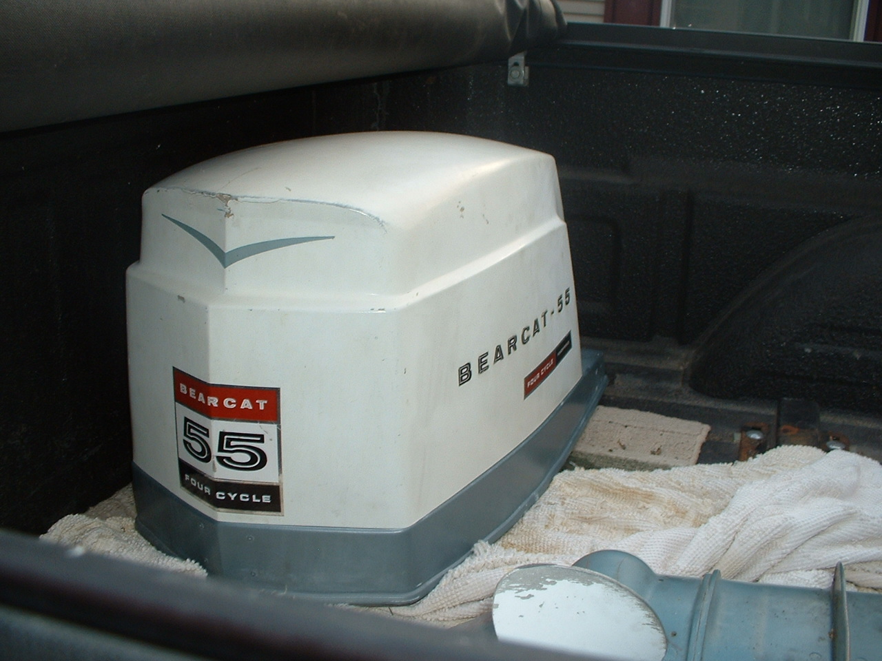

Sounds wonderful. Never can have too many Homelite/Bearcats!
I hope to run my 70 Bearcat on my pontoon this summer. Going to swap out the 62 Homlite that's on it now. Already rigged. Shouldn't take to long. B)
Re:Bought another one 14 years 7 months ago #56631
Elgindave, it looks like you have the same cowling that I do. I wanted the "George Jetson" type, but, they're too expensive. I'll stick with what I have and just repair it. The one you have looks really nice.
Re:Bought another one 14 years 7 months ago #56719
Thanks. I hope the motor runs as good as it looks B)

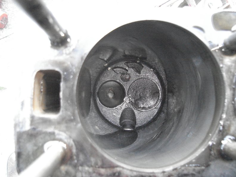

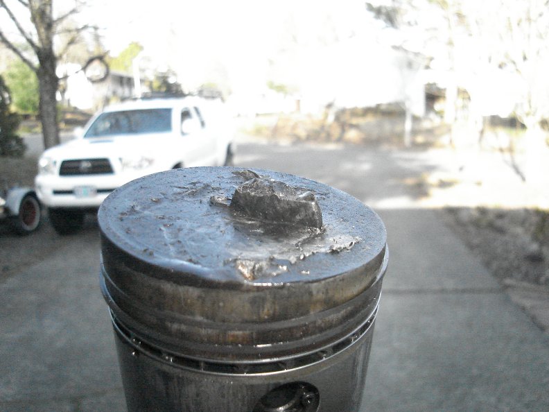

I decided to see how bad it was, it's not pretty!!!

Re:Bought another one 14 years 7 months ago #57007
yewwuuuuu!!!! You are right. It doesn't look good.
Good luck :(
Re:Bought another one 14 years 7 months ago #57016
I used to repair VW engines. That's called "suckin' a valve". Another bad thing, is that it puts small metal pieces all thu the engine. Good news, you get to build a new engine! Zyglow the block to make sure it isn't cracked. It shouldn't be.
