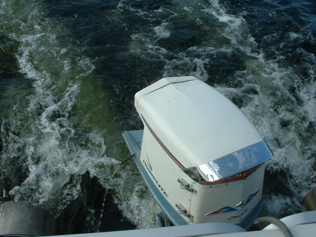

Hi All;
Got my 62 Homelite powered pontoon back in the water for another season.
Changed the lower unit oil , motor oil and replaced the bridge rectifier. The first one blew after the fire. (No comment)
This is fused. What was I thinking? Wasn't.
I plan on wiring a tach and ampmeter to it also. I have the gauges it is just a matter of installing them.
Going to replace the speakers and the wires too for the stereo.
It seems to be charging. I have a fishfinder with a voltmeter on it. The voltage reading goes up a little when I run her Rs" up.
Right now it is wired up on low. I might connect the other wire if the low setting doesn't charge enough. B)
Re: Homelite powered pontoon back in for the season 15 years 5 months ago #32303
Dave, really nice ride.
