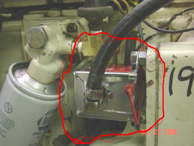

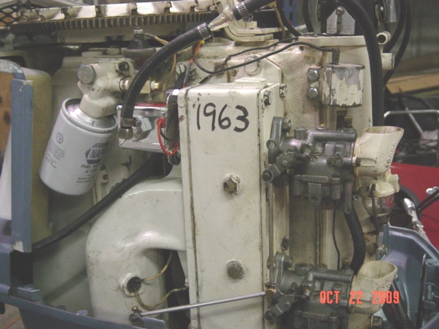

Re:electric fuel pump 14 years 9 months ago #54399
Got the fuel pump yesterday. Even comes with a fuel filter. I hope to mount it on the Bearcat this spring before I put it on my pontoon. :woohoo:
Re:electric fuel pump 14 years 9 months ago #54440
I now have two boats with Homelites with electric fuel pumps. Both work as advertised ---but--- I don't think I will do electric fuel pumps on any other motors. They are to noisy! They click very rapidly and very loud. I find the noisy very disquieting. I have one of the pumps mounted on the side of the motor and the other mounted on the inside of the transom. Both make the same loud clicking noise. I even went as far as to wrap the transom mounted pump with insulation and isolate it from the transom itself in an attempt to quite it down and it was still to noisy. I called the manufacture and they told me there was nothing wrong with the pumps and that is how they were.
