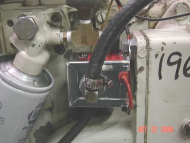

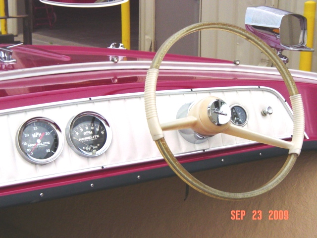

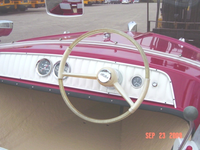

Tom: I have installed manual oil pressure gauges (not electric) in three of my boats with Homelites. Oil pressure varies from 10 psi at idle to 40 PSI at full speed. I install a brass tee at the original sender and run a very small diameter tube up to the gauge mounted in the dash. I leave the original system in place so I in essences have two oil pressure monitoring systems. The tubing is available at the auto parts store. Brass fittings at Menard's.
Greg Anderson
Wisconsin
see pressure gauge through steering wheel
Note brass tee is located just above the electric fuel pump and original sender sticks straight up and small tube connects straight out. The brass tee is somewhat obscured by the fuel hose off the electric fuel pump.
