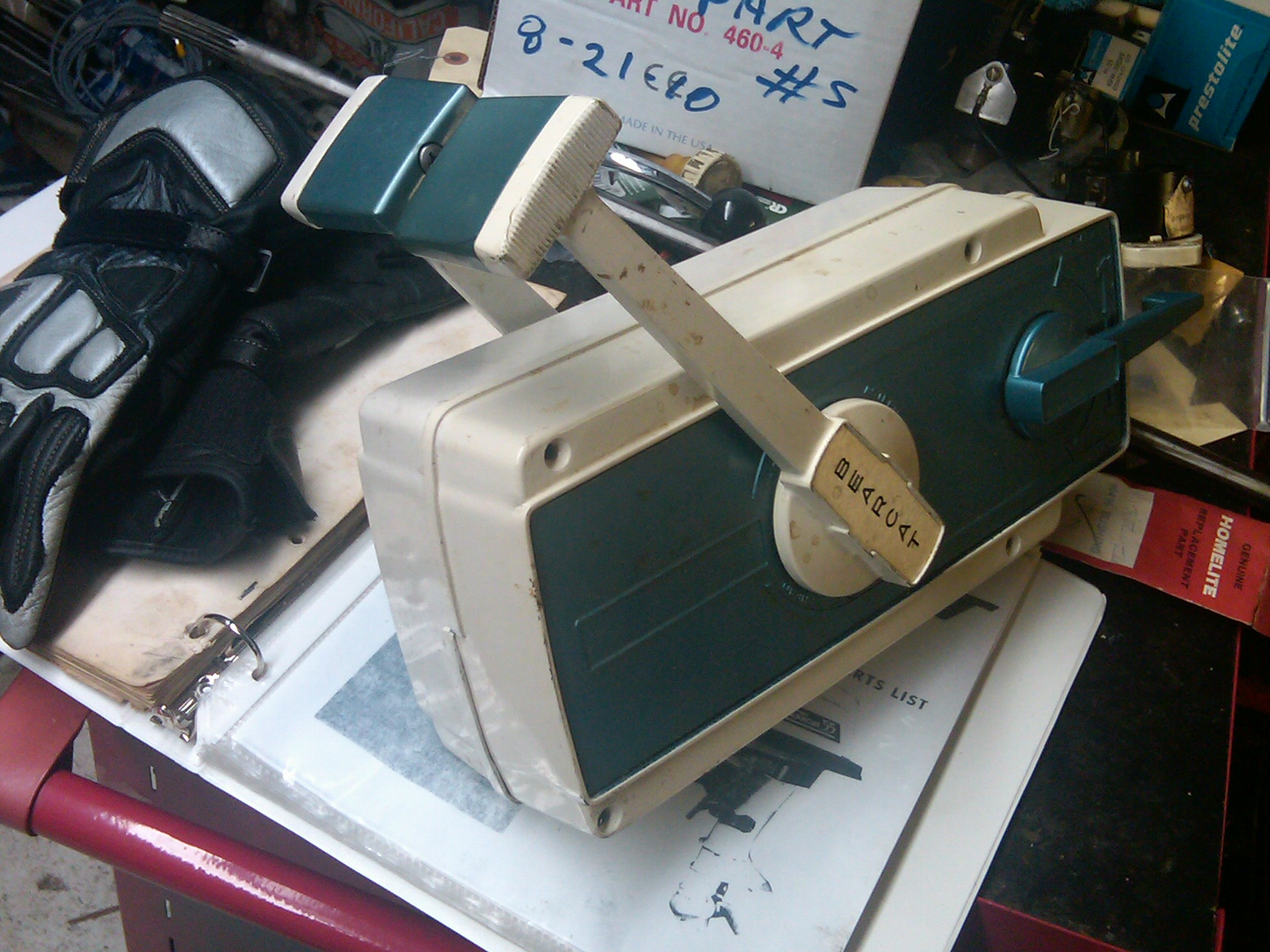

They bolt back to back.

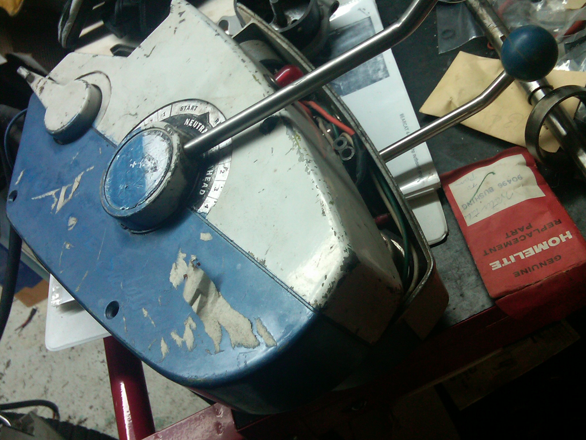

For the Safety Mate style with the ignition switch/horn/red light you need a port and starboard control box bolted back to back.
For the later rectangular Bearcat style control box, same thing.

The late style are reversible, port or stbd. Same control, just remove the handle and flip it 180 degrees and move the shift/throttle cable to the other position provided.
Figured that's what you need for early controls, I have both a port and stbd and was going to try that.

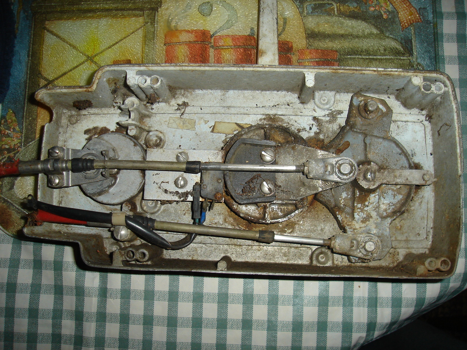

Dick is right, the late Bearcat controls are cast such that the mating flange allows the controls to be placed port or starboard, or mated together, here's a pic of them mated for twin control.
On the Safety-Mate controls, the starboard control has a small peripheral flange that allows the port side control to fit inside the ridge on the starboard side when running twins. So port and starboard are two distinctly different castings.
One pic shows them mated, the last shows the port with no ridge atop the starboard with the ridge.
Hope this helps.
