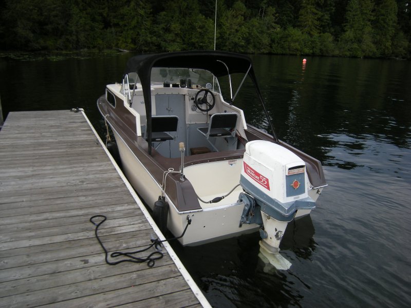

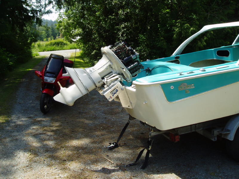

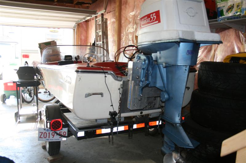

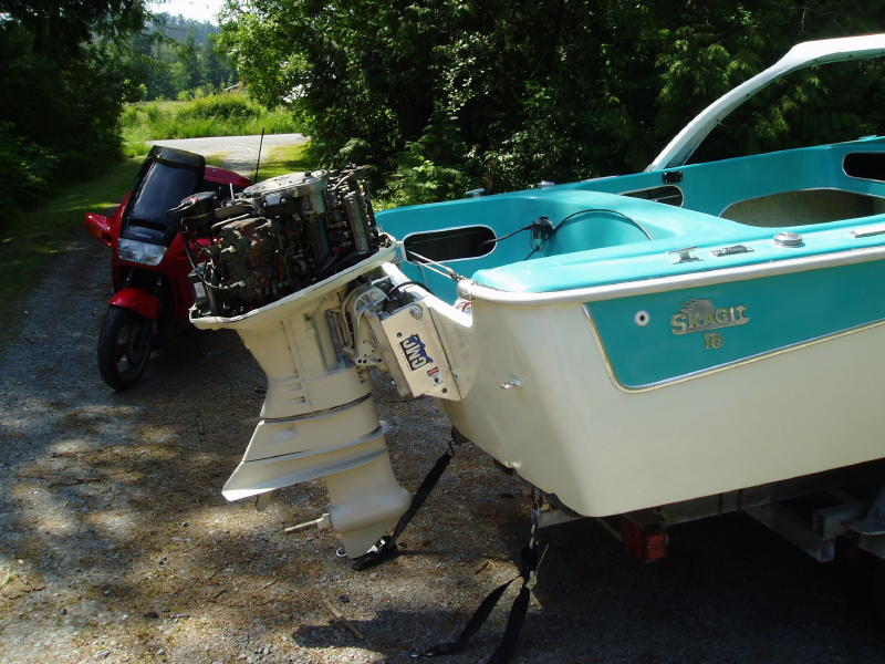

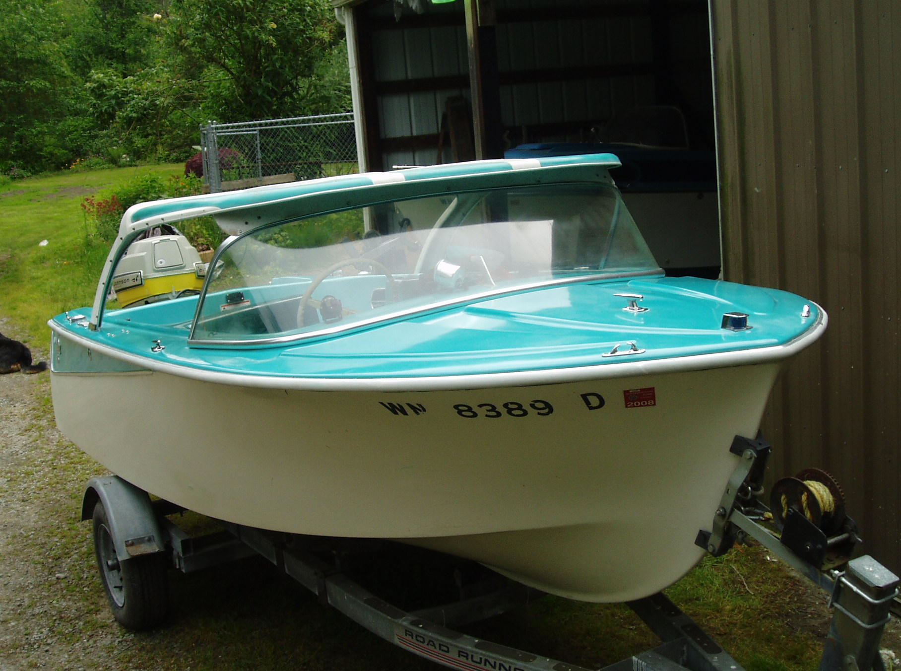

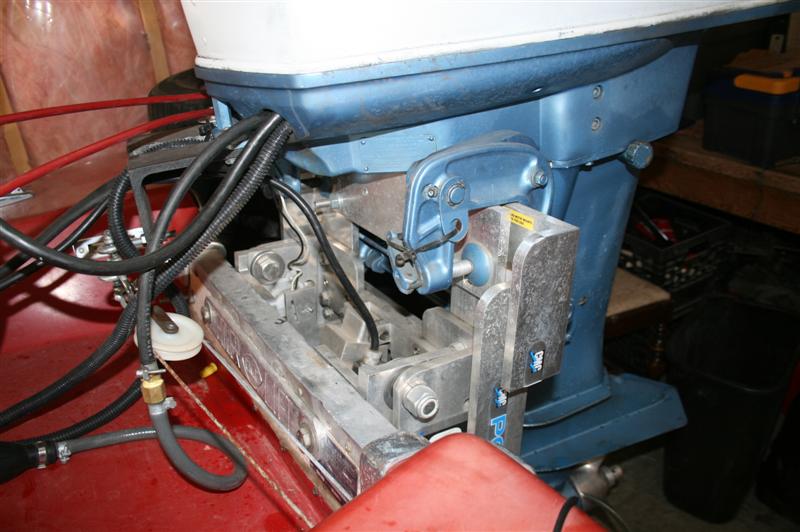

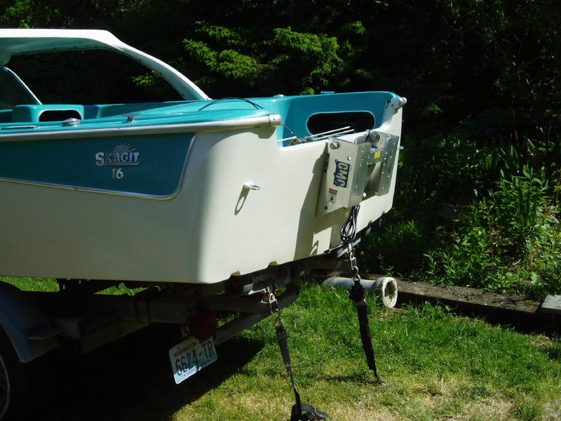

Here's pics of how one of my customers adapted a CMC tilt/trim unit for use with his Bearcat 55.
In these pics he's using a 20" shaft motor on a 15" transom.
I have done it using wood spacer blocks fabricated onsite when I ran both Bearcat 55 or Bearcat 85 outboards on my Skagit 20.
In my case I've been using a 20" shaft motor on a 20" transom.
I have also used a Panther tilt/trim bracket in the past, and also a CMC bracket. Either will work. I have not used a Powertran. Yet.
I'll get those pics later.
If someone is interested to the point you're going to do this email me direct and I'll shoot you a ton of pics which is faster than uploading them all here. Go to my site www.bearcat55.com and you'll see my email address there if you don't have it. Or PM me here.
Anyway, here's pics that some of you have emailed me about.
PTT is Nice if you beach your boat, kinda brings the motor up into the current century.....!

Joe, I have the CMC on my 16ft Skagit with 100HP Johnson. I really like it. I don't think I would be interested in a boat without power trim. Great for beaching and great for helping the boat to ride better in all kinds of water. If you ever are up LaConner way come and look at it. Clint

They are nice, and very heavy duty almost overkill.
I've used CMC and Panther.
You have to do some onsite fab to fit the unusually wide Bearcat transom clamp assy to the tilt unit.
I would also check the other makes if doing it again, www.powrtran.com/ etc etc.
