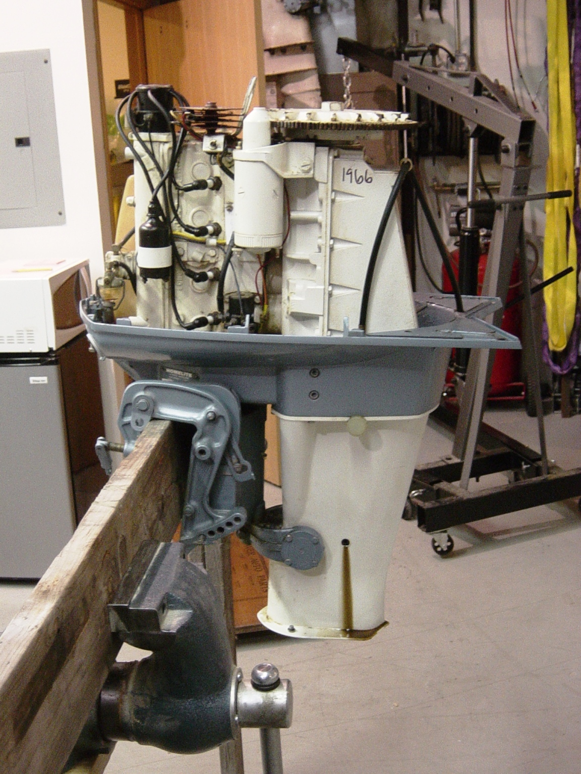

With a tip from Bill Roberts I was able to pickup a 1966 Homelite that was located only 1.75 hours away from me. I have drove 19 hours round trip to pickup a motor. So if one is found near me I hate to pass it up.
This motor is the cleanest of any motor that I have ever come across with the exception of a "F" Model that I purchased from Bill. Although the cowling is not shown in the photo its in as good of shape as the motor. Compression at 185, 190, 165, 185. The gear case was off of it when I picked it up. It appears the owner was changing out the impeller and never finished. It shifts and rotates like it should so I am feeling good about the gear case. Drained the oils and made a few notes and put them in a file I create for each motor and will put it to bed waiting for a boat.
Thanks again Bill for the tip!!!!!

pretty lucky there Greg. Looks way clean. I have come across a couple over here but they are pretty pricy anymore.

Great news Greg, happy to assist.
When he sent those pics I figured she was a winner.

Looks like a nice one for sure! In my last batch which Bill also gave me the tip there was a '66. That was #8 for me. I find '66 strange as it was a transition year. My '66 has the late motor mounts with the extra mounting lug on the cam tower, the oil fill is in the crankcase and it is not an "A" block. My '65 has the oil fill on top of the block behind the distributor, last year in a batch of parts I bought I got an "A" block which also had the oil fill like the '65. Seems strange they would change the location of the oil fill to the crankcase and then go back to top of the block only to go back to the crankcase again??????

4stroke you are right. The oil fill access is back on the top for 66. I however only have the two studs holding on the valve cover. This motor has the two water lines running out of the water pump. I will be removing the thermostat and blocking that off all together. Eliminating that water line from the water pump. Changing it back to a single water line. I like to remove the thermostat and eliminate the possible problem of a malfunction. For those that say the motor will run to cool and carbon up I say you are probably right. I run these motors early in the season in 40 degree water. But I run them for maybe 5 to 10 hours in those conditions and I feel this will have little to no impact.

Greg, my '66 also has the two line waterpump but the the four lugs and the filler on the crankcase. I'm also noticing yours has the finned rectifier, mine has the two stud waterjacket mounted rectifier. Near as I can tell the engine "seems" original. It's like the first mod they made was the motor mounts before actually producing the "A" block engine.
