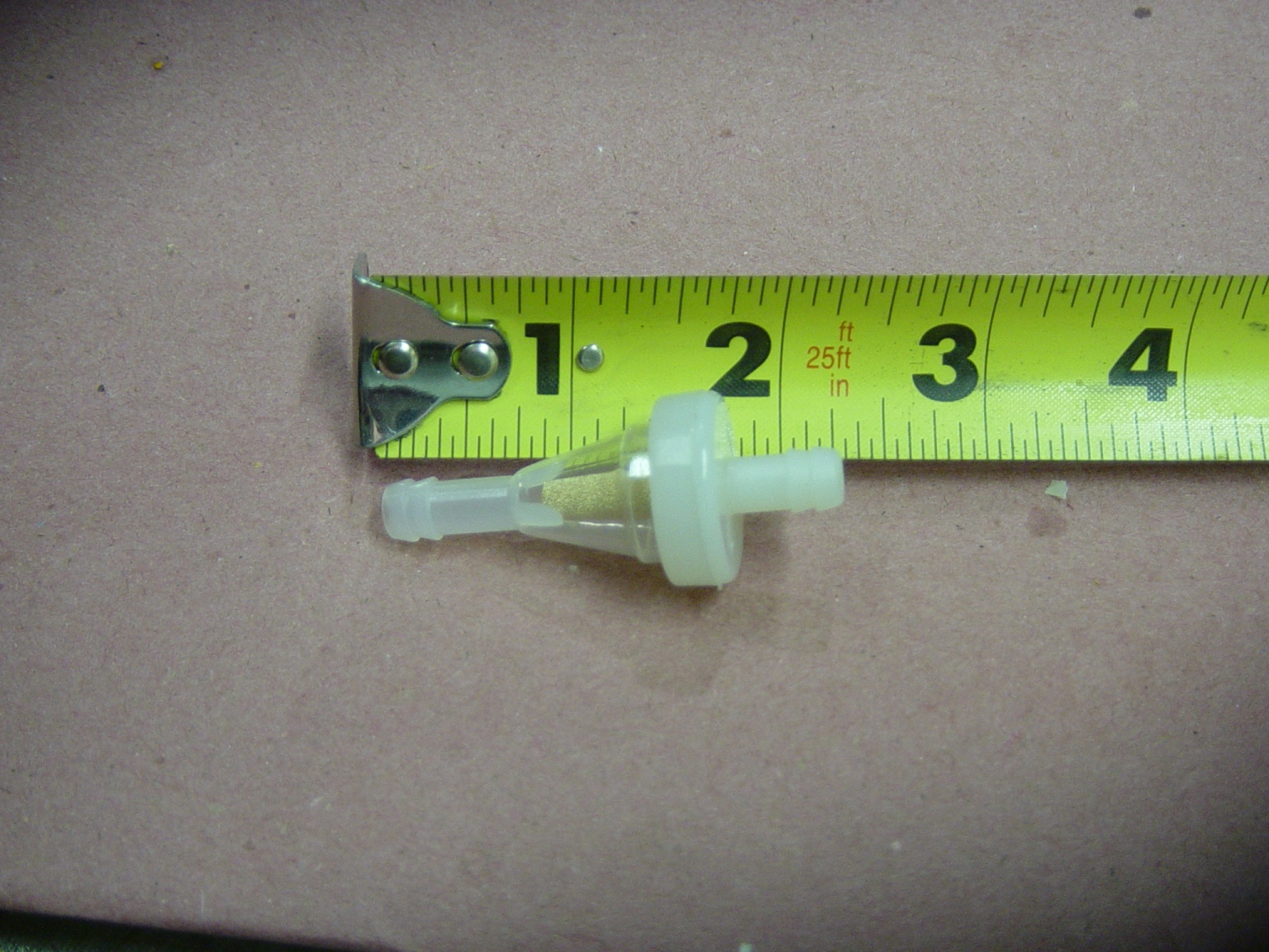

I'm going to add a tach and an inline fuel filter. B)
Re:Winter projects Homelite/Bearcats ? 15 years 10 months ago #22340

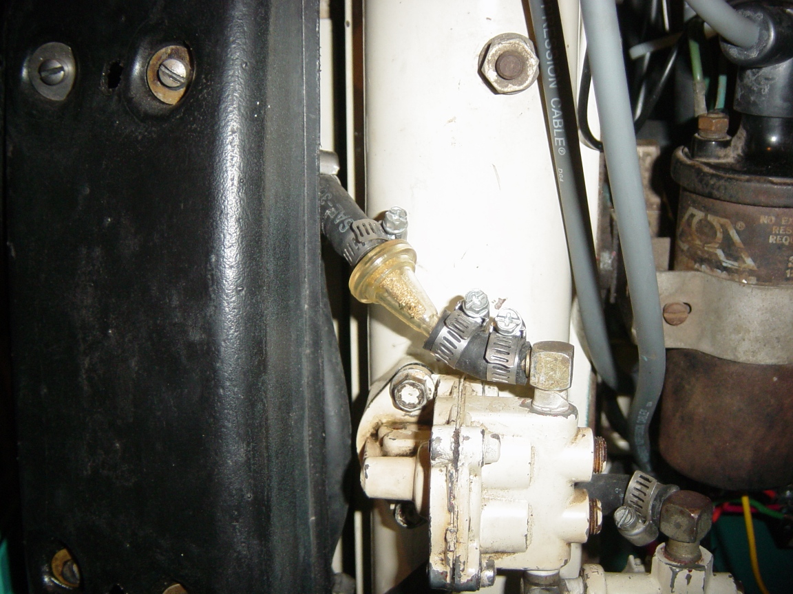

Elgindave: Very good idea to install an inline fuel filter. I have been caught twice disabled on the lake because of NO inline filter. What happened on both occasions very small flakes of the rubber coated diaphragm in the fuel pump flaked off and lodged in the carb needle valve flooding out the carb killing the engine. I have found in every Homelite that I own (9 total) the diaphragm is cracked and flaking off.
In one of the instances the diaphragm actualy cracked and fuel
was being pumped into the crankcase. The motor would still run because the fuel pump was able to keep up with the demand of the motor along with the leak into the crankcase. How I found out I had a problem is I checked the oil and fuel just poured out of the dipstick hole. I estimated the oil was diluted with an additional quart of fuel. I ran the engine for probably an hour like this. Motor still runs fine with NO decline in compression. I bet the inside of this engine is very clean. These are tough motors!
I have not been able to find replacement diaphragms so I take the best one I can find off my motor inventory and use that one.
I have installed an electric fuel on one motor that works great.
If you zoom in on the last photo you can see the black flakes of diaphragm in the filter.

Greg,
Mine has a sediment bowl too. But a filter is the best bet.
After you telling about getting fuel in the crankcase I'm going to start checking my oil often. Don't want any premature wear.

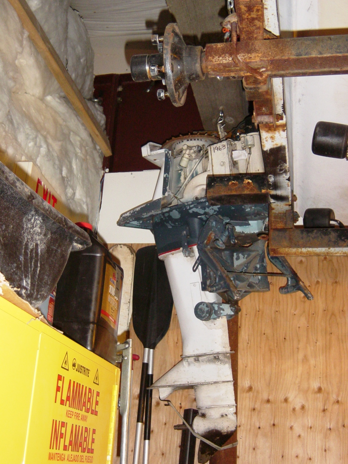

The photo in my 1st post was right after I got my Homelite home. It was laying on a trailer under a tarp in a barn. The lower unit had a big hole in it. Got a replacement from Bill R.

Re:Winter projects Homelite/Bearcats ? 15 years 10 months ago #22352
Elgindave: All my motors have the sediment bowl also. The screen in the top of the bowl is course enough to allow passage of the small rubber partials I spoke of.

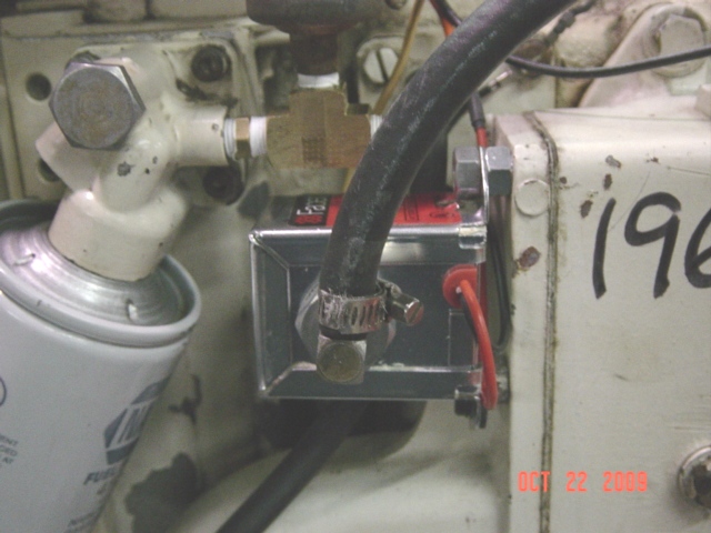

Greg wrote;
Facet #2001?

Re:Winter projects Homelite/Bearcats ? 15 years 10 months ago #22395
Mark: A very good guess! I used a Facet #1102. I was after a pump in the 1 PSI range as to not over pressure the carbs forcing fuel past the system and into the motor or out the overflow holes. (If fuel was able to getting past the needle valves) If everything is working like it is suppose to a 3 PSI pump would work fine also.
Source:
Electronic Fuel Pump: www.pegasusautoracing.com , 1-800-688-6946
Pegasus Auto Racing part #40140

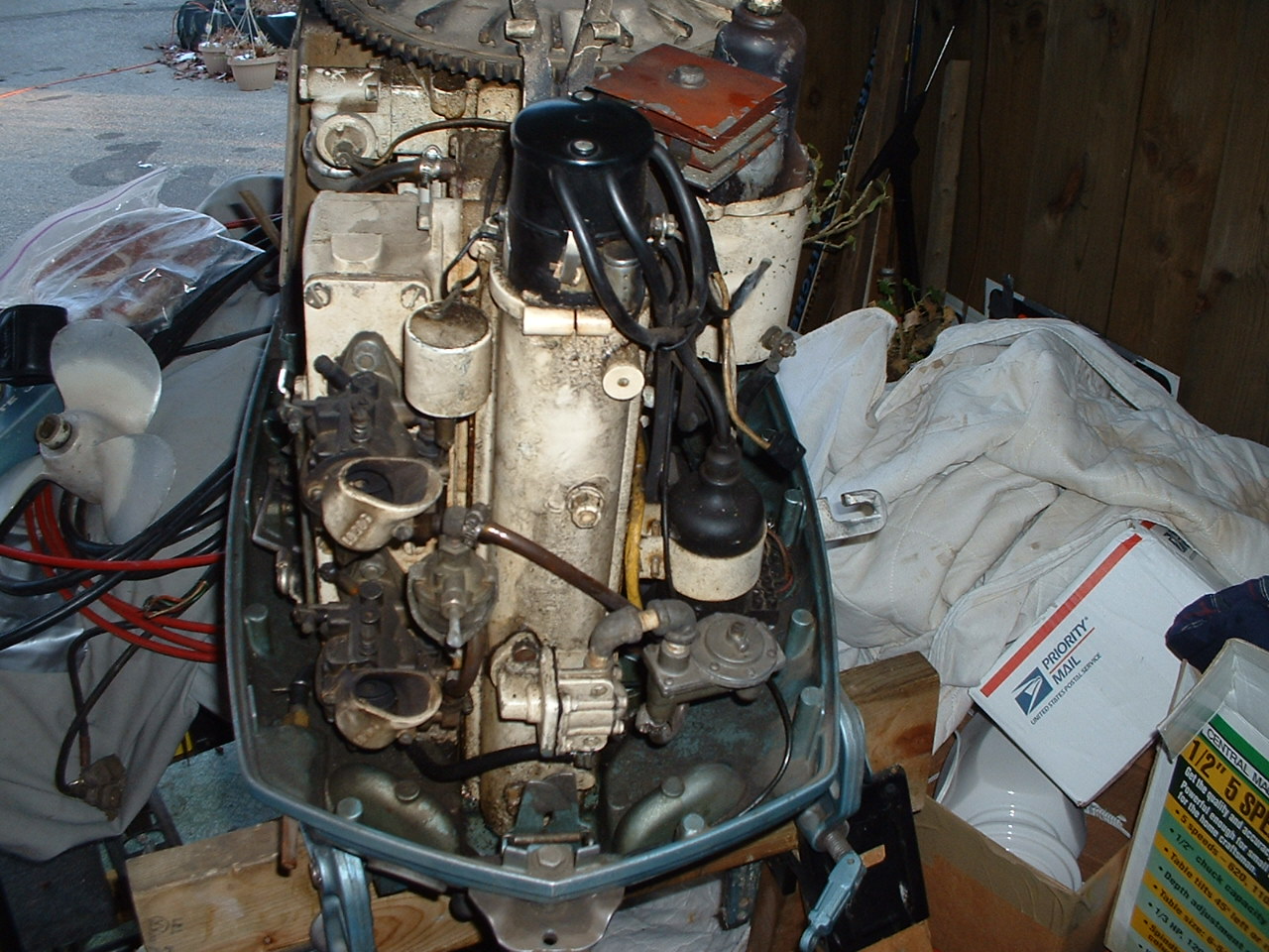

What is that thing attached to my fuel pump? Some sort of fuel pressure regulator? Do any of you guys have one on your Homelite/Bearcat? I never fooled with it. I don't think I will either. Wonder if it was something the past owner put on? :unsure:
Re:Winter projects Homelite/Bearcats ? 15 years 10 months ago #22438
  • 4stroke
  • 4stroke's Avatar
  • Posts: 291
  • Karma: 16
Dave, never seen anything like that on any I have or have seen. You might be right it does look something like a regulator.

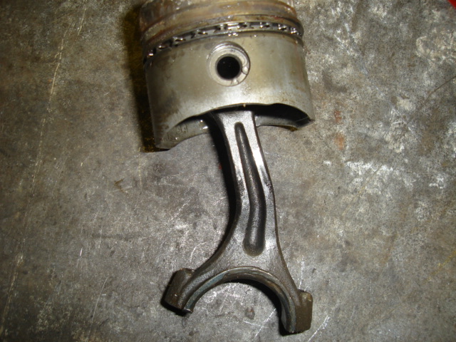

Continuing on with more projects, looking to see what I've bought. Torn down two stuck powerheads. These little suckers sure do come apart quickly. Both blocks look salvageable, light rust in the cylinders. One bad crank and rod. Put a rod bolt into my slide hammer, screwed it into the rod, a few taps and the pistons came right out. Cams look good. Should be able to build one decent "A" block engine out of these two. Third powerhead turns but appears to have a bad intake valve in #1. Check out the hand controls and the tilt/trim. Very strange, looks like it may even had a tiller mounted to it too!

Dick, that rod just don't look right. :laugh:
