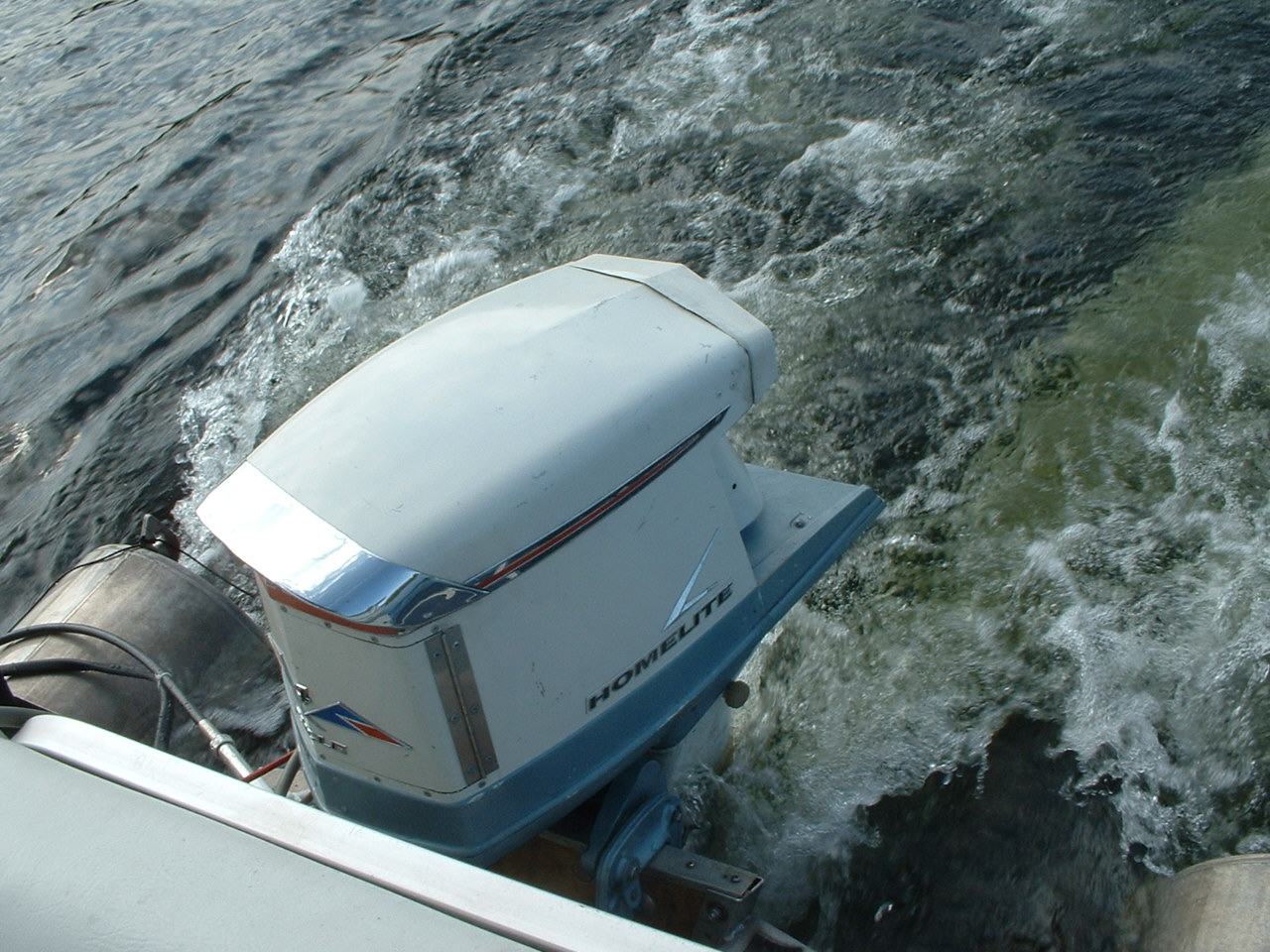

I have a PS71 PS75.
I also have the 4 blade AMC712 I got from Bill R. I normally use the 9" pitch 3 blade on my pontoon. But If I know it will be loaded down a lot with passengers I will put the 4 blade 8" on. The 9" (PS75)does a fine job for me with just a few passengers. Gives me a little better economy because I cruise at low speeds on the 21' pontoon. But will get up to the R"s when needed. About a 1000 RPMs when I'm just cruise around slowly. Going to install a tach on her this spring.
I put the 12" on it was bogging down too much Lugging. I took it off and put the 9" back on. B)
