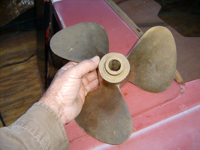

I ran a 55 on a 18' tri hull in Venice fl for several years,mainly fishing from lemon bay to the jetties, I could fish all night on a 6 gal tank without any problem.....well unless a storm would come in late. It wasent very fast to say the least. Anyway about the prop situation, I found that the scott McCulloch 60-75hp prop and nut will fit,and come in 11-16p 2 and 3 blade, mich wheel# ajc120-126, oakland johnson also made many to fit.
