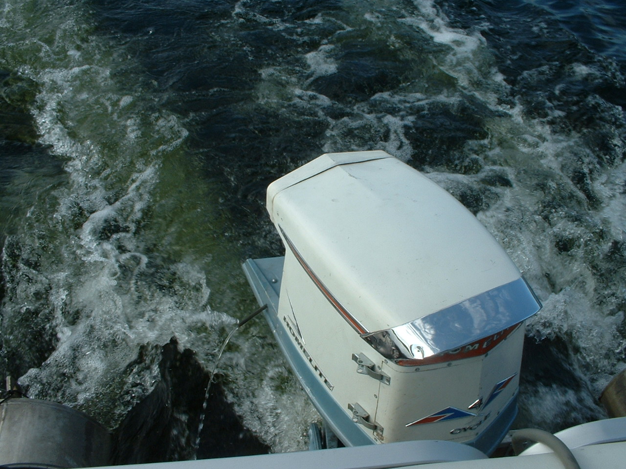

I finally got a photo of where my filter would go.
That clamp idea sounds like a good one.

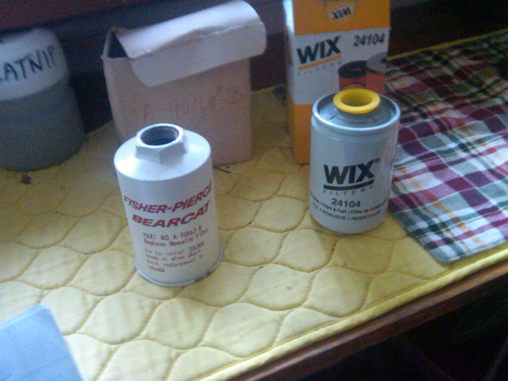

here's the factory filter vs a 24104, both new in the box.

Do you have any stock on those Bill, (for the guys who need 'em), or is that just one you have left over? With the tightening issue they're talking about, you can sure understand the O.E. having the "nut" in the housing - would make life easier.
Re:Should I add an oil filter? 15 years 11 months ago #20576
  • billr
  • billr's Avatar
  • Posts: 623
  • Karma: 51
Hi Mark,
The guys that do the museum quality restorations get the originals.
Truth be told, the 4104/24104 is fine, just use a large set of channel locks to tighten them. Both Scott Stewart and myself have been running them since 1997 (way longer for him!) and have had zero trouble.
The factory changed to the cap from the filter for a couple of reasons, but one of them was cost cutting per an internal document.
So my recommendation for everyone is run a filter even if your engine had a cap, and the wix 24104 is the right one.
Funny, just two weeks ago I had a customer take those numbers to the auto parts store and the computer showed this to be an air filter, and the box was stamped 24104 with an air filter inside acc to my customer! Anyway, we got him fixed up, and that's why I took this pic so he could run it into his parts guy.
