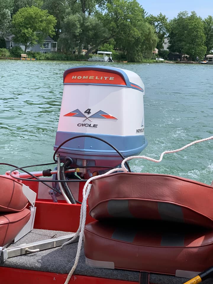

I would like to convert my 1963 short shaft Homelite to Pertronix ignition. Others may have done this already. Could anybody help me out with part numbers?

Got my answer from a very reliable source (Bill Roberts). Pertronix Part #1545. I have not installed yet but sure it will work.

Got it installed and it works perfectly! Was all set to have to reset the timing. The motor started right up, idled smoothly as could be. Checked timing and it was perfect at 8* BTDC. Thank you Bill!

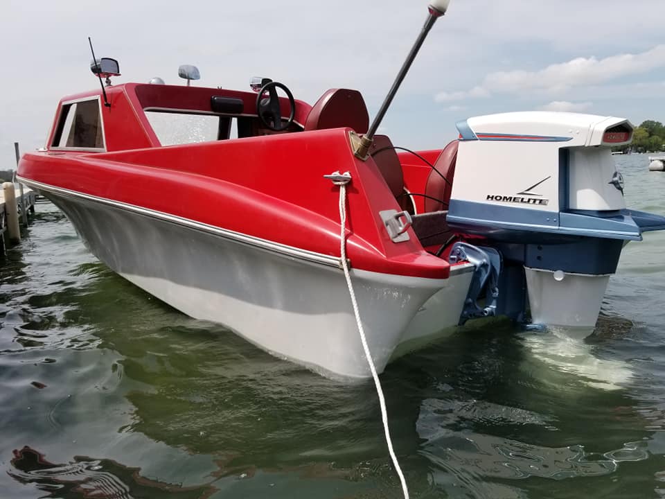

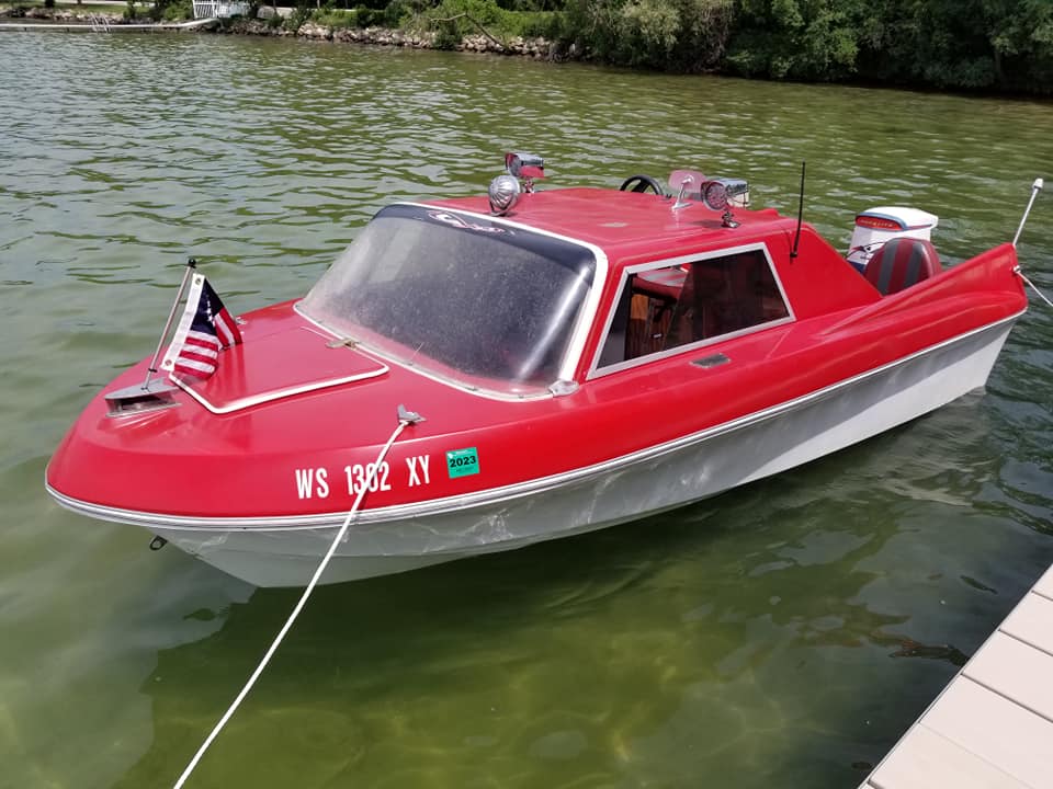

I have to comment that I love that boat and motor combo. I wish you the best at keeping it running and out on the water!

I used the original coil that was installed on the motor when it was new in 1963. That coil has a rounded top and is about 5" +/- tall. To restate after instalation the motor started and ran great without having to retime.
