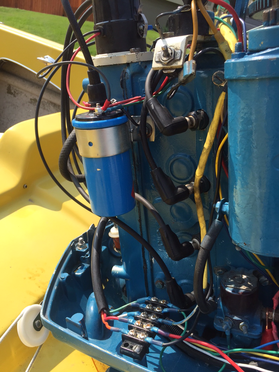

Have been gradually cleaning up the wiring and details on my Homelite. Here's some info that may prove useful for others:
Cap: Standard Motor Products AL137
Cap Lid: Standard Motor Products AL136
Rotor: AL102
Coil: Bosch Blue 00012 (3.0 ohm coil run without resistor wire)
Wires: Solid Core Universal Products R1814 (kit for 6 cylinder tractor)
All these items were in stock by Amazon Sellers.
The motor was already equipped with a Pertronix kit. After adding the high output coil and new tune up parts, I widened the gap on the plugs from .25 to .45. These upgrades were good for a 400 rpm increase at wot.

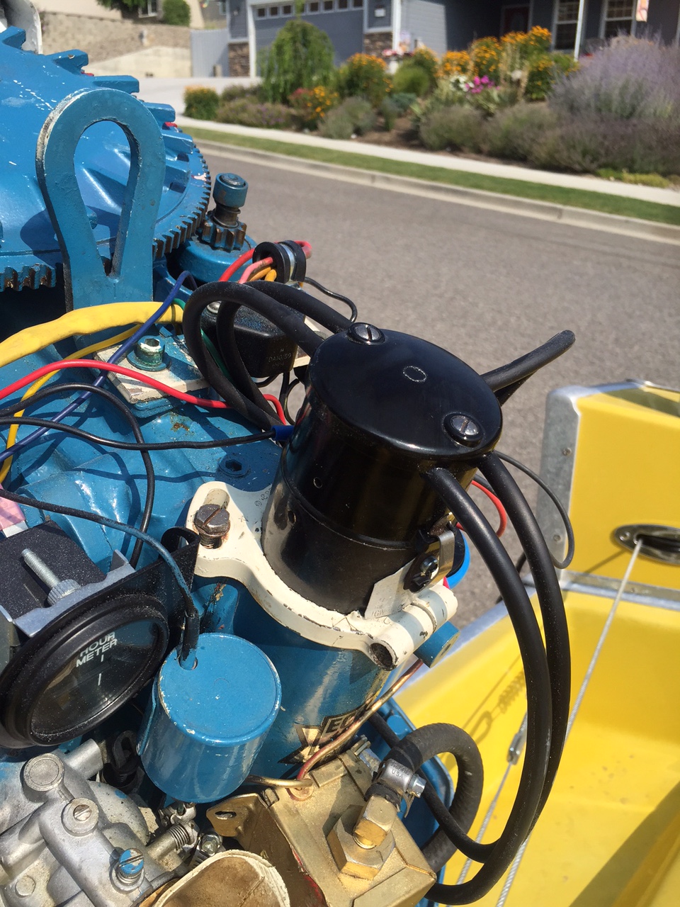

I also figured out a good way to set the timing... essentially ignore the book, go out on the water with the cover off, loosen the clamp that holds the distributor housing, loosen the two bolts that hold the housing to the head. Have someone pilot the boat at wot, while you rotate the distributor housing to find the maximum rpm. If the rpm drops, you went the wrong way, or went too far.
When I found that sweet spot, it was also good for several hundred rpm, and I had to back off the idle some.
