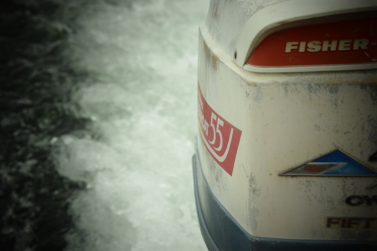

So yesterday we had a little boat outing in the Puget Sound. Long story short, I made it 5 miles out and suddenly got a flickering to steady red light on the controls and then the horn. I backed off the throttle and looked back to see normal water pump pressure and didn't hear anything unusual and quickly shut her down.
I was running around 20 knots, so not quite WOT but close. I pulled the cowling and did a visual inspection, nothing unusual. I looked for any obstruction/debris, nothing. I decided to gamble and start it up. It idled fine and pumped water fine. It didn't seem hot. I decided to float about for about 20-30 mins to let things "cool" down if it was in fact hot.
I checked the oil and nothing came up on the dipstick :(
I hadn't noticed any leaking and there was no sign off oil out of the exhaust. So after letting it sit I checked again, nothing but residual. So I added a quart and checked it again, this time it showed. So maybe I was about a quart low. Ok.
Started up, no problems except I still had the red light. I decided to limp back to the marina.
When I got home I drained the oil and put fresh oil in. I looked over everything and nothing jumped out at me saying "I'm the problem!"
I admit, I'm not an engine guy. I can do the routine tune up stuff but after that...nope. Unfortunately a great engine mechanic and friend of mine that worked on this F Block passed away earlier this year. He is missed for sure.
Thoughts?
