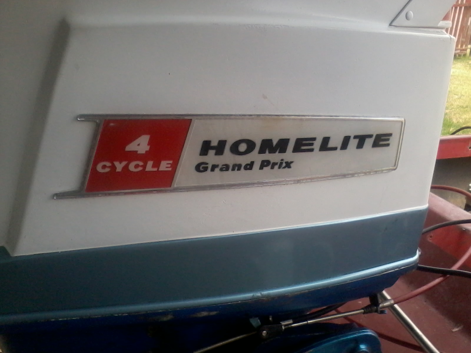

Good day. Im new here, and I stay in South Africa. I have a Sportsman cabin, with a 30hp Johnson, and I recently bought a Cameo ski boat, and with it came two Homelite 55hp motors. The one is a 62 model and the other is a 63 model, one long shaft and one short shaft, and also every single replacement part, and covers imported from Homelite N.Y. Dont know if they even exist anymore. I also have the manufacturing and service manuall for these motors. My boat can only take one motor, so the other one will be scraped. I havnt started with the rebuild, but I have started the better looking one. It runs fine, waterpump works, oil pump works. The motor smokes alot, and there is oil coming from the exhaust outlet. Does this mean that the oil rings are fried/broken? Any input will be appreciated.
