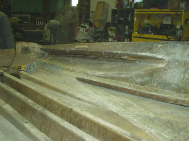

Carl, Wet or dry you will want to remove all rotten and questionable wood.
1st remove the deck. Use an 1/8 drill bit to remove the pop rivets in the
aluminum rub rail. The factory rivets are 1/8 inch in the U.S. They are probably
a metric equivalent for your boat. Remove the aluminum rub rail with the
deck. measure the girth or distance between the rub rails that are still on the deck.
Cut two pieces of wood 2 X 2 or 1 X 2 to that distance and mount them on the hull to help keep the hull from separating.

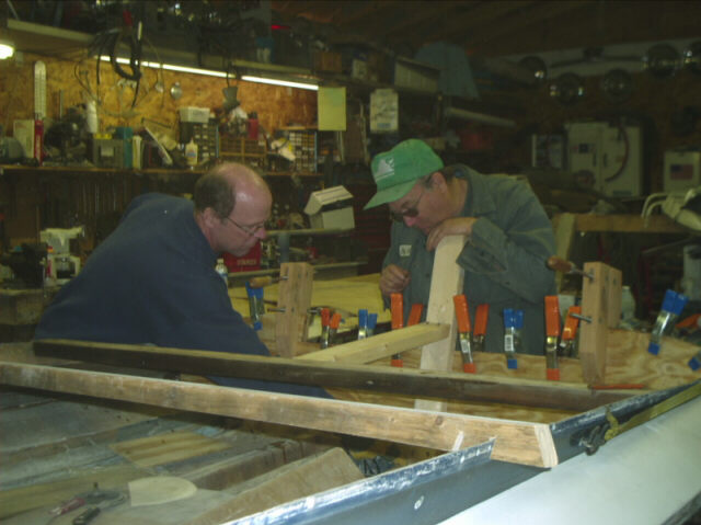

You are correct the term over here is Transom. Always tackle the transom
first. In this picture you can see Mike and I working on my transom. please note the notched 2x2 used to hold the edge of the hull. you can also see the 2x4 we used to help pitch the 15 degree angle for the transom.
When you do the transom please remember that the sponsons are part of the original transom.

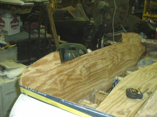

In the picture above you will see the first board in place. Many people have not removed the sponson covers and cleaned out this area. This area is prone to fail if not dealt with during restoration. Inside the sponson is a piece of 5/4 wood used to reinfore the sponson and it is tied to the transom for strength. When the boat is in the water this area at the transom is submerged and in peril of taking in water if not restored properly when the transom is done. Have you reviewed the resources over at g3owners.com?
