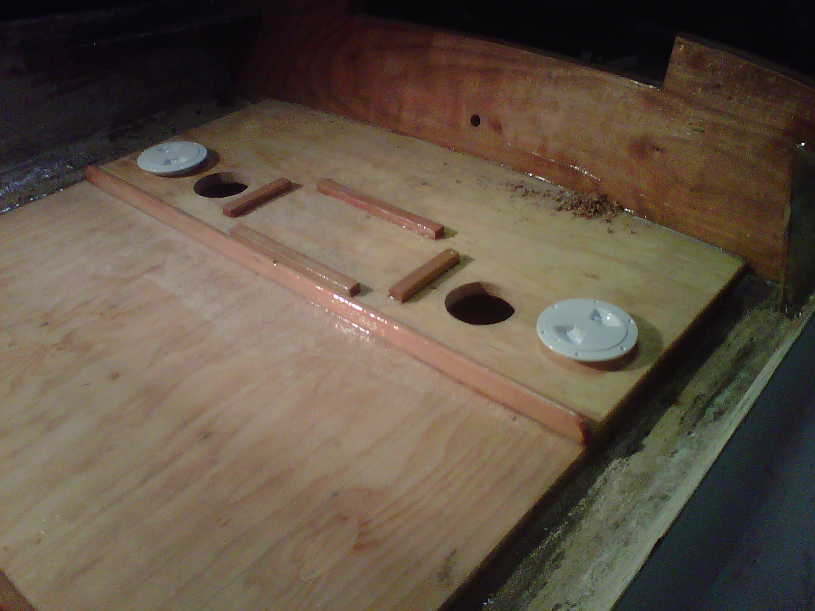

Re:G-3 stringers repair; spruce,stick fir or plywood 12 years 9 months ago #88712
Because the stock stringers butt-to the transom... just makes it easier to locate them properly
As with SteveK, I replaced the stock transom's four 3/8" plywood layers with five, to make a stronger transom.
I also added another layer of 3/4" plywood over the 1/4" plywood floor, just under the splash well area... and fiberglassed that to the transom making a very stiff structure. And I also glassed in corner gussets between the transom and sides of the boat, because I am not very keen on the fact that the G3 deck is not tied to the transom anywhere.
There are lots of ways to build additional strength into a G3 transom, this is just what I did, because I wanted to never worry about any motor I might hang off the back.
