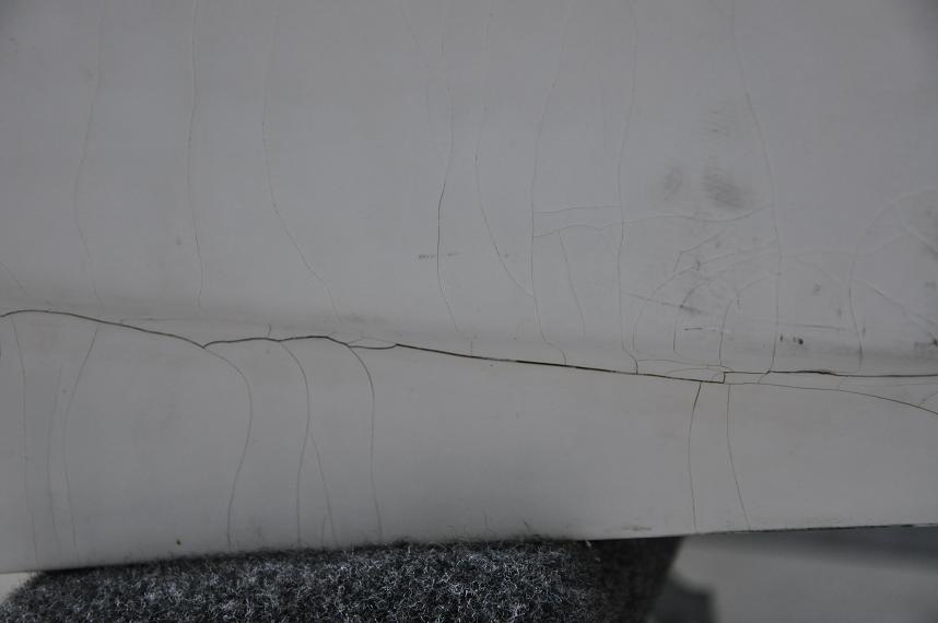

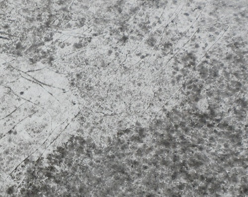

My boat needs a new transom, new floor, and new stringers. In other words a lot of work.
While the fiberglass is very straight, the deck, at least, has many spider cracks.
Your thoughts on how to address this issue, please.

Re:How fix crazing, weather caused, or spider cracks? 12 years 9 months ago #88412
Chris:
As I had said in one of your other threads on your G-3, all G-3's
have the "stress cracks" you have. The G-3's that have sat out in the weather seem alot worse to me. I would realy concentrate on getting the stringers, the floor and transom taken care of first.
Those "stress cracks" have to be thoroughly sanded down a pretty long way. We had some bad ones on our Seafair and a couple of them were very hard to fix. After the cracks are thoroughly sanded, we had to then "build up" over the cracks using a product called
"Fiberfill" by Evercoat. I have seen some of the cracks repaired using fiberglass resin and mat too. Having gone through it on our Seafair I can tell you it is a long process.

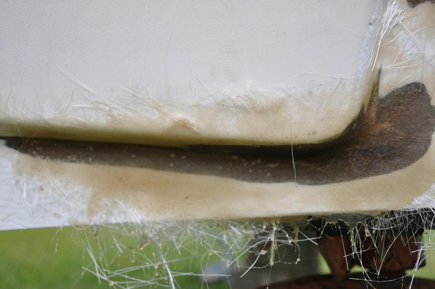

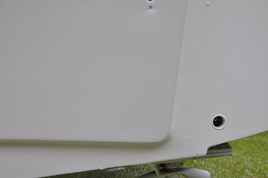

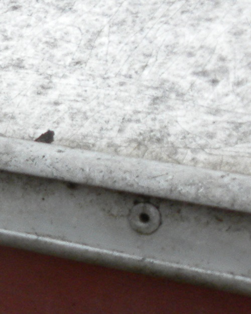

This product is made by "Evercoat" and is called "Fiberfill." To give you an idea of what some of the "spider cracks" and regular cracks looked like on our Seafair Sedan, here are some BEFORE and AFTER photos of the work we did on one area on the transom:
The first picture shows you a long crack on the lower right edge of the transom with the associated "spider cracks" above it. That long crack was DEEP and we had to sand down a long way to get all of it.
This second photo shows what the area looked like after we sanded, filled the area with the "Fiberfill" and then went over it with some fiberglass. For your information, we used "Dewalt"
Grinders along with air powered grinding tools to get the crack ground down using 80 grit paper and working up from there.
The area required more "buildup" than we thought, so we had to do a few "stages" with the fiberglass. In this third photo, you will see that the deep crack and the associated "spider cracks" above it are gone. We then used gelcoat to get a good surface for the final stages of repair. You don't have to use gelcoat Chris, you can also sand the areas smooth and then paint with a good marine product. I like "Awl Grip" and believe that is what Dean used on his 1959 G-3.
