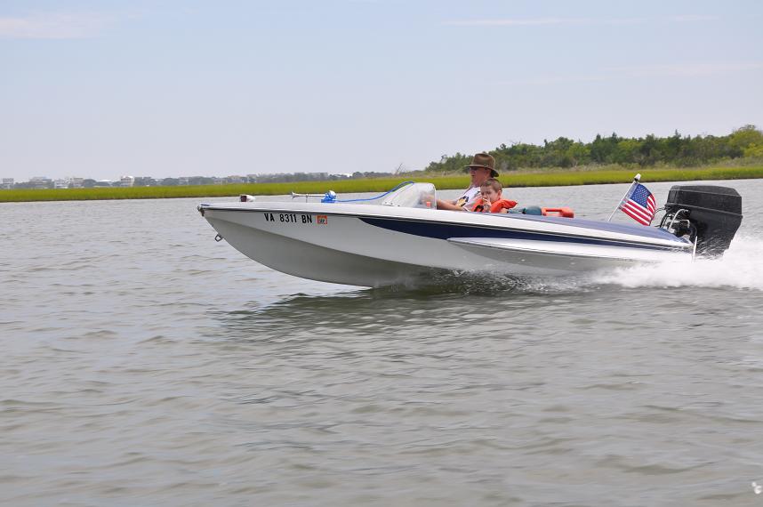

I would add that the inside hull of your G-3 should not be getting any water in it. We have a 1960 G-3 and after a long day on the water we see no water at all in ours. I have posted a picture
for you of our G-3.
