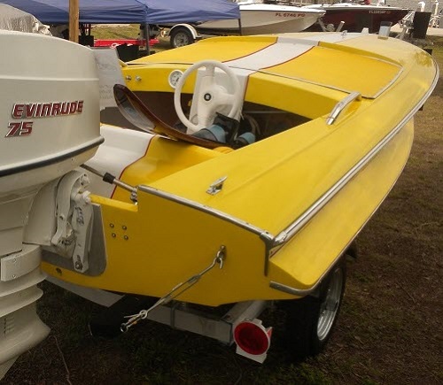

moving weight aft G 3 13 years 4 months ago #79747
Neat boat
Re:moving weight aft G 3 13 years 4 months ago #79748
1960 G 3 Glasspar

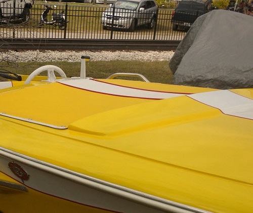

Re:moving weight aft G 3 13 years 4 months ago #79751
1960 g 3 center deck
Re:moving weight aft G 3 13 years 4 months ago #79752
Center deck
Re:moving weight aft G 3 13 years 4 months ago #79753
The forward cockpit was covered with a canvas and the steering was was moved aft and mounted to the center deck.
Re:moving weight aft G 3 13 years 4 months ago #79835
Yeah Chris,...I have seen a couple of center deck G-3's rigged like that.
I am curious,....where was that picture taken at?
Re:moving weight aft G 3 13 years 4 months ago #79853
Mount Dora, FL
Re:moving weight aft G 3 13 years 4 months ago #79854
That is a 75 engine, right?
Re:moving weight aft G 3 13 years 4 months ago #79858
Yup, a 75.

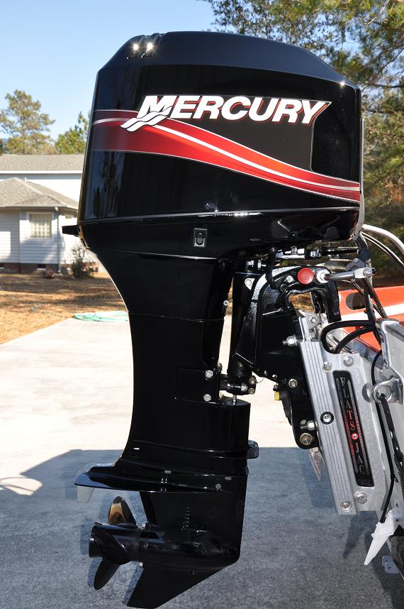

I have a 1960 G-3 with a similar outboard to yours (2009 Mercury 50)
and occasionally the boat will start to propoise at which time I can "adjust" it out with my trim and tilt or by raising or lowering the jackplate. I am wondering if the added weight of your new motor is causing the porpoising?? I have also read that the G-3's will do that if there is an imperfection on the bottom of the boat near the transom. As I recall it is called "hook" or soemthing like that? I am sure the other members will chime in on this for you.
Here is a picture of the set-up on our G-3:
