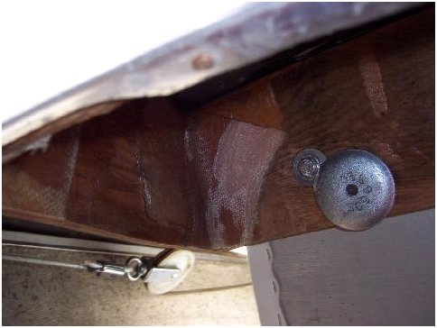

..OC,: CONGRATS & Welcome.. My prior thread of 59 G-3 Farm Find is lower in this forum on page THREE www.fiberglassics.com/fiberglassics-forums/home/g3-owners-association/1959-farm-find-e-tenn . The pics are not viewable via a old Webshots acct.. I will attach another below.. I have since sold the hull to a newer member in north Georgia... I bleieve a true 59 are quite rare & fewer than 12 have been found... I also got a 73 Merc 500 with my package, which I have for future (?)
. MY factory serial # waas a ROUND sand DISC about 2 1/2 " in Diameter , UNDER the splashwell , Left PORT side ski / transom Bolt nut. A true 59 has Gold painted DECALS on the top rear sponson , if you still have outline (?) you do not say. Also interior Center POST , where your fire extinguiser mounter would have NO angle mounting holes from the GLASSPAR logo slant .(?)
..Your seats are very nice , that is a hard item .. Front grab bars & side Mediallions are the signature pieces, most of windshield are gone, & hull looks good with off. They can be pricy if new repro. guys have tried to get fabricated , but mold expensive , etc.. Can almost try bend Lexan if handy .. other posts hee on board, or via GLEN -L boat builders forum.

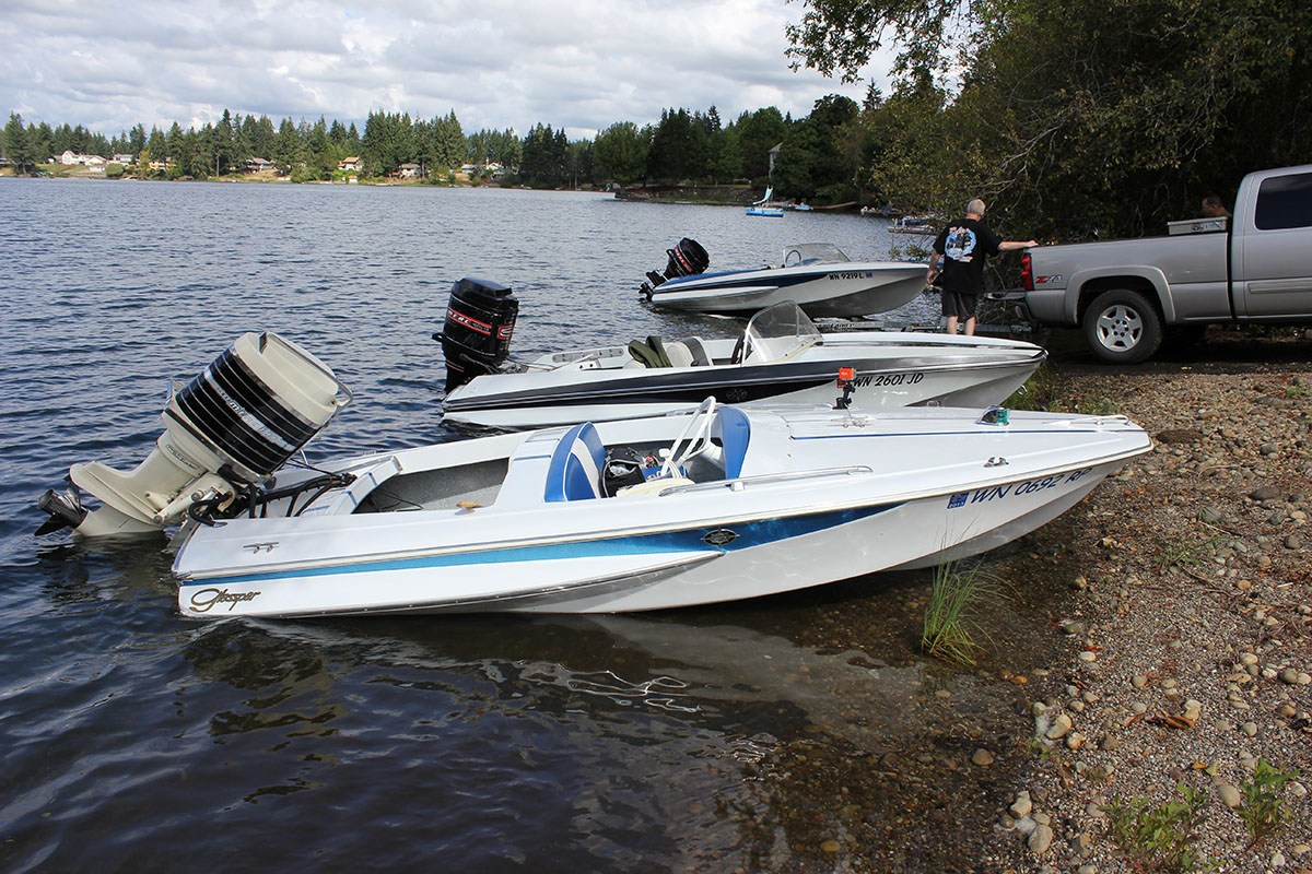

Welcome Ocboat!
I also have a '59... i bought it in Junction City, near Salem OR in late 2010. Took me 8 months to restore it. It was a fun project and even more fun to get it out on the water.
On the '59, your serial number should be a disc up under the center deck, right behind your drivers seat (port side).
www.fiberglassics.com/index.php?option=com_kunena&Itemid=62&func=view&catid=30&id=38446
Dean
Mine is the boat in the foreground

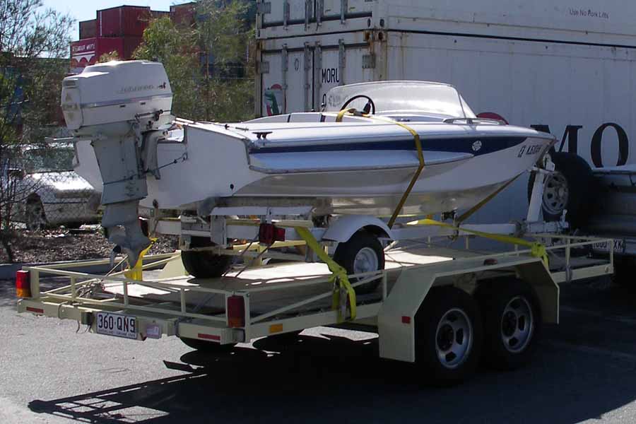

Another welcome, ocboat! – from the other side of the world.
You will love your G3, guaranteed!
My G3 is also a '59 manufacture and I bought it from the original owner in New Jersey. It was also used by his son and then grandson, and when the grandson developed other interests and it sat unused he sold it to me and I had it shipped over here. It spent 48 years at the same riverside address! I chose to keep steering on the port side, because that's how it was made.
I am aware of five G3s in Australia, all originally centredeck versions - one was converted to inboard and another had the centre deck removed. That one is now in my yard waiting for me to return it to original.
I have no trouble accessing the archived forum – I just opened it, quickly, without needing my password. The link given earlier is correct: forums.fiberglassics.com/g3/ and I use a Mac. Try keying in the address rather than clicking on the link or doing a copy/paste.
Pic is my G3 as I collected it from the shipping depot in 2007

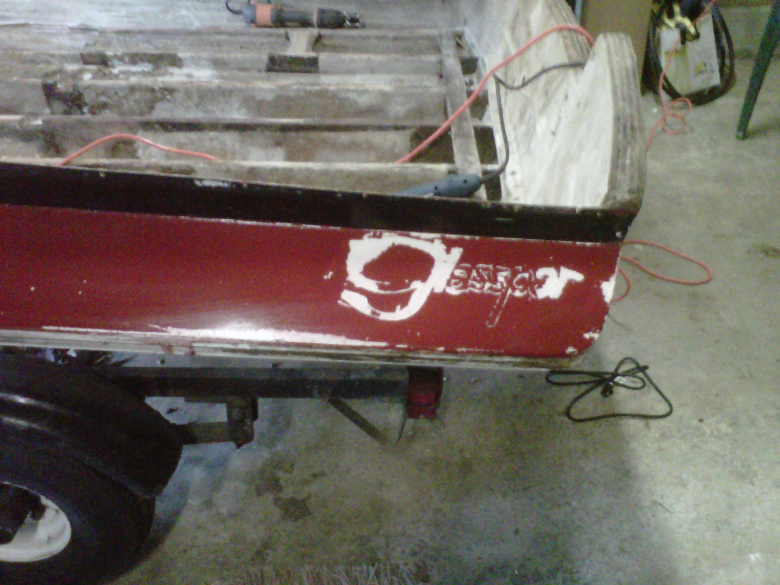

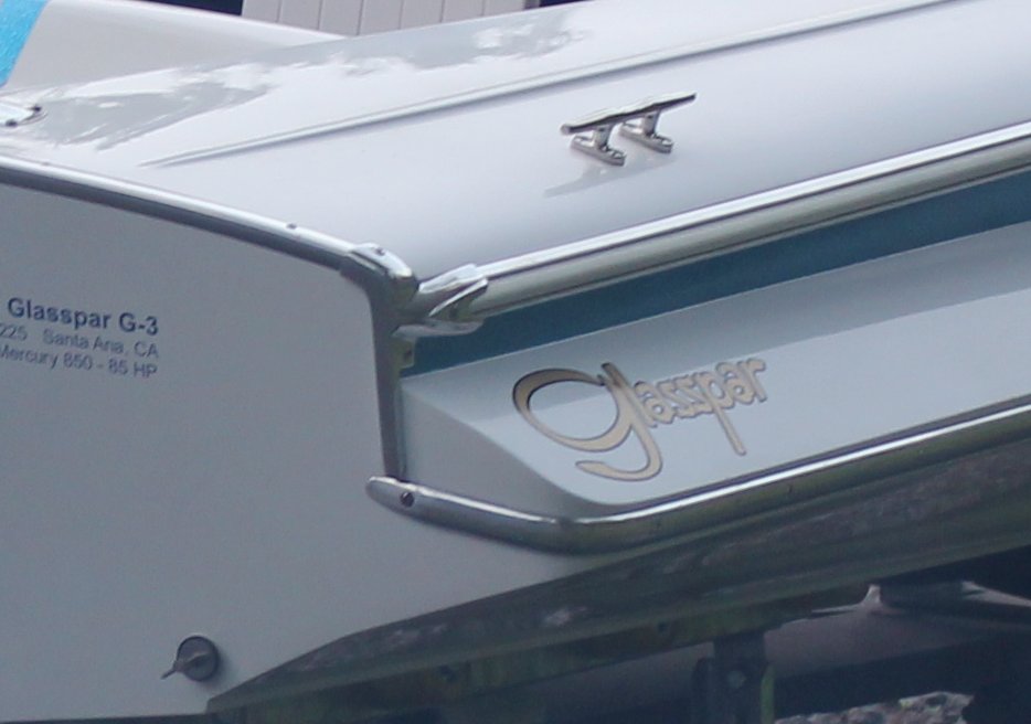

Re:New 1959 G3 Owner 13 years 8 months ago #74532
The question still remains... is it a 1960 model run or a 1959 model run. Like 1960RedG-3's boat... his is a 1960 model (even though bought in 1959). If your boat had the cast emblem on the center deck support, then its 1960 model. In 1959 they had decals on the sponsons:
I found the remnants of my decal under the red paint... I had no holes in my center deck support.
So with Ken's "Downunder" graphic file, I had proper decals made (I have a spare set if you need them):

Just as a matter of interest....
Seems that Glasspar various locations and years did different things in placing their HINs. G3Bill sent me this photo of the disk under the center deck. I found that while my disk was missing, there was evidence it had this disk. I did a thorough investigation with Oregon and Idaho marine licensing and found my title and original HIN numbers and origin. (My boat was originally titled in OR, later ID... then ended back in OR with its ID registration). Idaho also tracked down the last titled owner and strong-armed him to sign over the title to me, the guy I bought it from didnt have any title... it was good to talk to the previous owner)
I had seen a few 1960 models that had the HIN at the base of the center deck... Now OCboat has found an Olympia '59 with it in the same location... good to know.
Many had their HIN on the "Glasspar" die-cast plate on the port side of the fwd cockpit... this was the same type and location as my '59 Avalon. Just like John describes (1960RedG-3). I recall reading Split found his on the transom on a washer inboard of the transom eye(?).
Mine used the same scheme used on the above photo, HIN# G3A9225
• G3 = Model# G3
• A = Santa Anna, CA plant
• 9 = 1959 model year
• 225 = 225th hull of model year run produced
Later all the locations used the 13X designation... I understood that the first G3s were only produced in Santa Ana (home plant) plant... then they were rolled out to all the other locations. So OC's discovery is that '59s were also produced in at least Olympia WA's plant... but Olympia used the HIN scheme that ran on the rest of the G3's until 1965, when they switched to the "13G" scheme. G3Bill really follows this stuff, so maybe he has something to add.
:) Dean
