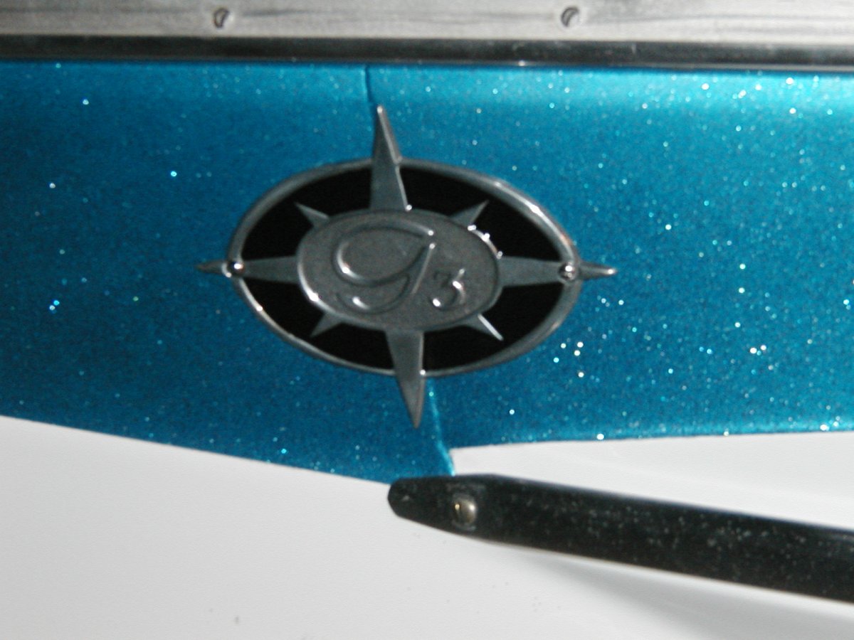

I did not get inside my sponsons when I did my restoration. The original construction of the sponson included the entire top of the sponson and upper gunwhale to be added after the boat came out of the mould. The vertical seam that you see at the front end of the sponson (runs right under the G3 emblem) is factory stock. Are you sure that previous restorer cut it there?
If it were me... I would cut out the interior plywood providing access to the inside of the sponson, make the new frame structures and sister them to the existing ones, and glass them up real well. Before i sistered anything, I would get the original ones very dry and then soak the old ones with thinned resin as to get it to soak in well... I would not cut the top off the sponsons!
Dean
Factory seam (under the emblem):
