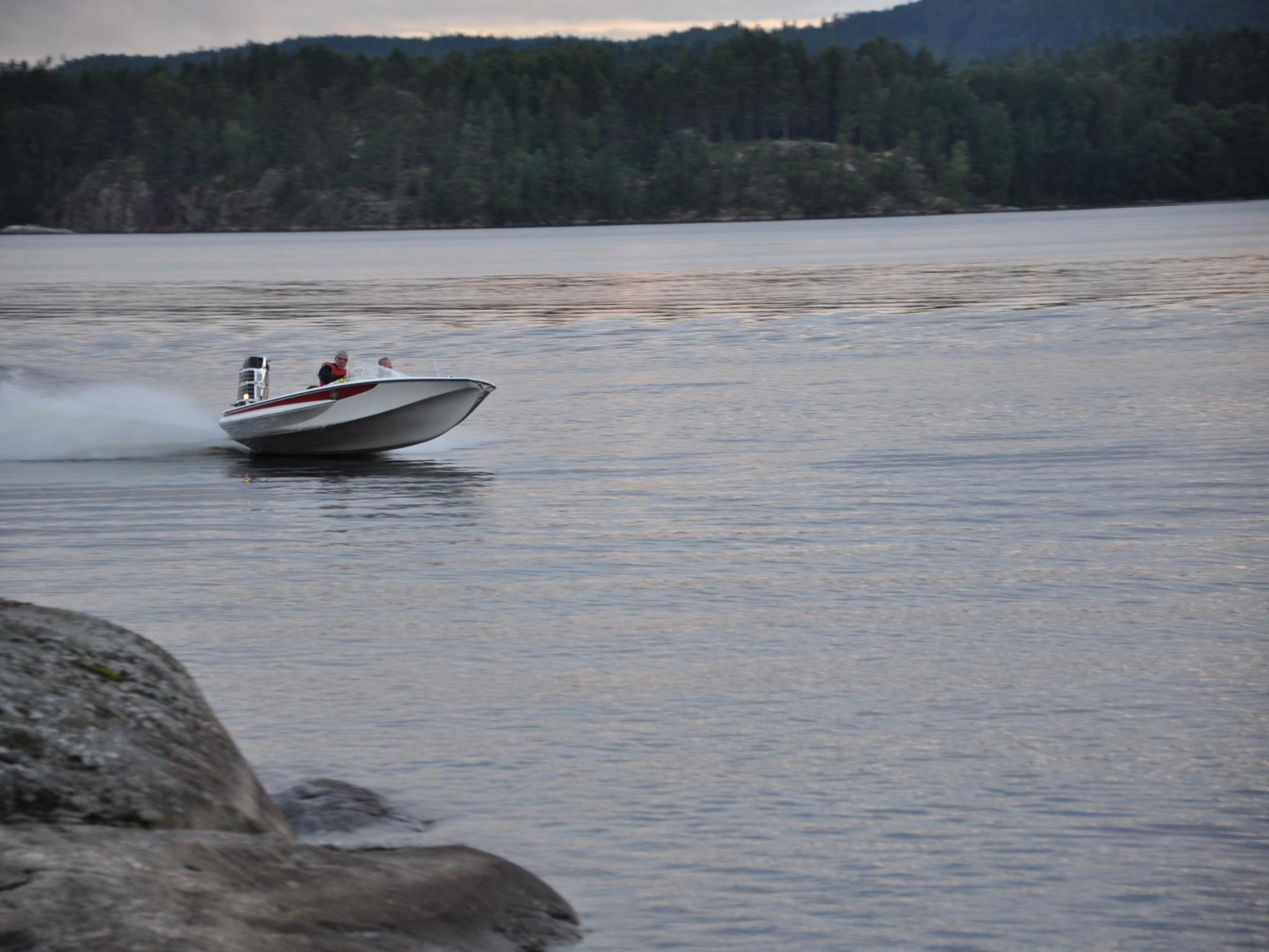

Hallo G3-friends over there!
My best run is 52,5 mph/ Merc 1000-63/5.800rpm/Prop 22"LaserII/CMC Power trim/Engine raised 2,5"
"Okie" in Sweden
Re:Speed 14 years 2 months ago #68280
Hello Ake, nice shot of your G3! I have several shots of your boat on my PC. Any other recent photos of your boat?
Dean :laugh:
Bandit - 1959 Glasspar G3
