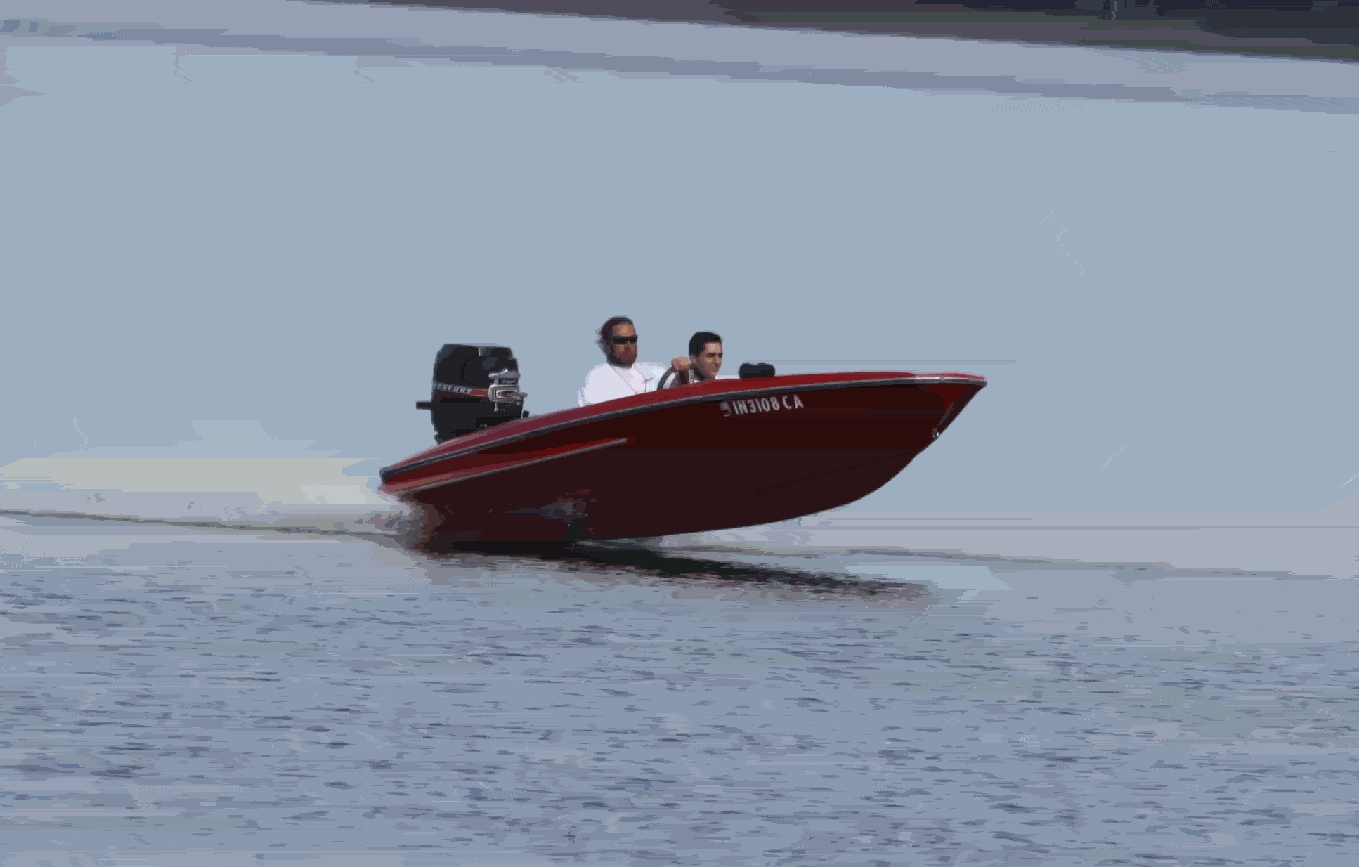

Last year's gas and a 190 lb passenger... hoooooRAW!
What's different? I raised the motor +2 more inches, cav plate to >4" above the transom bottom, new stainless steel 19P cupped prop, Merc 1000 carbs & exhaust plate. Gain of 5-6 mph with a passenger onboard.

Dean,..let me be the first to say CONGRATULATIONS on hitting the 50MPH barrier! ;) Good job buddy! I loved the last "swig" you took of the "Corona" before you nailed the throttle! :laugh:

Ok Guys weres a shot of the speedo or GPS showing How fast you say your goining. When it comes to speed we need some proof.
Nice G3 but don't know about that motor.

I know what 50 plus looks like and feels like and it looks it to me. Good go and I love the way that motor growls!! la cerveza mas fina!!

Looking Great Dean! Those grey days with a bit of wind and some good chop are GREAT for spd. My best in Reggie was an October morning, very cool and a steady wind going down the channel. In and out of the chop, Lets see some MORE!!!!!
And is that a gopro sport you using on the motor & dash?
