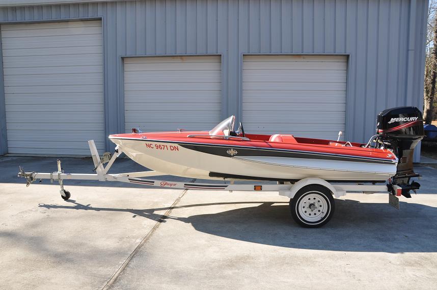

Here are some photos of how the boat looks with the Mercury 50 Dennis. As Dean said, with the longer lower unit, I installed a hydraulic jackplate and it has worked great! The Merc 50 weighs 204 pounds and the jackplate is about 28 lbs.
Re:Outboard recommendations / experience? 14 years 5 months ago #62307
Dennis,..here is a closer view of the motor and jackplate. I like the "Bob's Machine Hydraulic Jackplate" because it is pretty light and is only about 3 7/8" wide.
Re:Outboard recommendations / experience? 14 years 5 months ago #62308
Hey John! I've finally put 2 and 2 together! I've had this picture on my computer since before I restored my G3... I didnt know that was you and your G3. Really nice ride!
Dennis: One other note... you may already know this; but the vintage outboards (pre '85) were flywheel rated HP and the new motors are prop shaft rated HP. So a new 50 HP Merc is probably like an old 60-65 HP motor in terms of performance... and if it were me, I would try to go with a 2 stroke (they are all oil injected these days) as they have much more of a snap out of the hole.
Bandit - 1959 Glasspar G3
Re:Outboard recommendations / experience? 14 years 5 months ago #62310
Thanks Dean! ;) You have one heck of a nice G-3 yourself!
Yeah, Andrew Gott (Andgott) took that picture of our boat last year on the Tennessee River as I was passing behind them at a Glasspar Boat Event! The only thing that could have made it better was for me to have been wearing one of your nice "G-3 T-Shirts!" ;)

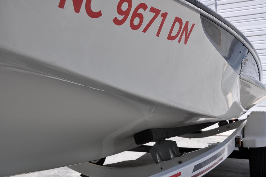

Here is a picture of our G-3 showing the bottom that was sanded and re-gelcoated with a spray gun by my vendor.
ONLY the white was redone (sanded down and re-gelcoated) as the black stripe and top red gelcoat deck were still in very good shape. Our white bottom was also in pretty good shape with only minor "stress cracks" and a few holes in the transom where THREE (3) outboard motors had been over the past fifty (50) years.
The work done on our G-3 did not cost $2,000.00, but from area to area there may be some variance in price. Your bottom may be in worse shape than ours was too. I know there are other G-3 owners that have "rolled" gelcoat on their boats. One thing I do know is regardless what you decide is in my opinion, gelcoat is TOUGH to work with if you haven't ever done it!
