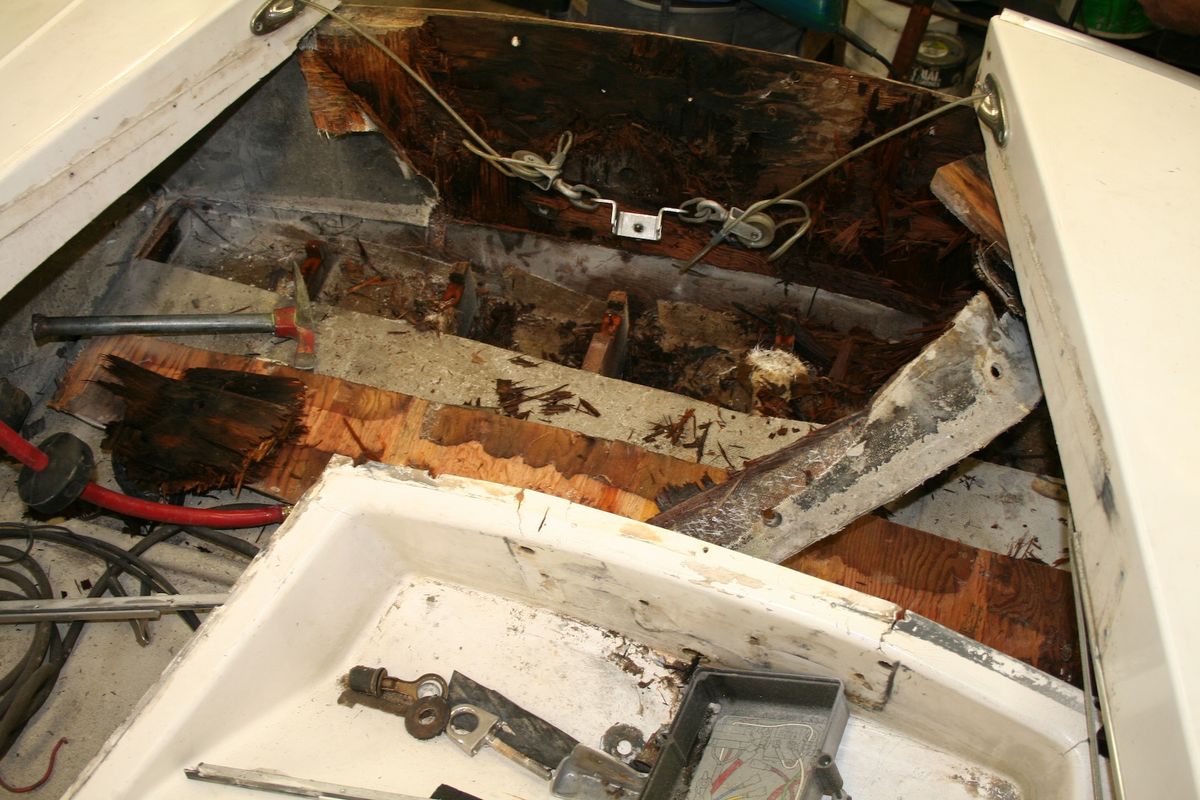

Nice boat. I love G-3s. I don't own one at the moment, though I just put a transom, stringers, and floor in one for a friend, which you can see on this thread-
www.fiberglassics.com/fiberglassics-forums/home/main-forum/glasspar-g-3-gets-a-new-transom
They are not only great looking boats, but also preform VERY well. I think you'll be happy with the 65 HP thats on there.
flashbk13 wrote:
The transom seems pretty solid. When I was trying to raise the motor back up, there was very little play on the transome, just enough to flex the stress cracks a little. It maybe ok?
There should be NO play or flex in the transom at all! Stress cracks are a sign of a structural problem. It's easy to check for rot from the inside, the 'glass skin is thin, and you can drill through it in a few spots to check the integrity. Glasspar didn't seal the top of the transom, and the wood gets wet, and tends to rot...
Unfortunately the stringers are the same way- as is the floor- the undersides are usually left bare...

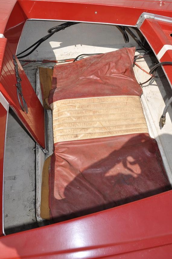

Rick,....here is a photo of the original rear seat pad that came with the boat at the time my Dad bought the G-3. This photo was taken right before the restoration was started.

Thank you for the pic. So I would guess that some owners say there was no pad there? Then what is that area for? As for your pad, do you just kneel on it or sit cross legged? I guess however you fit :)
Re:Hi all, new here, just bought a 1960 G3 :) 14 years 4 months ago #62086
I bought a 1960 G-3 NEW in 1960 and it did not have a pad or any type of seating in the rear.

I've noticed the red decked g3's are more custom as sold new. seats look thicker and contoured like a bucket seat. Wade and someone else had one alike? In the ad's they talk about two cusions placed under the center deck and were for floatation also Wondering how thick those cusions are in your boat? 1 1/2 perhaps?

The gelcoat tends to show stress cracks but usually the fiberglass is not affected from what i've seen on mine. Dont let anyone stand on the deck, as said above there very thin skined. The corners at the end of the dash and windshield are very weak, not supported well.
If a transom is real bad you can push the top of motor back and forth a bit to see if it flexes much as said above but also look at the bottom of the motor bracket to see if it flexes the fiberglass. I have one that the rot is way down there and the top of motor moves about 2-3" LOL,

You are welcome on the pictures Rick!
Yes, you are right, other G-3 Owners have told me that the rear pad was not ever offered on the G-3. That original pad you see in the picture came wrapped in a plastic bag much like the new car carpet mats do today.
That rear area was for passengers to sit in. Myself or members of our family just sit flat and lean against either of the gunwales.
As the other members stated, after 1961, Glasspar made the G-3's
"open decks" with no center partition and installed "back-to-back"
seating.
