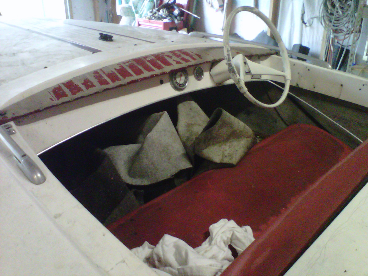

Does the original window have a frame? Or is it just the windshield itself that's screwed on?
I have nothing on my old boat...

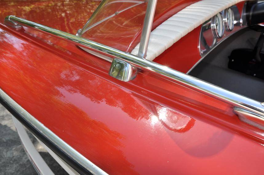

Dennis:
The original G-3 windshield on our 1960 did not have a frame. The top edge has a piece of aluminum trim and the bottom a white rubber gasket. The windshield has screws holding it at the bottom with wood supports underneath the top deck.
Here is a "side view" of the original windshield on our 1960 G-3:

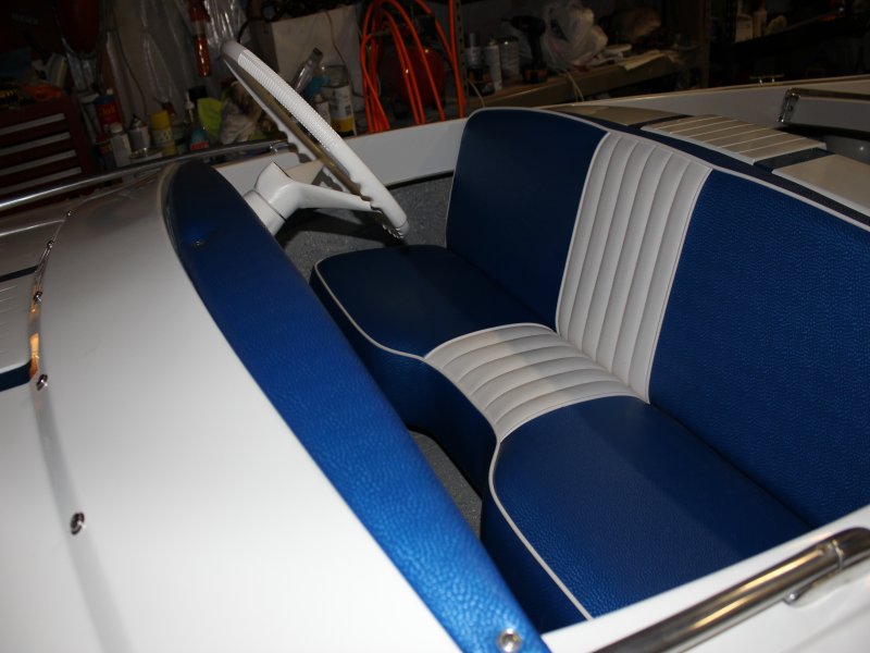

Looking at John's photo, it made me wonder if you have the dash pad? I have the original wood backing for the dash that I could trace and mail the pattern to you if you need it. It is made from 3/8" plywood. I see a lot of old boats with this missing.

Dean and Dennis:
That white dash pad on our G-3 is original to the boat!

I think that should work just fine for the curved shape of the forward edge... and the aft edge is simply straight. I am on a trip for work this week, but I can measure the center width of the plywood, then you can know the exact overhang. I think it was more than 1/2" overhang but I'm not exactly sure...
John,
YEAH that looked like the stock pad cover... except it appeared to be in too good of shape that I didn't expect it was original! WOW. Mine had the original pad too, but it didnt look anything like that...heh, it was pretty well rotted and somebody painted it red and there wasnt much left of the vinyl either:

Both the white and the red one look brand new from where sit (next to a still unpainted and empty hull)
It would be great to know how much the overhang should be in the middle and what the radius is more or less with which it curves back.

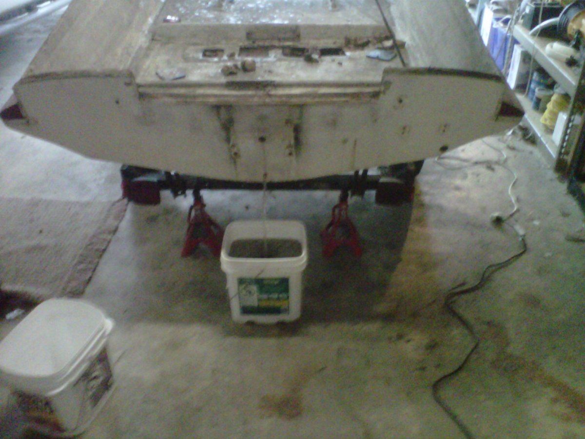

You got me thinking about your bent trailer from an overweight boat collecting 10 years of rain water. Did you find water under the floorboards? My G3 was totally full of water beneath the floor and the boat was heavier than heck. I had to drill a hole through the transom to drain it all out, as the drain plug in a 1959 only drains water above he floor.

Yes water throughout the boat
And not just water... Nasty rotten stuff with frogs included!
