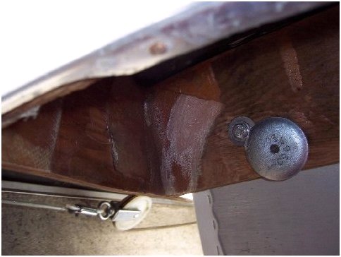

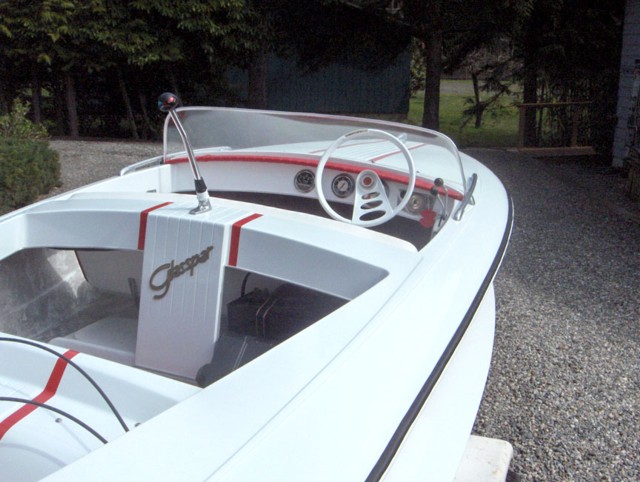

in 1959 there was no center deck support "Glasspar" logo, but there were sponson decals that said Glasspar; like my boat... see image. Also a 1959 did not have any foot support piece up under the deck... where the driver can hold himself into the seat. If you have this foot board up under the deck, you have a '60 or '61.
If you have a hull ID number that is very helpful... in '59 they have been found up under the center deck on the port side seat back bolt... I have also heard they have been on a tag attached to the port side transom eye bolt, up inside the boat. In 1960, I have seen them stamped into the bigger aluminum trim piece at the base of the center deck support. Other '60 abd '61 boats have them on a plate attached to the fwd-port cockpit side.
I think that in 1961, there was a recessed bilge drain area, under the splashwell in the center of the boat... this would collect water to be drained out the centerline drain hole. 1959 and 1960 had cockpit drain plugs on the stbd side.
1959 decal on sponson (no emblem on center deck support)
1960-61 center deck emblem (no decal on sponson)
1960-61 serial number plate on port side of cockpit
1959 serial number plate up under centerdeck

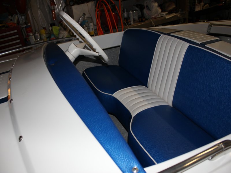

Here are some restoration photos of our 1960 G-3 with the upholstery work my friend and vendor did for me:
Re:windshield, bench/seats, bumber strip, logo's 14 years 4 months ago #62032
Dennis, this is what the seats looked like BEFORE the restoration:
Re:windshield, bench/seats, bumber strip, logo's 14 years 4 months ago #62033
Here is my friend and vendors information if you are interested in contacting him Dennis:
Tommie and Jessica Salter
"Salter Marine Upholstery and Canvas"
16,881 U.S. Highway 17
Hampstead, N.C. 28443
(910)231-2628
I don't know where you live Dennis, but Tommie and Jessica do great work as you can see and are very reasonable on their prices. I can give him my seat bottoms and backs for a pattern on yours if you want.

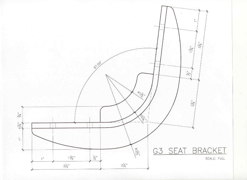

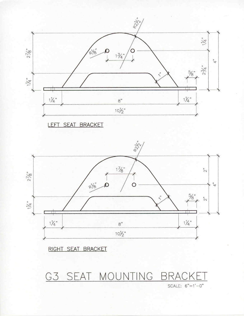

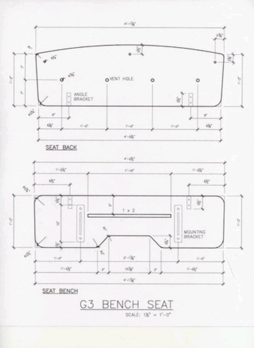

Here are some drawings that provide the dimensions/patterns for the bench seats:
Here are the brackets that hold the bench seat together:
And here are the brackets that screw to the bottom of the seat and are glassed
to the floor:
