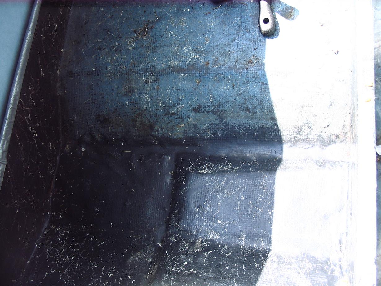

That's the question. What do you use to paint/coat the floor? What did the original 59 or so G3 floor look like? Can you use some kind of splatter paint?

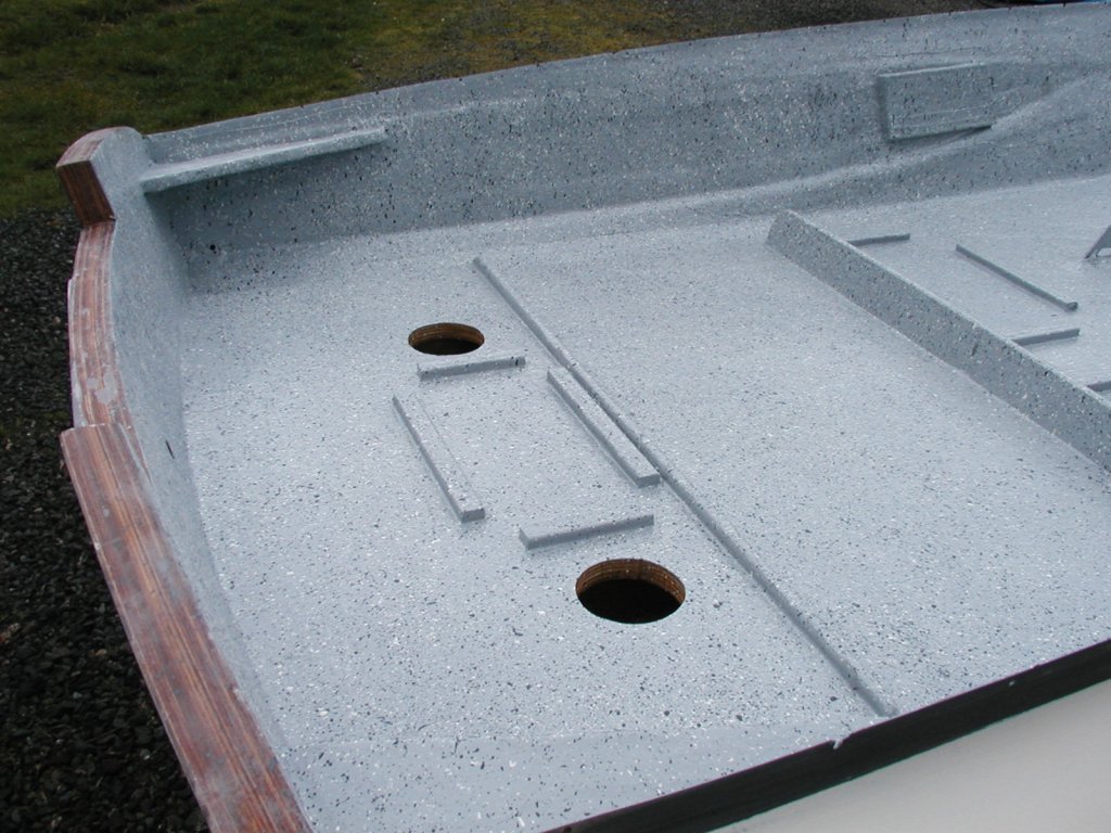

i bought splatter spray paint at home depot but they only had it in 3 colors. i purchased black and white. matched my floor perfect.
Re:And the floor is.... 14 years 5 months ago #61521
Original G-3s were painted with Gray Zolatone, as stated by Jim above.
Make the nice looking splatter with small can of black porch and deck paint, by dipping a pencil, or your finger, in it, and slinging it onto the gray paint!!!!!
Jim Savage
Re:And the floor is.... 14 years 5 months ago #61526
I used one-part polyurethane swimming pool paint. Bought a can of white and a can of black... then i mixed the gray from it.... after I rolled it on and it dried, I mixed up some dark gray and by tapping the paint brush on a stick, to splatter the color on it... did a second splattering with white... its the same process that Jim mentions, but I used a small brush instead of a pencil.
