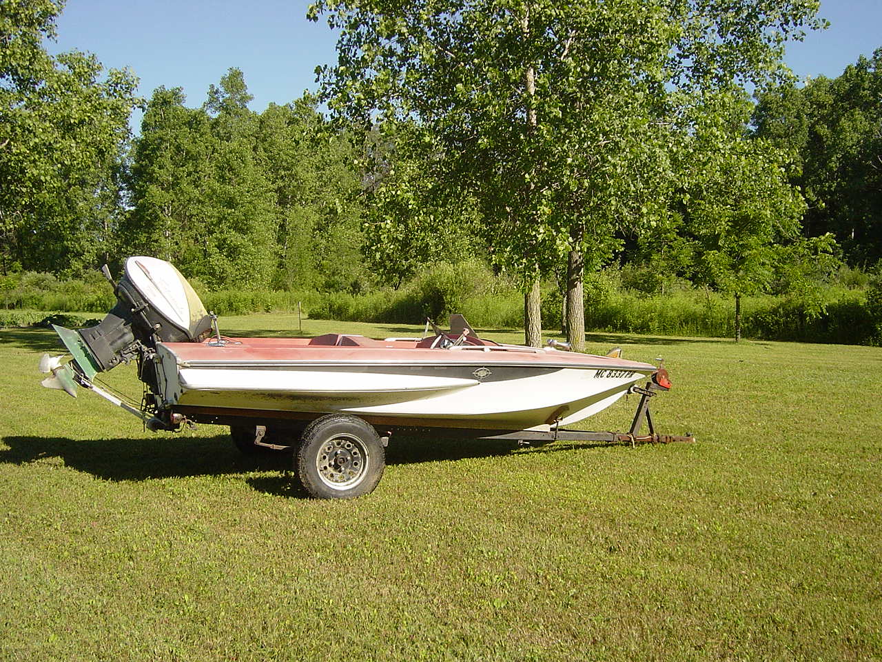

If you read this forum regularly, you'll know I don't know a lot about working with fiberglass. I'm to the point of removing the transom wood. I'm doing it from the inside so I can preserve the outter "skin". I've cut through the transom interior glass down each side and across the bottom using a 4.5" cutting wheel. However, the arc of the wheel edge is such that I can't make the cuts connect at the corners without cutting into either the side or bottom. Can I use a cold chisel to score then crack through to the wood or is there some other tool I should use? If so, what's it called.
I've had my boat for about two years. I have the hull cleaned out except for the transom. When I get that done, I'll be ready to start reglassing the hull and installing the new stringers and flooring. I've attached some pics of the boat and my progress.

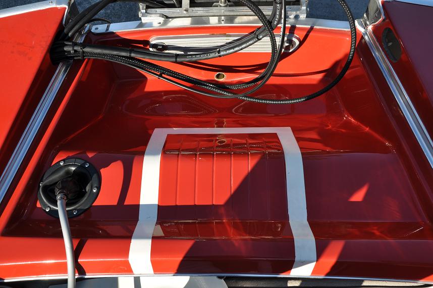

Larry, you mentioned that "piece of polished billet aluminum" across the top of the transom. I think I was the first one to do that. Here is a photo of our G-3 wih that modificaton:

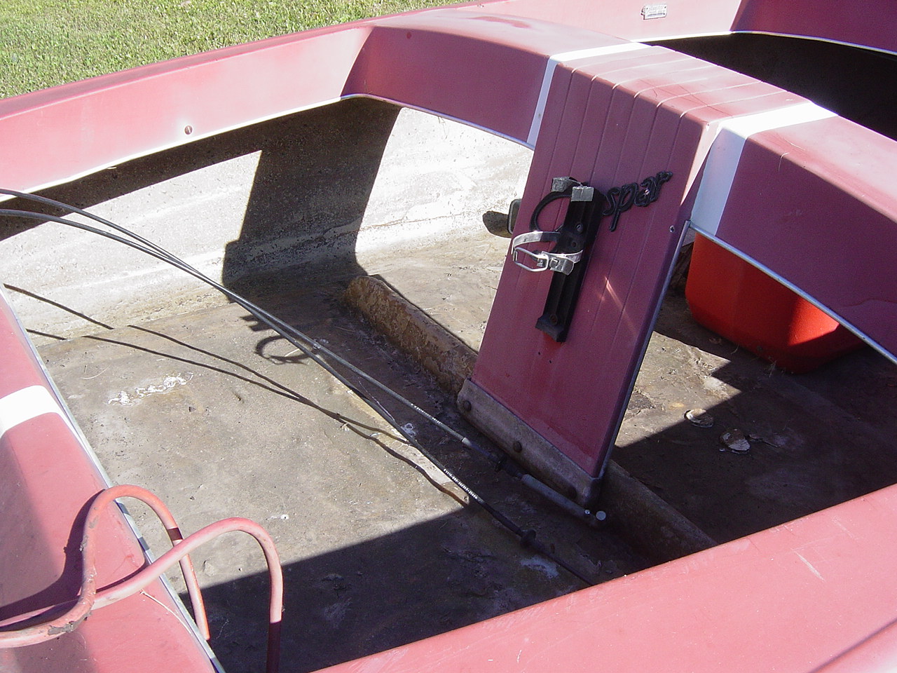

Here's a more recent pictures with the splash well out and one that shows the cuts I've made in the transom. I really didn't want to get into the sponsons, but the fact that each one has a hex-bolt driven from the outside and smeared with big gobs of silicon caulk tells me I'd better. Thanks for the info.

I have used one of the Harbor Freight reciprocating cutter multi-tools too. But, the glass really tears up the saw teeth. The diamond edged disk works fairly well, but I still have the problem of not quite being able to join the transom cuts. I think what I'll do is cut the interior transom glass skin into strips and see if it will pry off the wood. If not, I'll just have to grind/sand it off. Thanks for the suggestions.
