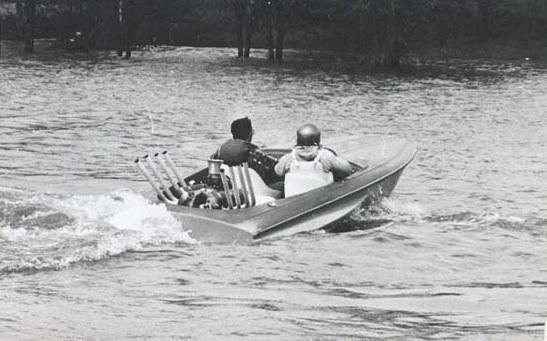

Re:Thinking about doing something different.... 14 years 6 months ago #60882
This might get you thinking
