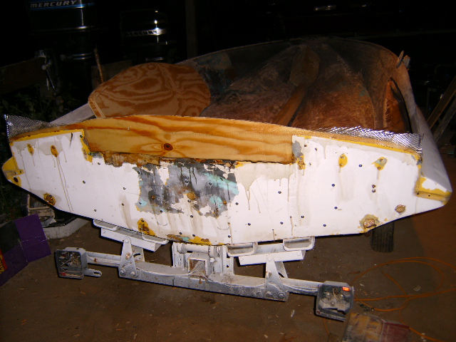

Heres some before and after pics my transom is curved..

YOu should not break the outer skin of the boat. Keep the hull integrity!! when mine was replaced they just loosened the top and sides at the transom and removed all of the old wood and placed new wood inside of the fiberglass. It was built up with several layers of 1/4 or 3/8 ply to get to the correct thickness. Be sure to put a plug in the bottom of the vee to allow any water to escape and to offer air transfer.

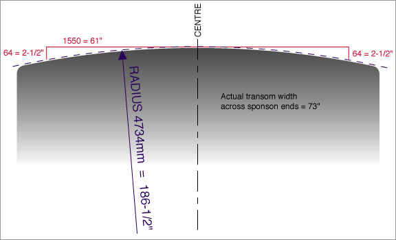

I have attached a transom curve template posted by someone in the past.
Thom
