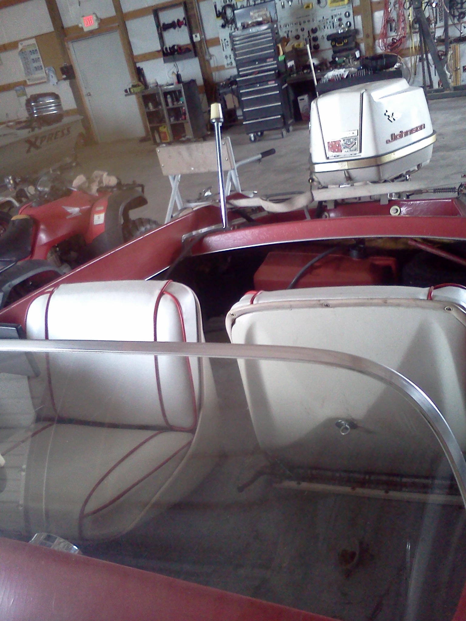

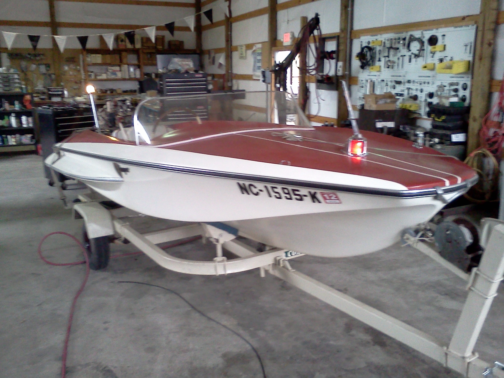

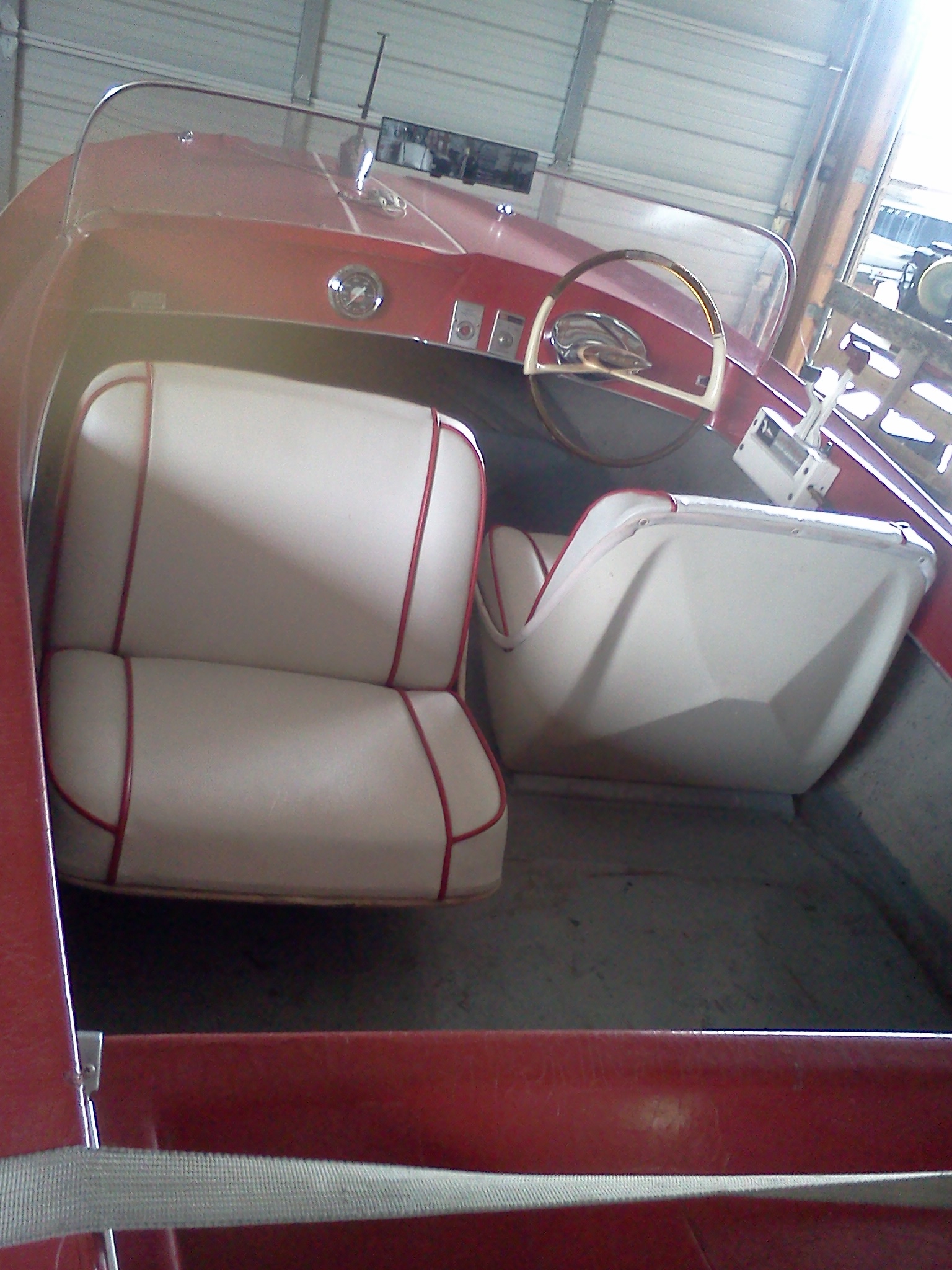

I am a boat dealer in S.C.(SINCE 1946)family owned/operated. Just bought an original rigged 62' G-3 62 75 Johnson, Cox Trailer that originated in Arden N.C. with owners manuals, This one is configured with 2 fiberglass seat shells/cushions, port seat has bronze release rack that rotates from front to rear to allow ski observer. I have traded some G-3'S in the past, but never one like this. the stern is open w/ storage beneath splashwell(for gas tank/batt. Can anyone enlighten me?

That looks to be the 1963 with the flip passenger ski seat. Flip it forward for cruising flip it rear facing to spot skiers.
Why can't I ever find them in this shape? Nice get for sure. Enjoy it greatly.

Thanks for your response. The mid decks were evidently the ones that I've traded. I was unaware that Glasspar built this open deck model. It is titled as a 62. Thank you.

..Bailey,,M.M.: GREAT Post / PICS. CONGRATS. Who ever let that gal get out of North Carolina. ?? We are over in Chattanooga , Tenn & have 3 centerdecks under restoration... Would like to talk more to ya, Had a small rally here last summer..
Yes in 62 - 67 the layout was open . Heard Glasspar made no units in 64 . Our Orlando member Gary S. has a LIght Blue with these ski , flip seats.. You may want to search your build code , small brass tag , as I think you have a unit built in MICHIGAN, company had a one year run ( 62 ) from that facility , I believe.? ...Some of the Speedsters we found have the " N " code for Nashville , with two as 59's . ONe Original Owner ,

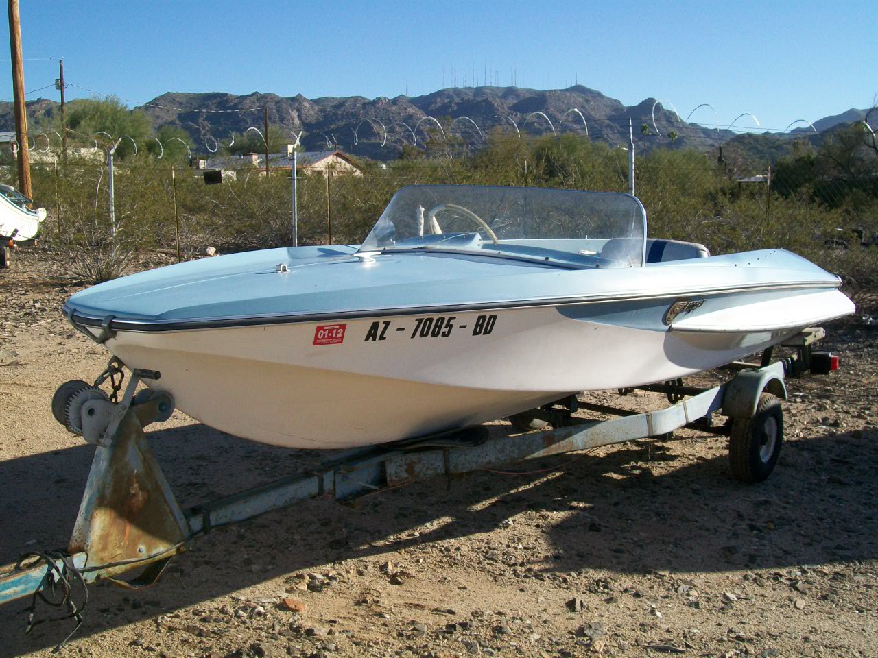

This G3 I recently got is the same configuration as Bailey's.Its got the flip flagman seat, but the drivers seat is missing.I'll be lucky to find that one. I thought mine was a 66.serial no. is 13xw2066.

nope 62/3 era with the flip seat. 66 they had the back to back lounge type seats

WOW, Bailey, that one is a BEAUTY!!!!! FYI, both the open and centerdeck models had "storage beneath the splashwell" so not sure what the G3's you had "traded in the past" were, but possibly modified by a previous owner?
LOVIN the JOHNSON 75 V4..... think thats the same engine Jim Savage used to HUMILIATE the Mercs with, back in his faster days..... HA! Also, I think the 62's were the first year Glasspar went to fiberglass stringers, so one less thing to be concerned about....

I restored a 62 so know the construction, and I have a few suggestions to keep yours healthy. As a side comment the seat covering is not quite to original, they have pleats in the center section, at least all the originals I have seen including mine was that way...that said the boat is BEAUTIFUL.
