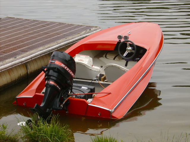

.."60".: I have owned TWO with the raised transom.. Here are some PICs for you . Orange was last March at boat show in Mt Dora, Fla.
This is a Gridley , Ill, special G-3 console mod , etc , LONG MERC,
. We had a small Glasspar rally last summer here in Chattanooga , Tenn ..These TWO G-3 had 50 hp on & at anchor , water level up to sponson ..! You can read down thru this forum for more pics in water. .

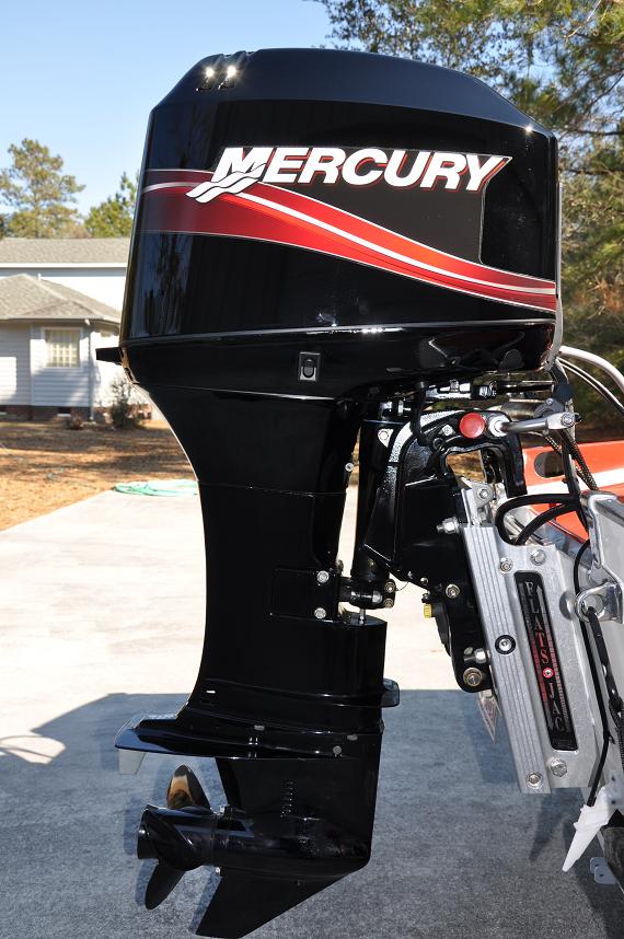

1960G3:
That 2009 Mercury 50 H.P. Two Stroke on my boat weighs 204 lbs.
Water does NOT come over the back of our boat when you slow down or completely chop the throttle. Like Dean, I prefer the look of the stock transom on the G-3, but as the members said, that is personal preference. I will try to get a picture up for you of how my engine is mounted on the boat Sir.

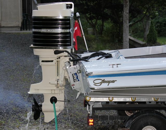

Here is a picture of how my motor is mounted on our G-3:
I mounted a "Bob's Machine Hydraulic Jackplate" on the transom and am really happy with it. I have the ability to raise or lower the motor while I am underway in the water.

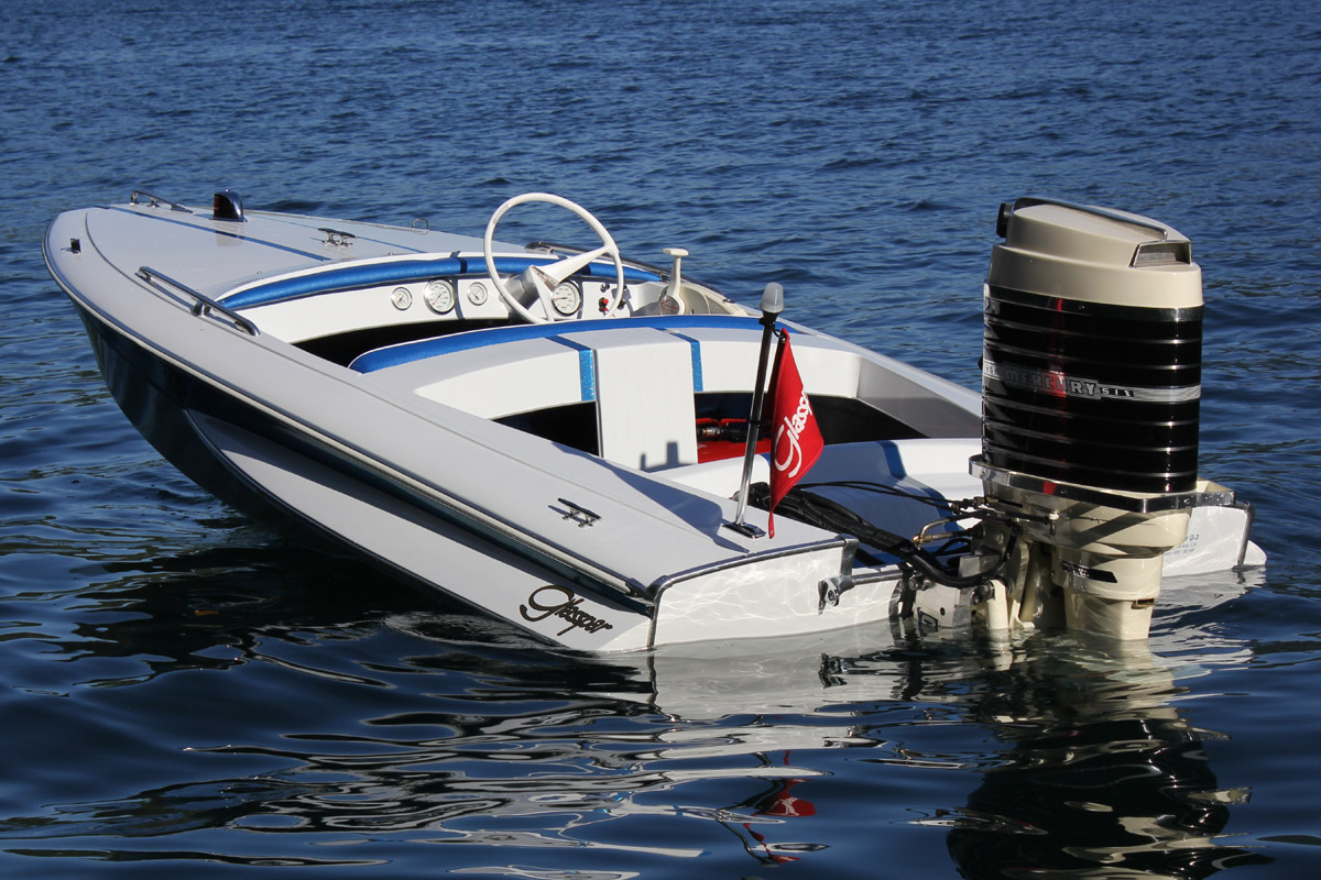

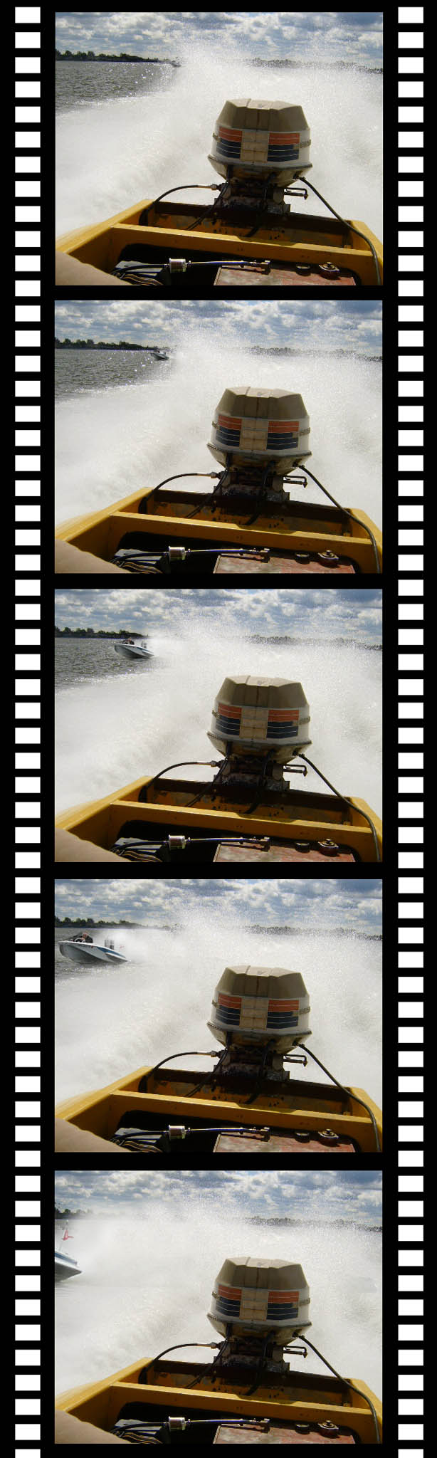

Here is a picture of Mercury Momma's '66 G-3 powered by a 15" Merc 850xs with power trim.
Very nice combination IMHO, and much more docile than Wild Thanggg powered by a short shaft Mercury 1500xs.
