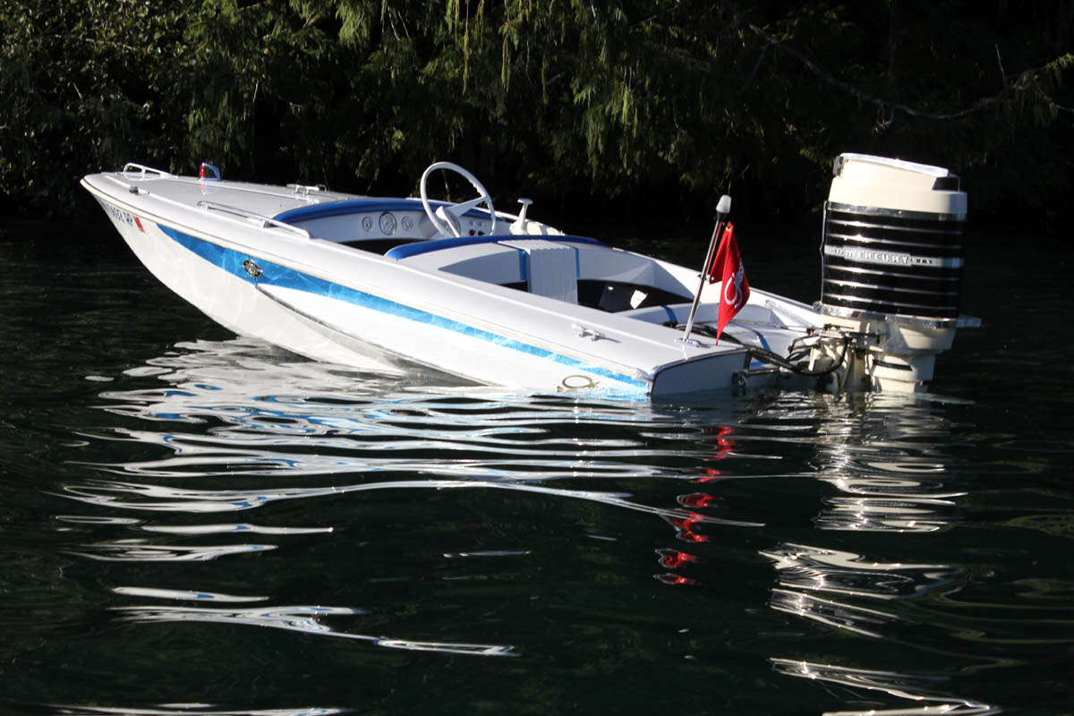

Hi Jim,
My Merc 850 weighs 240 lbs, I have it mounted on a CMC Tilt and Trim unit that is about 40 lbs. I wouldnt hang any more weight than that on the back of a G3. You can see from the photo how much free board I have on the transom.
Bandit - 1959 Glasspar G3

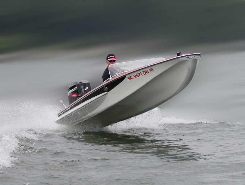

Lar,
Is this John P's boat?

Yes, that is John's boat, but he's running a 50HP 2-stroke Merc on it.

Also JP has Factory T&T plus a hyd jack plate, gets him in the respectable mid 40's{~:)) Sweet g3!

Re:4 stroke G3 14 years 11 months ago #51247
deanlofall wrote:
Hi Jim,
:ohmy: maybe ya forgot to put the drain plug in when ya launched it? :unsure:

Re:4 stroke G3 14 years 11 months ago #51453
Thanks Bill! ;)
