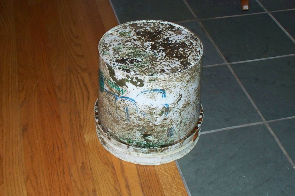

This little piece of seemingly innocent EVIL is one of the many very serious things that can totally ruin a boater's day.
I would have never seen it if there had been even the slightest chop or wave action, and I skimmed by it twice at well over 60 MPG.
Because the lake was like glass I saw what I believed to be a small fish surface feeding, but when that fish was still surface feeding on the next wide open pass about 6 feet off to starboard, I slowed, turned back, and took a second look.
This is what I found.
Floating just under the surface of the water, with bits of the edge breaking the surface as it barely bobbed around, was this (3-4?) gallon plastic bucket.
It has a LOT of algea growing all over it - making it very obvious it had been out there for quite a long time.
If you haven't ever experienced striking such an object you probably won't believe the damage it can cause.
It is like striking a block of concrete and will at a minimum bend your prop, more likely it will bend or break your prop shaft, and in a boat like we play in,...It could very easily cause a total boating disaster.
Flipping, drowning, maiming, or completely ruining your boating day and all around future.
It made me shutter when I saw what it was.

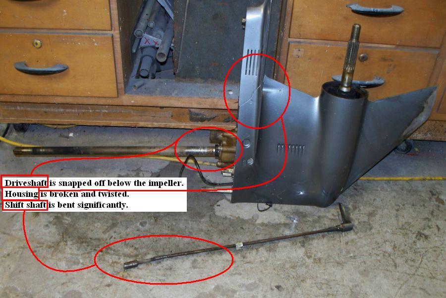

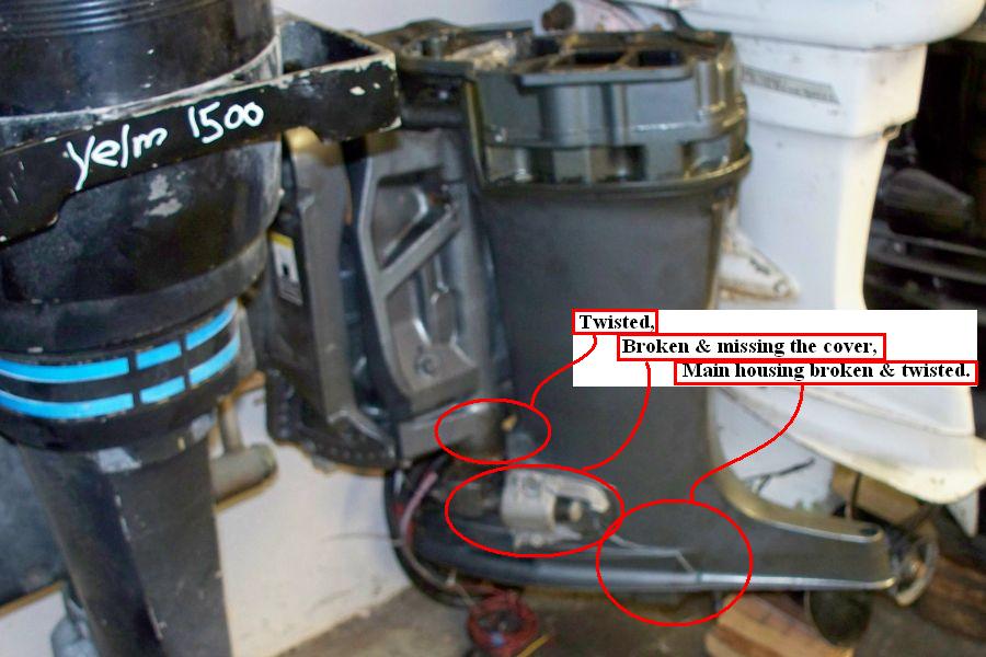

Re:Water hazards 15 years 4 weeks ago #48568
Here is what a deadhead can do to an inline-6 @55mph on a high performance hull.
Thom

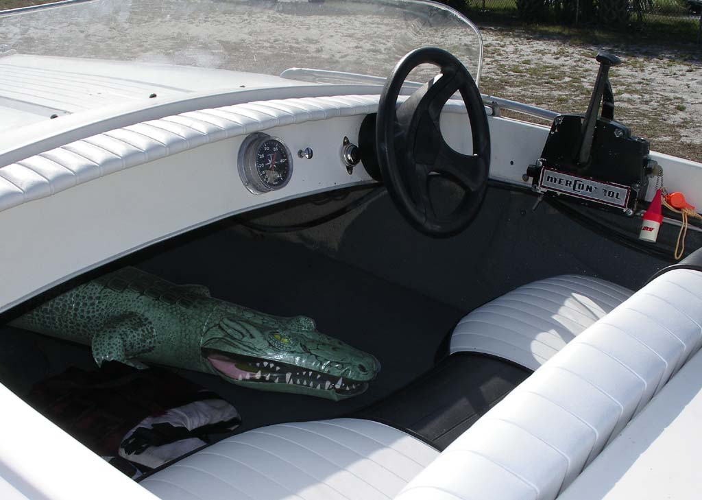

Re: Water hazards ... in Florida 15 years 4 weeks ago #48682
At the G3 Rally in 2009 we were given numerous warnings about alligators in the lake, by email before and signs when we arrived.
This was later proven to be correct, as one found its way out of the water into Jim's G3 :
Re: Water hazards ... in Florida 15 years 4 weeks ago #48686
  • g3bill
  • g3bill's Avatar
  • Posts: 251
  • Karma: 45
I was wondering where Jim's pet was :laugh:
