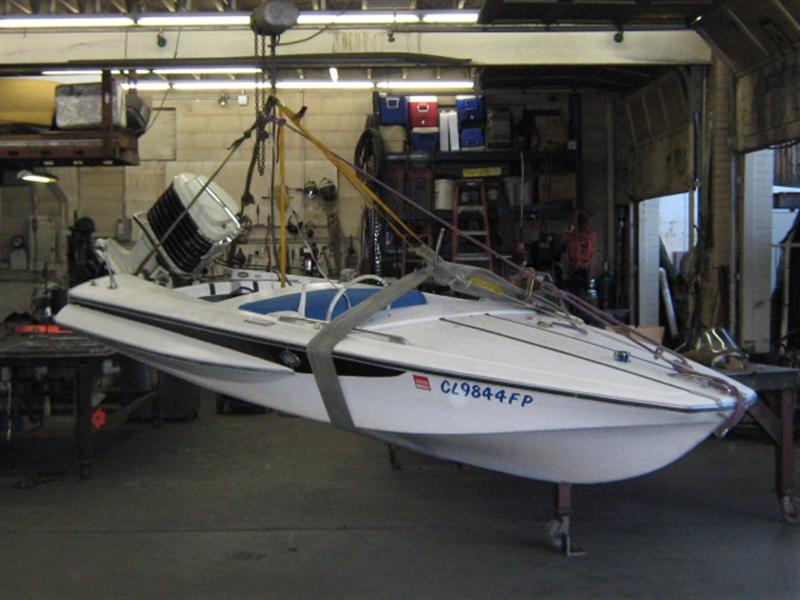

    or, you can over kill it, like shown below....
    lar

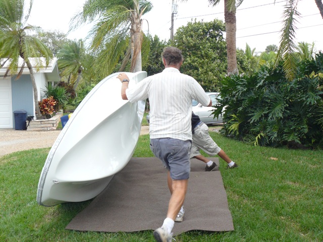

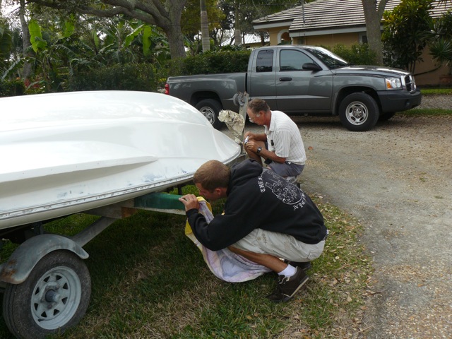

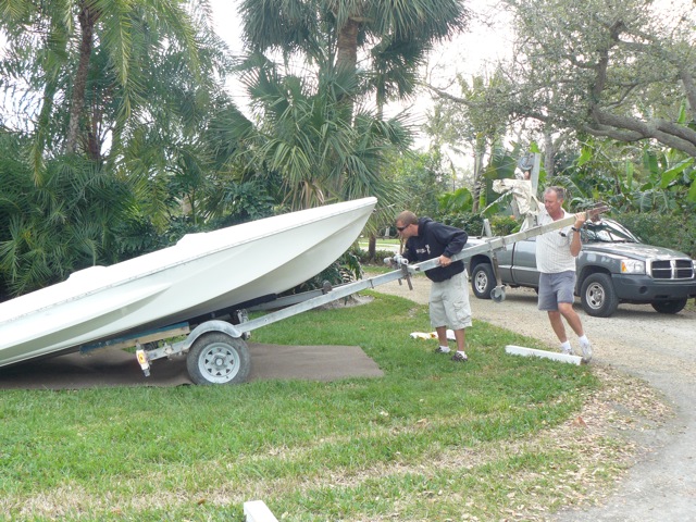

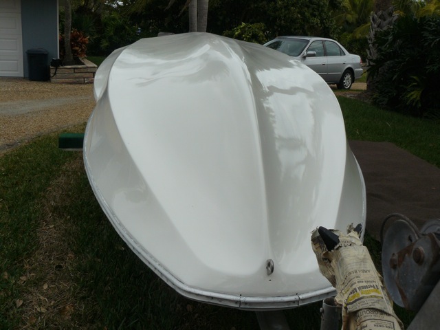

    Re:Remove G3 from trailer 15 years 1 month ago #44946
    Jason

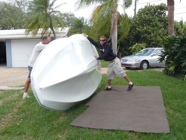

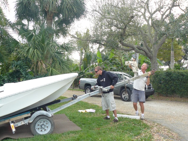

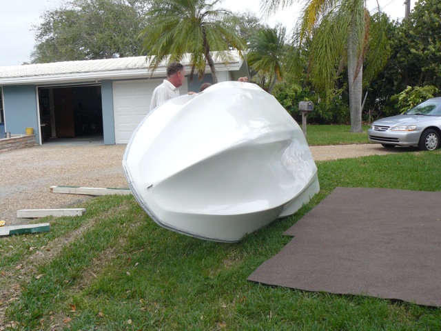

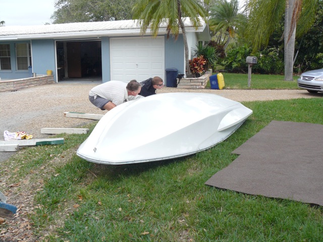

    A G3 without a motor mounted on it is a relatively light boat, about 400 pounds.
    Removing it or replacing it can be done by two people. Just do it.

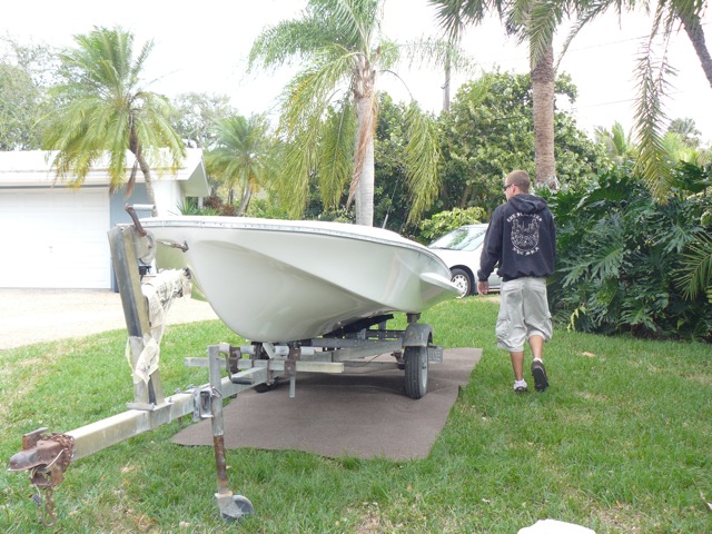

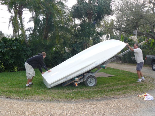

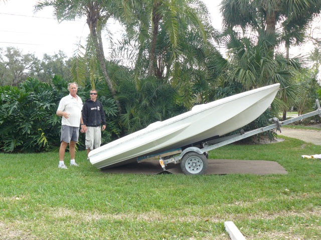

    Here are some pictures of myself and my Son moving my G3 around during the
    period I was refinishing it.
    John

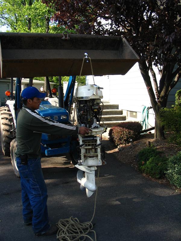

    Re:Remove G3 from trailer 15 years 1 month ago #44988
    When I grow up, I want one of these......
    Re:Remove G3 from trailer 15 years 1 month ago #44990
    • g3bill
    • g3bill's Avatar
    • Posts: 251
    • Karma: 45
    Now were talk'n! I need that to get the 85hp Anchor off my Seafair,LOL :)

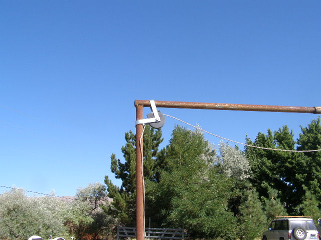

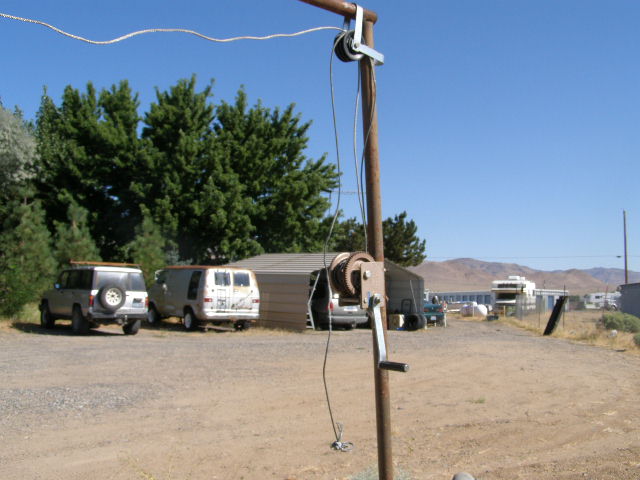

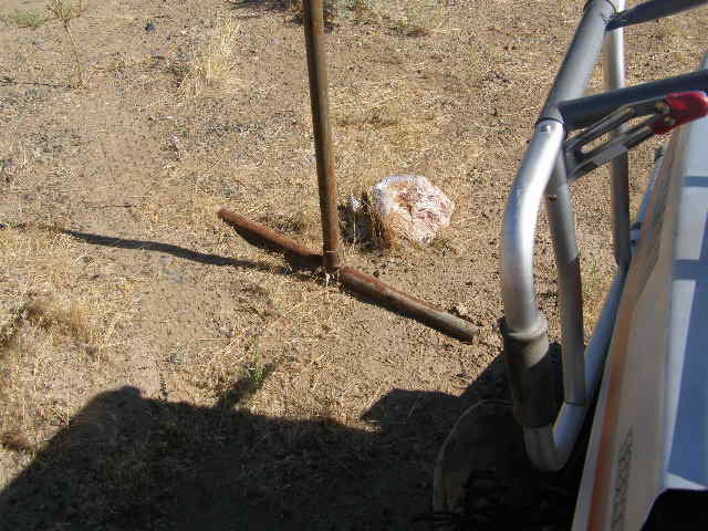

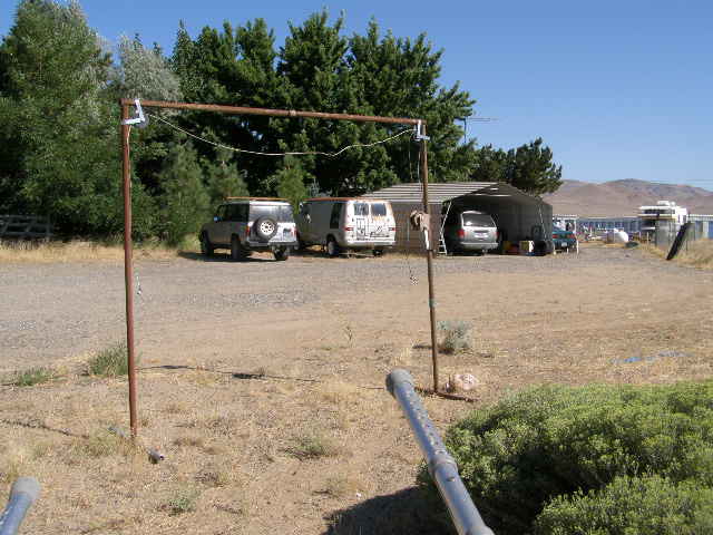

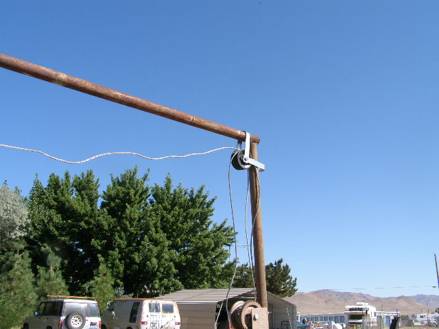

    Ok here is what I made up to lift boats. All you need is some pipe and elbos and tees and some pullys and 2 winchs like on boat trailers. plust somebody with a threader or weld it like I did.
    Mike aka the pirate
    PS
    I made 2 of these you put a strap under the boat and hook to both side of your hoist
