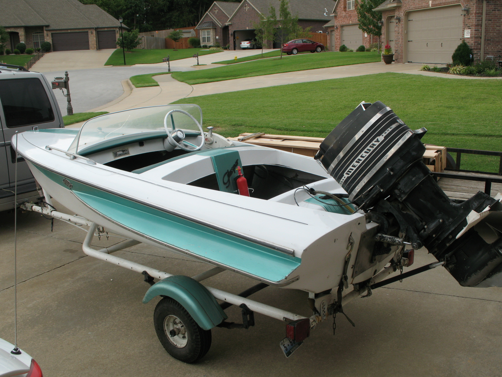

Just drove 2,000 miles round trip in two days last weekend to pick up a 1960 G3 with a 1965 65 hp Mercury. I think I got a good deal, at least I hope so! Transom will need rebuilt at sometime cause there are a couple of soft spots on it but I plan to repair it temporarily and use it first. Windshield also is cracked, don't have any idea where I can find one of those. All in all, it's not bad for a 50 year old boat. I plan to completely rebuild the whole boat in the near future. When I do, I'm sure I'll be on here asking lots of questions!!!!

Congratulations on your G3 and Welcome to the club!
Your boat looks very pretty and the 650 is a great motor for it, I used to run a merc 650 on mine. What prop are you running on there now?

:laugh: All g3's are pretty:) Looks real clean also and perfect motor for it. That bow trim is a '61 one piece, '59 and '60 were three piece. Do you have a 'speed bump' a hump for a foot rest under bow will be '61, unless someone changed the trim piece? Yes, more pic's will be cool, interior of dash and stern shot of motor and transom are good shots also? I like the tilt trailer but would convert in the future to bunks, thats what I need to do. B..

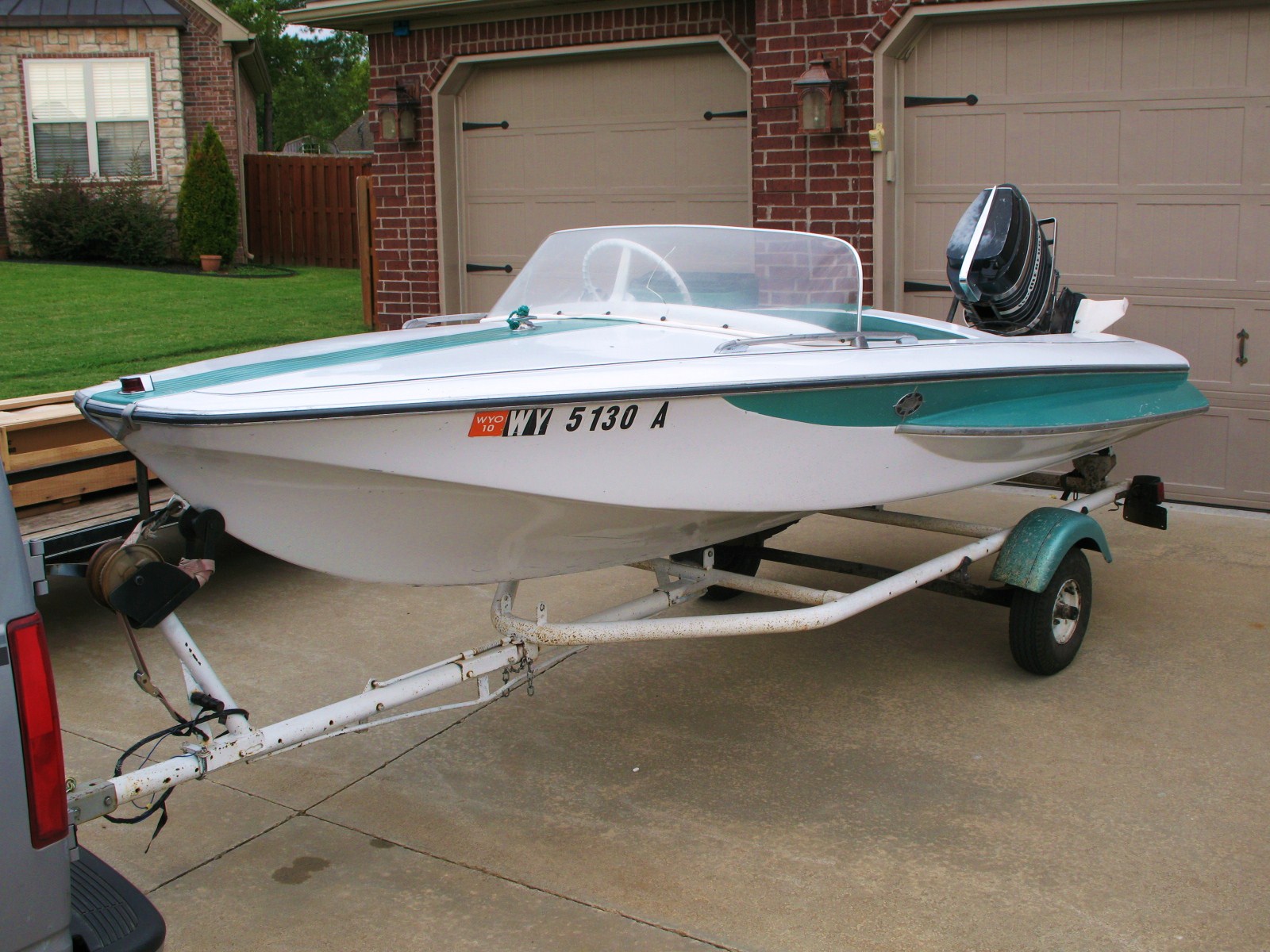

Very nice, lets see some more pics!!!! where are you, reg seems to say WY....? Wyoming?

Is the motor a '63 or '64? I cant tell without its front plate.

LOL, your right Dean. Ark, well we can't tell yet if you have a '63/'64 650 but not a '65 for sure, '65 had the control hook-ups inside the cowl making it a bit wider. 650 Merc Serial numbers 1646983 thru 1766053 were 1964 models. windshield, dont scrap it, there too hard to find, Later you may need it to make a one off copy. For me, I wouldn't change the trailer tires if there good and the high rating, you only have under a thousand pounds including trailer there, i'd grease the bearings first though if not yet done. I like the rope tie thing on the bow deck, pretty smart idea. What a long trip you took to get it, but looks worth it!:)
If you haven't read this page, its a very good idea for it has lots of info on the g3.(Scroll down) archives.fiberglassics.com/g3/glassparg3.html

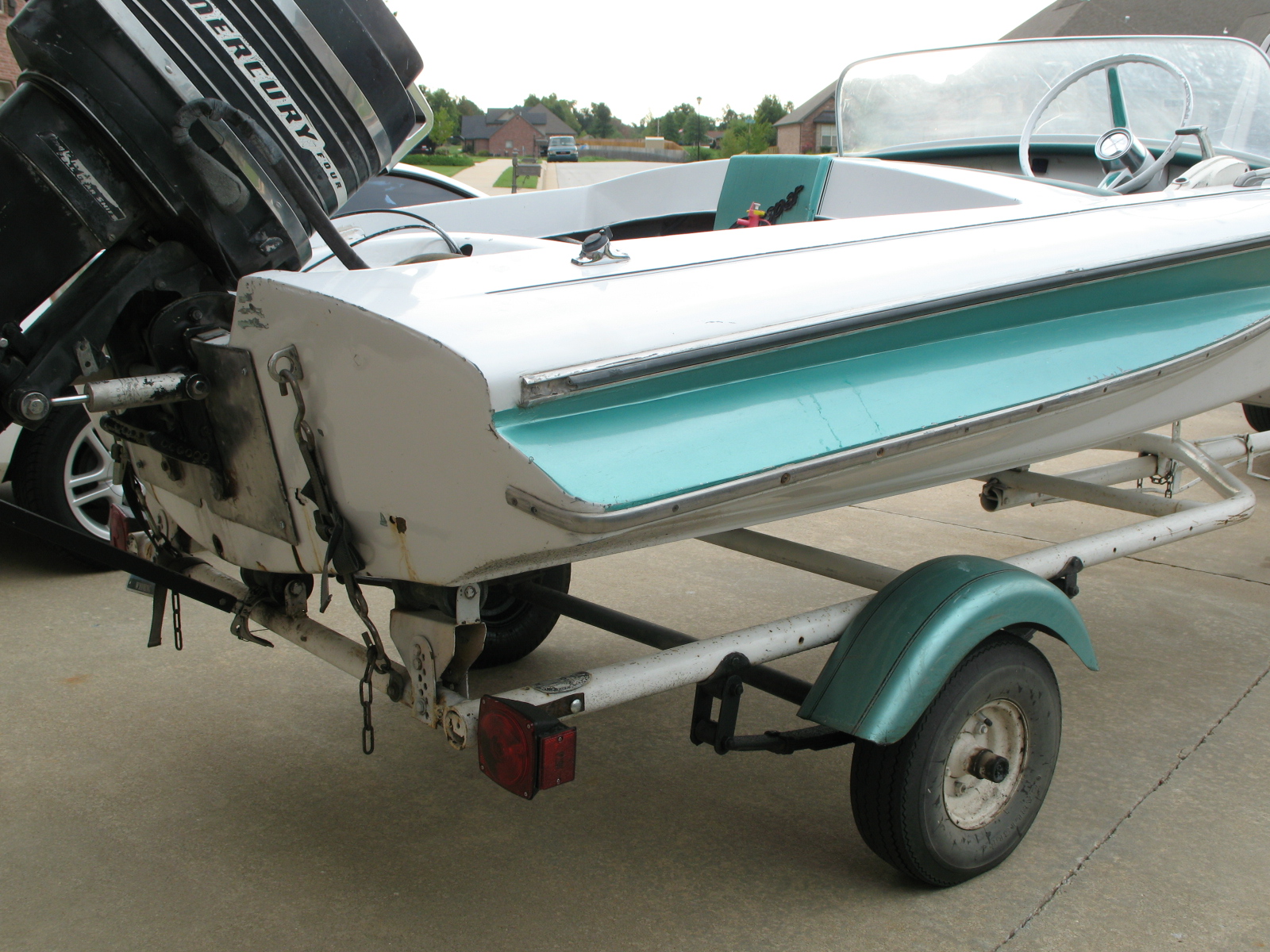

Dean did you miss it, the trims missing in the transom area, L&R castings and the transom must have been worked on or replaced...
Your pic's are very high res , could that be causing you problems posting pic's perhaps?

My guess is the engine is a 63, looking at the pics I did notice the lower left transom plate rust stain. not a good sign. rusty bolt = leak, But Im sure you will go over it before you launch. I dont know how much you know about these boats or have read about them but If I may I would suggest you ck all screws on the sponson moulding and any other through hull bolts-screws above and below the water line, many of us have had unusual leaks from these ol G3s. I also would sugest you float it before just going out with a load of freinds&family coolers etc until you have located all or any leaks, How long has it been since the engine has been used? It is a mag style ign. and usuly need the points cleaned etc. But all in all I think ya did well ,price wize. Its a real good looking G3.

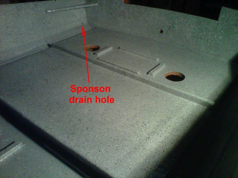

Good point! you can check the sponsons for water buy laying inside, looking from the inside at sponson and shake the boat a bit to see if theres a wave,lol. well mine was like that when I got it... Saw mine in bright sun but suppose a flood light will work, not sure if its a color. At the very corner next to transom there was a 1/4" hole to drain the sponsons, guess the preowner did that and plugged it with a dowel. I removed the sponson trim screws and put a bit of silicone in each and inserted the screws , no problem after that. IMO I would also check the over looked keel as it curves up from about where your missing a roller, if it were beached alot it could have rubbed off enough glass to cause a leak, Mine did, :angry:

Yours that is complete and useable with a working Merc 650 and windshield seems like a very good deal. You need some trim pieces around the transom, so start looking now... it will take a while to find them.
Bill, the sponson should have an open drain hole, they should not collect water. I think its 1/4" at the aft end... any water collecting in the sponson should drain out into the boat.

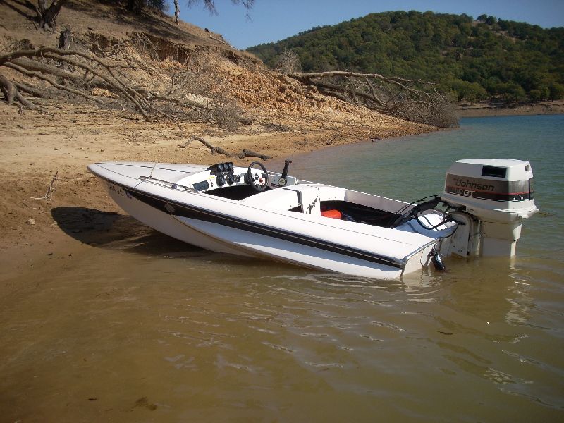

Dean, You have a great looking boat! Hope mine looks that good someday! I have a long ways to go!
Re:New G3 Owner and New Member 15 years 1 month ago #43142
Thanks!
The guys on this site provided a lot of help and inspiration to see it through. I got a lot of enjoyment out of the project, which kept me busy from December to July... but now I'm using it, and its great fun!

Dean I wonder if those holes were original, was never sure as I think many dont have the holes?

the motor is a 63 merc 650

Your BOAT looks good, and obviously appears to have been extensively worked on or maybe even restored at some point, hopefully recently? The missing transom trim might mean someone already replaced the transom wood, and since the seat has obviously been re-done, maybe they replaced the stringers and floorboards at the same time? :unsure: Maybe, hopefully, you don't have as much work ahead of you as you suspect, and if I am right, you got a GREAT deal for $700.00!
