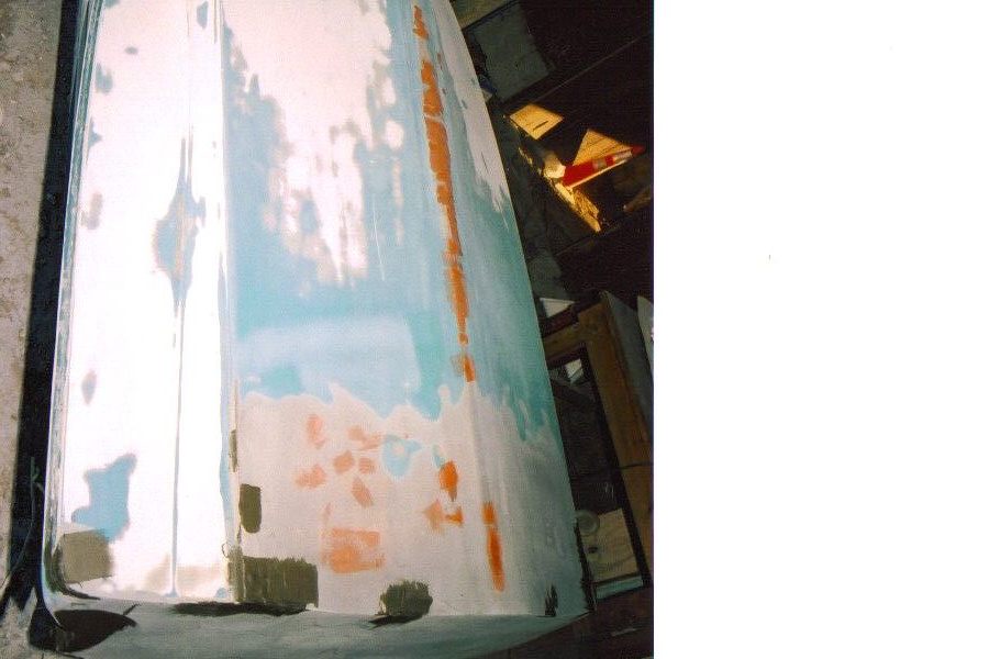

Im goin to lokk in the vult for some rocker pics,
ok in this shot you can see where I built up the last few ft of the hull, this boat would have rocked like john Cougar if I didnt build up the last few ft of hull

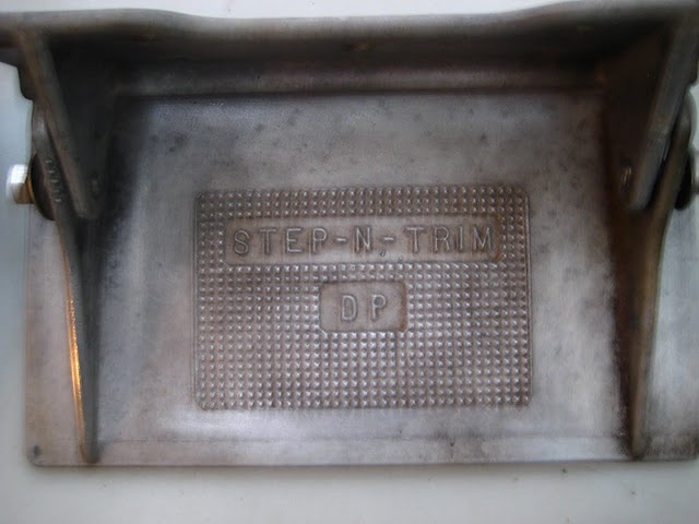

For those that haven't seen a Step N' Trim tabs (nla), found this pic on a site. Think they made about 3 sizes and can only be found used as far as I know. Most don't like fixed ones I guess but good enough for yours truley, g3bill :)
