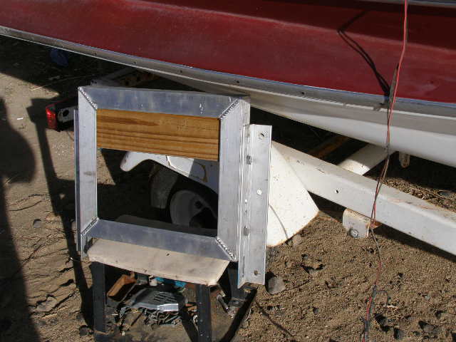

I don't know what a good a jack plate is except to put a long shaft motor on a short shaft transom.

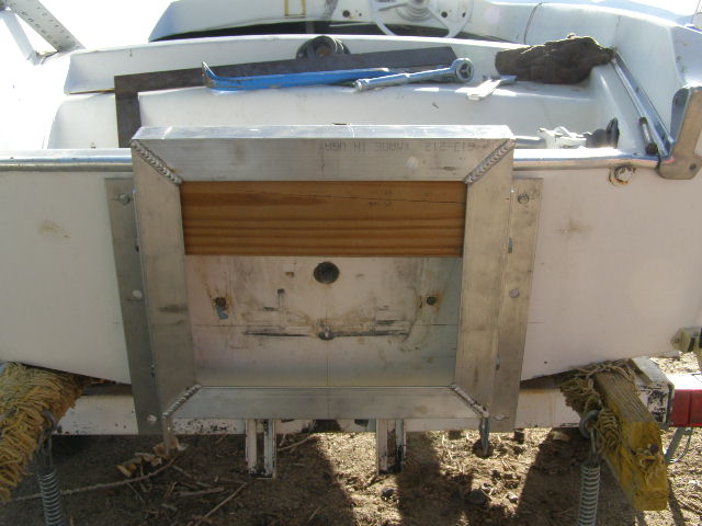

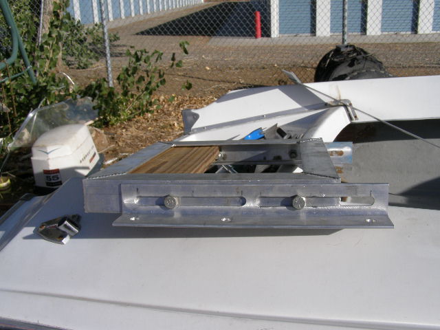

Heres pic or 2 of one I made to put a long shaft bear cat on a G3
Mike aka the pirate
Ps
The was made out of 2in angle alumimum [img] [img]http://www.fiberglassics.com/media/kunena/attachments/legacy/images/PA260004-20110823.JPG

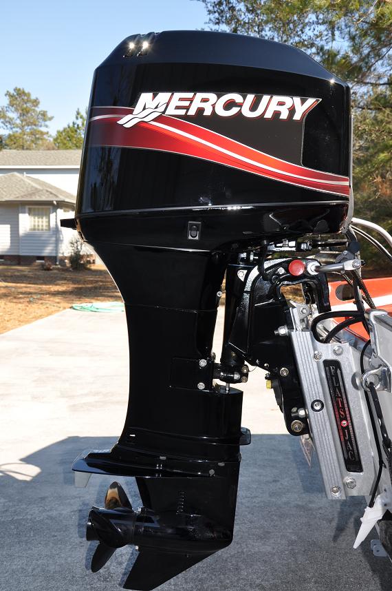

I installed a "Bob's Machine Hydraulic Jackplate" on the transom of our 1960 G-3 and could not be happier with it! In my opinion, it is one of the best things I have ever done to our G-3. In addition to being able to run in shallower water with it, it also gives better performance as MadProps explained in his posts. I was helped on my decision to go with the jackplate by Fiberglassics Member Kevin Sweeney. He has two (2) G-3's and has the same jackplates as I do with no problems whatsoever. I see no downside to installing a jackplate on any G-3 at all!
Good luck to you Sir!
