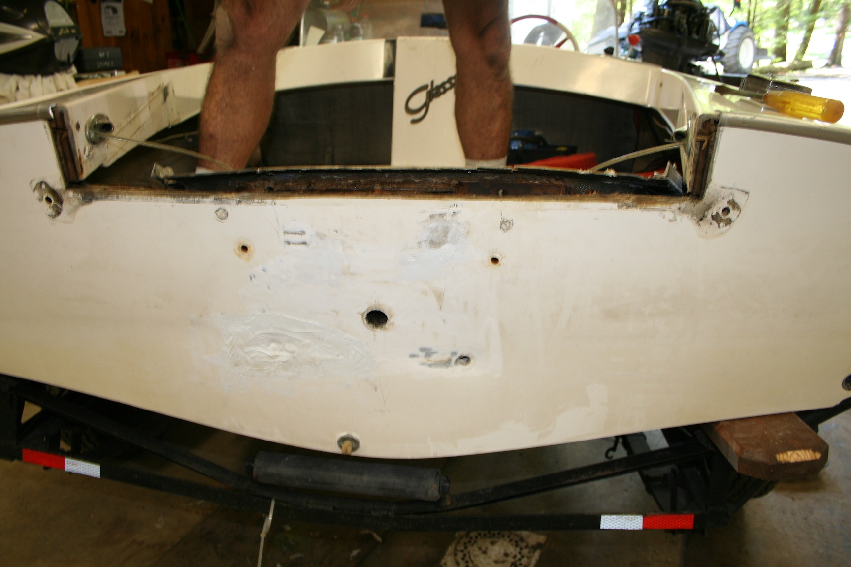

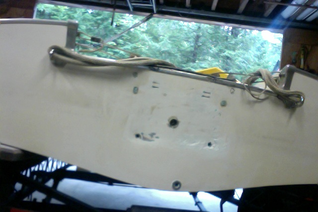

NEXT ISSUE: when checking the boat and hull for leaks i came across a very grim detail... the transom is rotting away and if i hadn't pulled the boat out of the water and noticed it then i would have been in some SERIOUS trouble. anyone have any tips on rebuilding a transom??
i epoxied the broken in transom (with marine tex) before realizing the actual situation

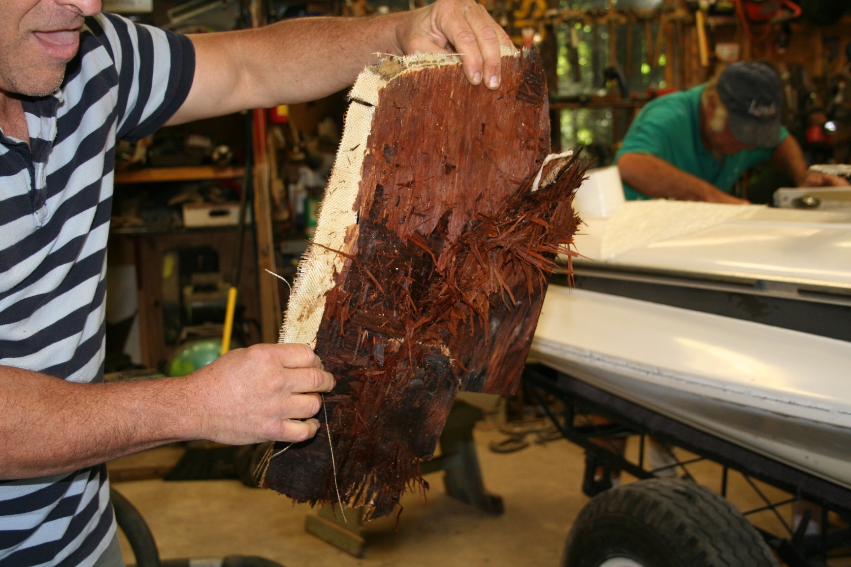

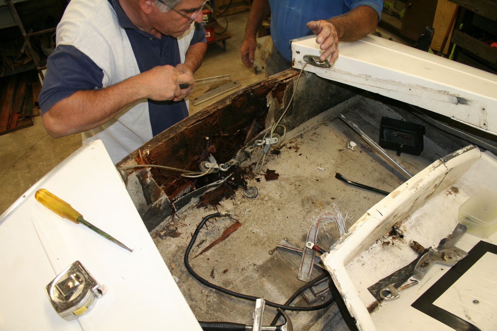

Re:BAD LUCK 15 years 2 months ago #41808
derick,let me congradulate you on your stroke of good luck. this hobby is about to expose your young mind to an assortment of trades. outboard mechanic,rigger,woodworking,fiberglass,body and paint. these are all required subjects with upholstry and horse trader being electives. perhaps you will find your lifes work,or be inspired to hit the books harder,take your education to the next level and study for a profession that will afford you the income to raise a family and still enjoy this hobby,and hire out this work in the future if you wish.
you are not breaking new ground and there is no reason for you to reinvent the wheel. there are people here that have been down this road and they can guide you on your journey so ask for their help. my only suggestion is that whatever advice you decide to go with,make sure that person has actually be down this road,because you will find many that have only read the triptic. your buddy ben can guide you since he knows many of these people. once again,congrats on your good luck. skipp :)

Derek,
The issues with your boat are the ordinary problems with any original G3, especially the center deck models, because Glasspar eliminated the wood stringers in the 62 model years. Like Skipp said you are actually lucky you found out about them before catastrophic failure occured. Interesting you mentioned you are still in contact with the previous owner. Seems he could have been a bit more forthcoming about known issues with the boat BEFORE selling it to you. Also, I'm surprised Ben didn't at least give you the heads up on these possible problem areas. All besides the point now......you are looking at a big job at the minimum, and most likely, a total structural restoration, with new transom, stringers and floorboards, and since it will be apart for the first (and hopefully the last) time, eventually you will also need to decide if you are going to keep it stock or modify it. 15" transom, or 20"? Pad bottom, blueprinted stock or no bottom mods at all? I don't mean to depress you any more than you already are, but as Skipp said think of this as an opportunity to build your boat into whatever you want it to be! We will be here for you every step of the way! And when its all finished, there won't be a prouder captain on the water! Hang in there, and "Git 'er DONE" HA!

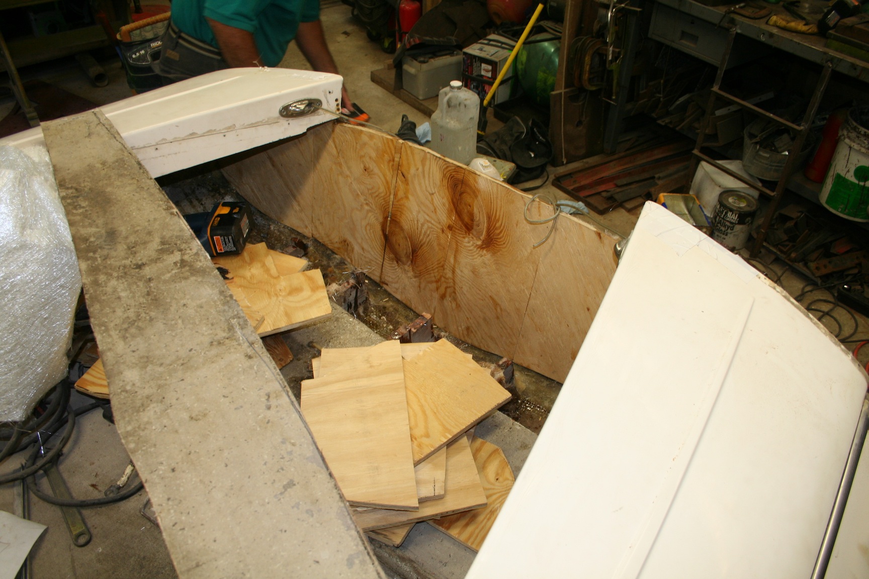

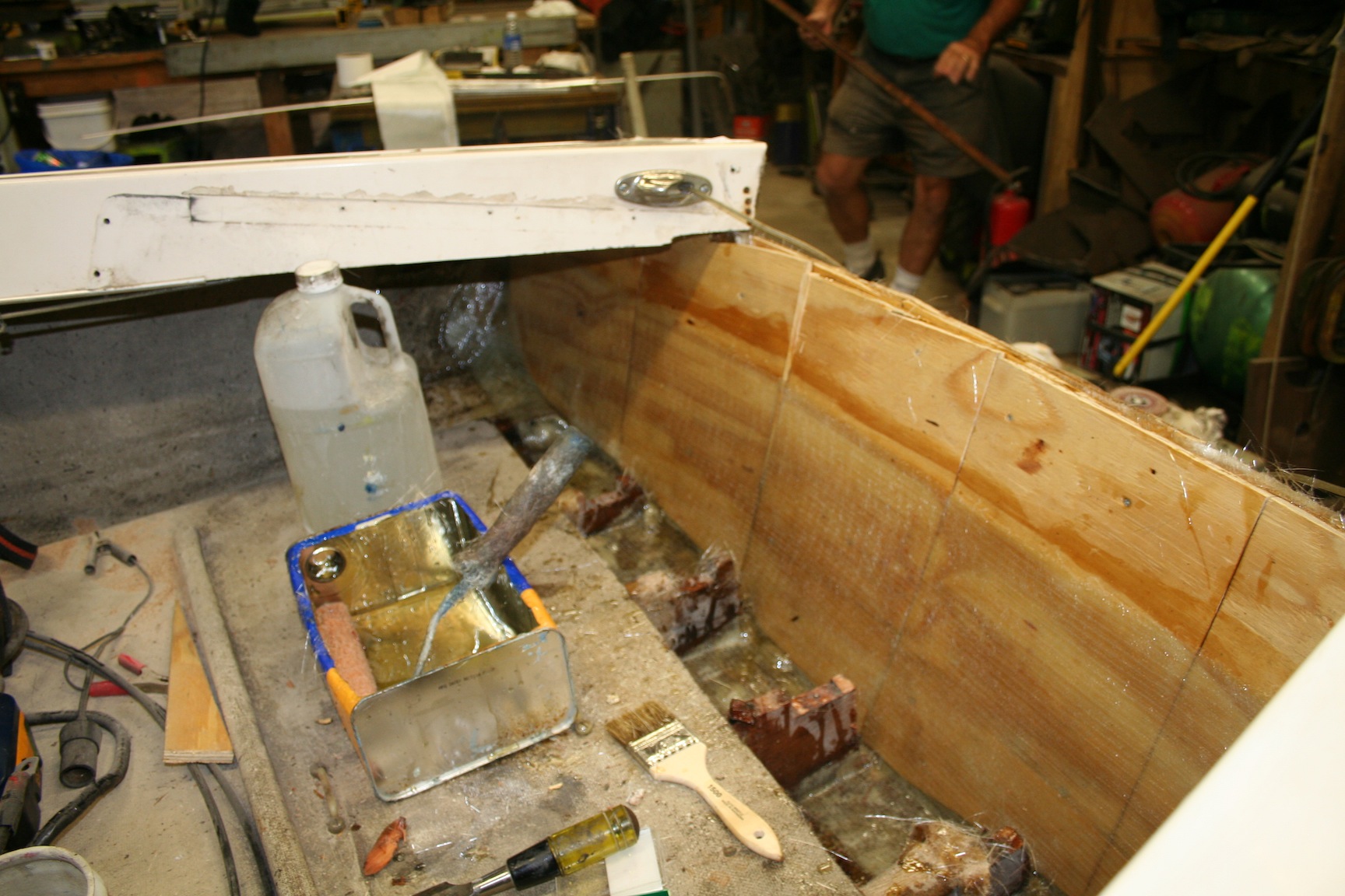

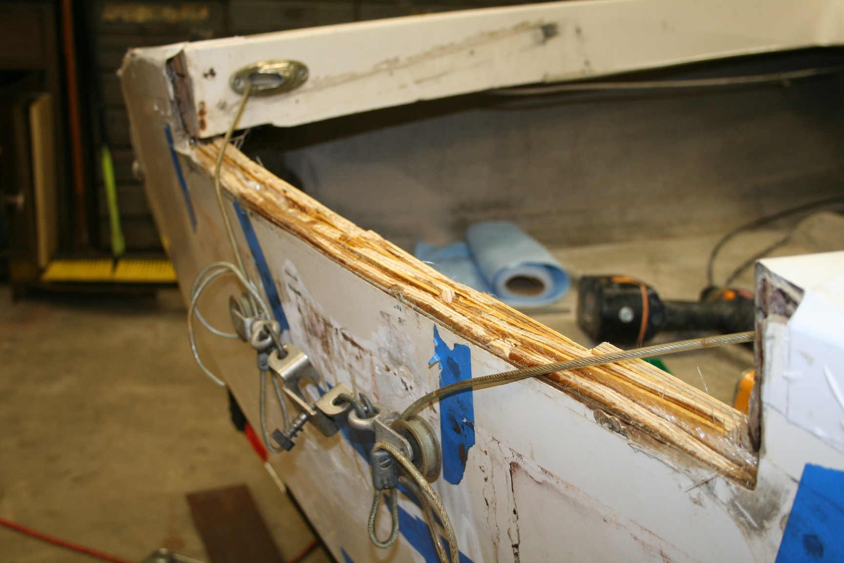

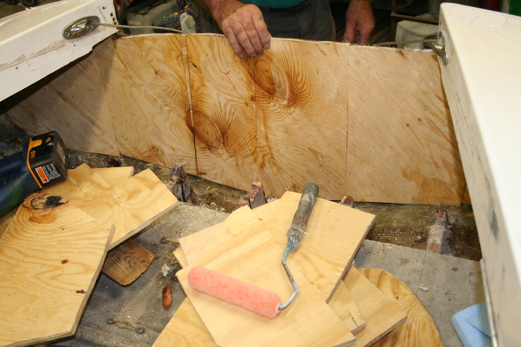

Re:BAD LUCK 15 years 2 months ago #41884

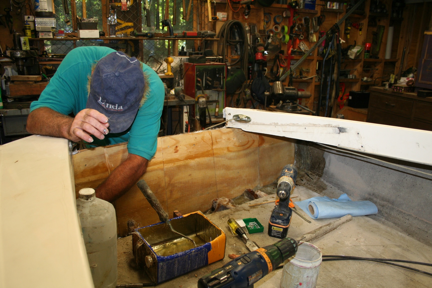

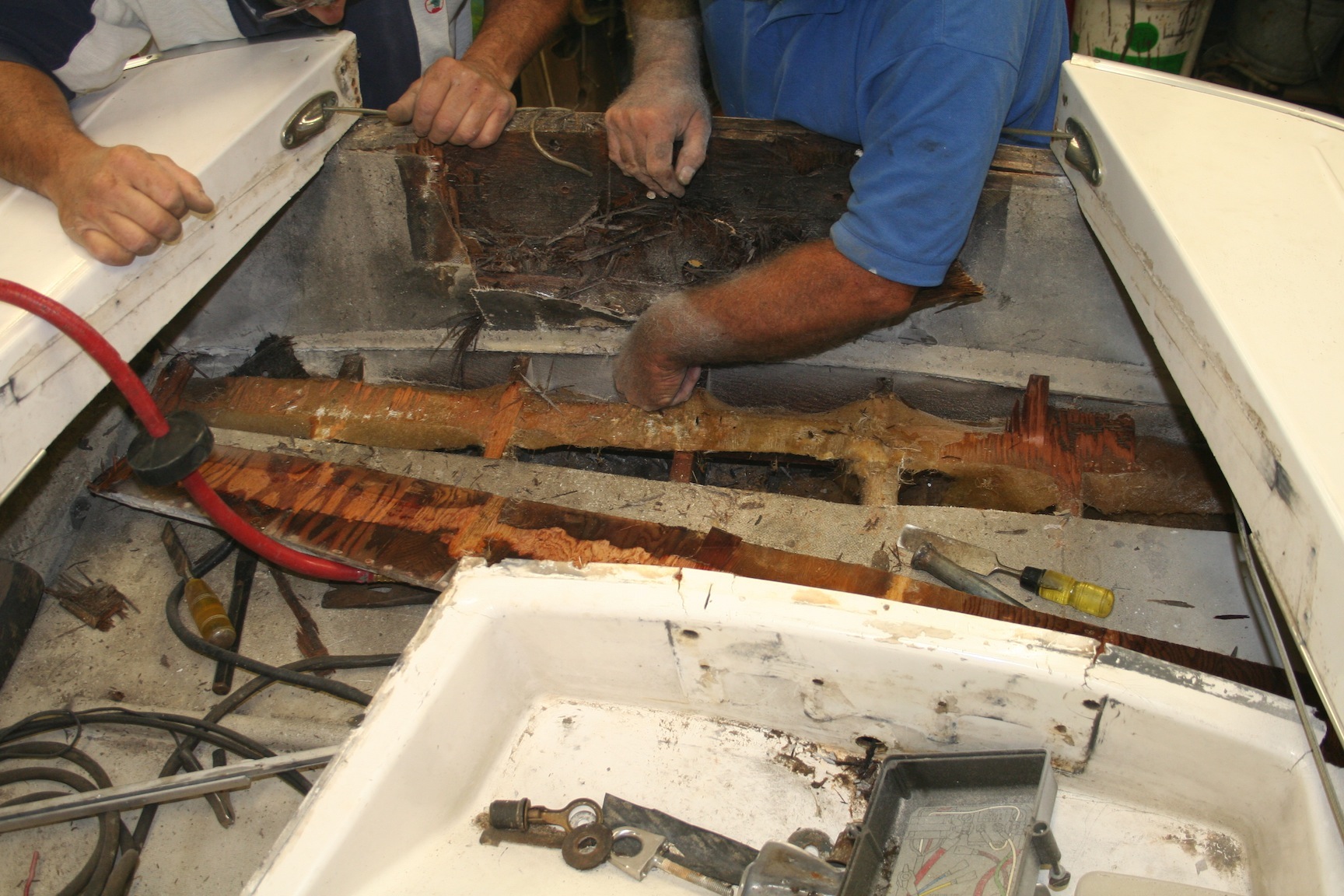

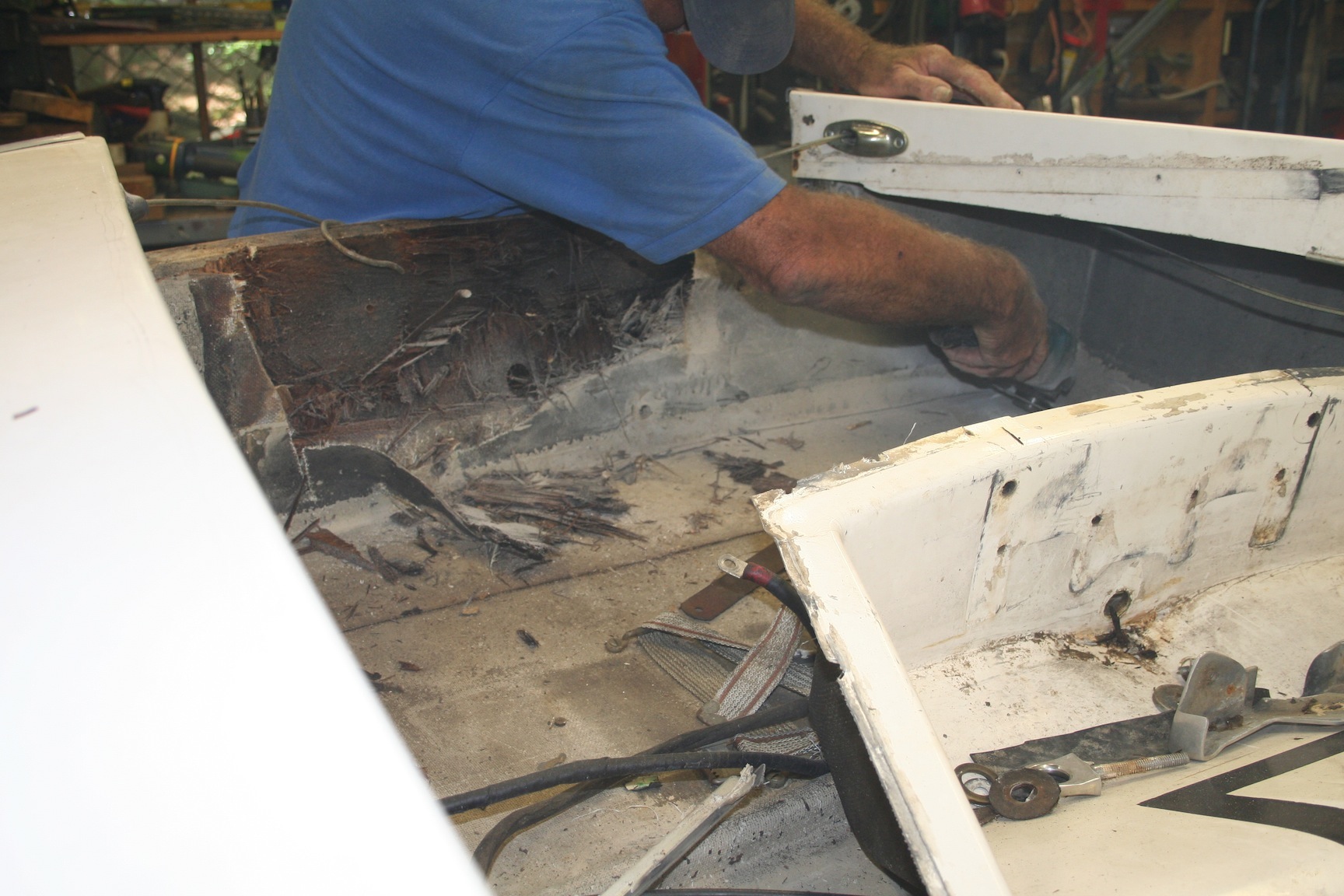

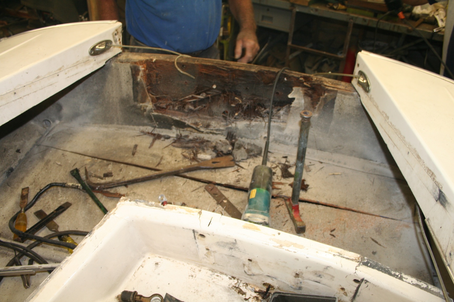

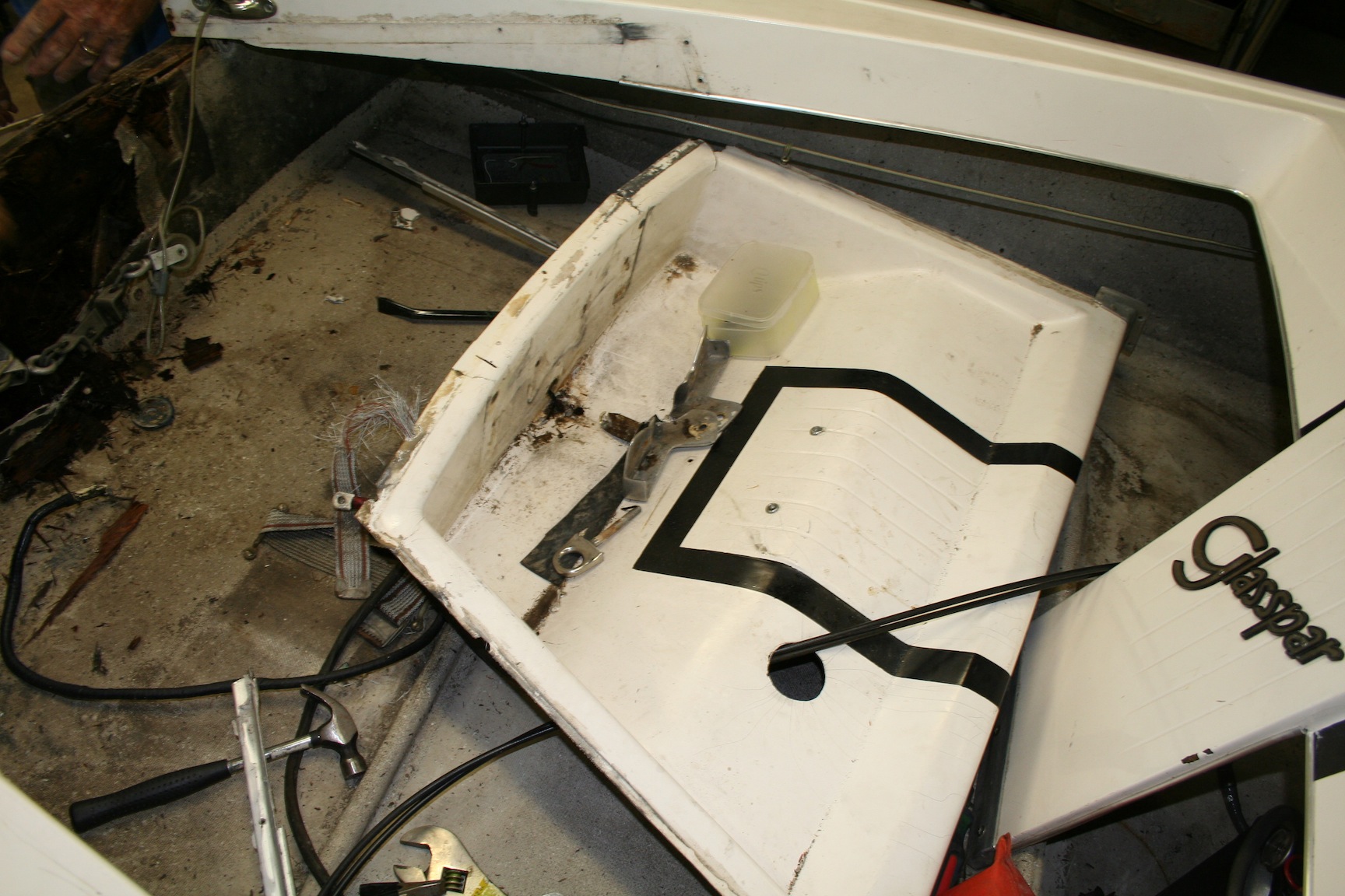

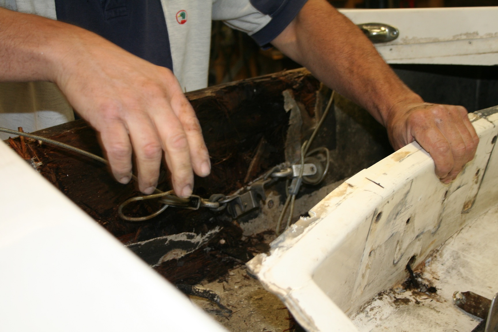

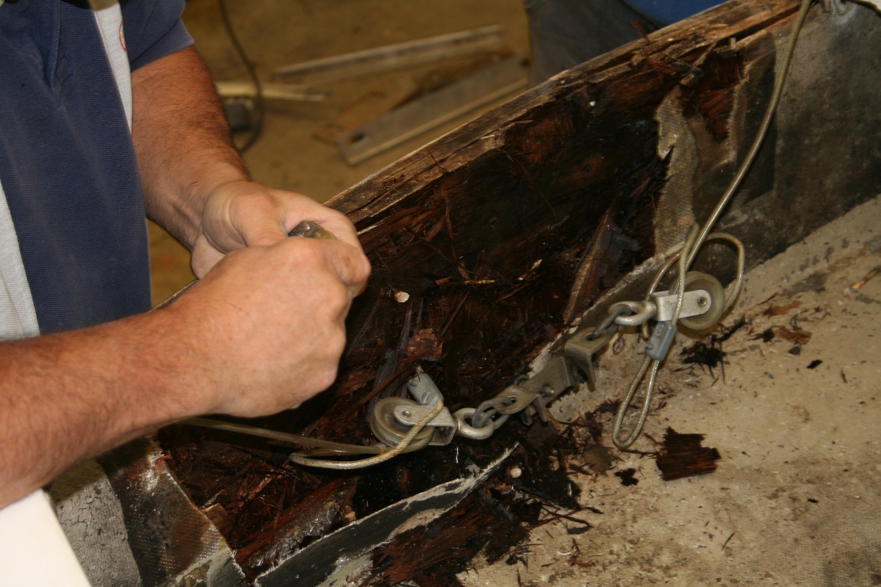

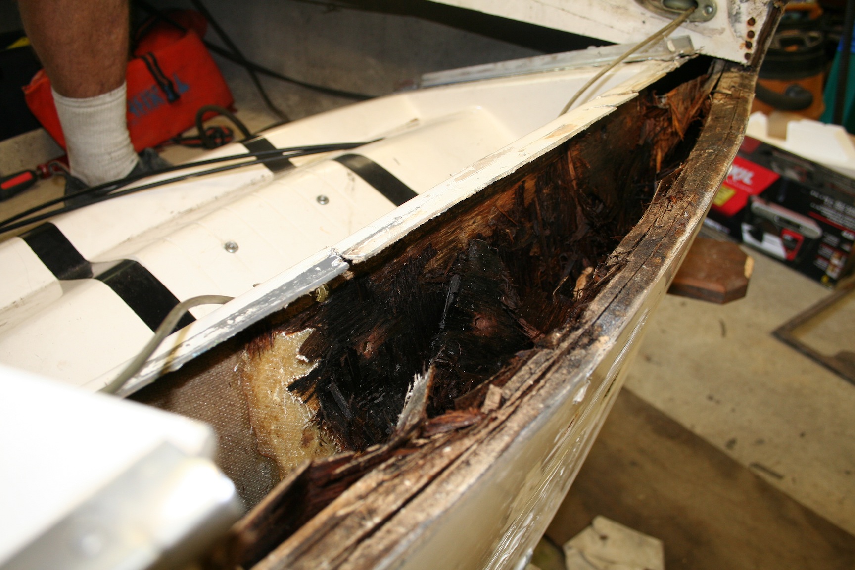

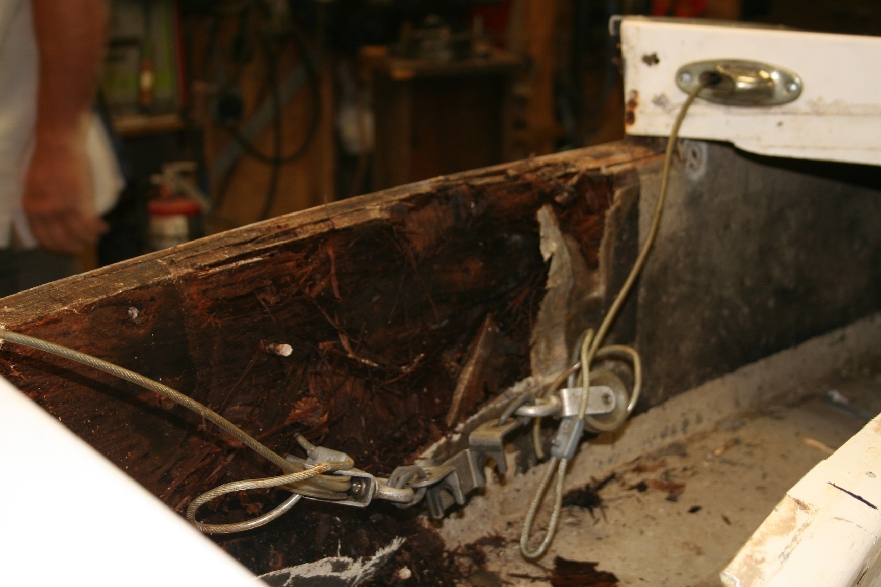

Rebuilding the rotted out transom:

Re:BAD LUCK 15 years 2 months ago #41899
thanks., with the help of a professional i got the job ALMOST done... one or two more days
Re:BAD LUCK 15 years 2 months ago #41905

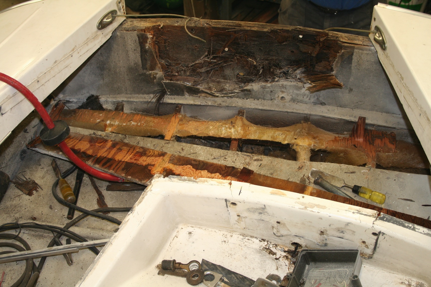

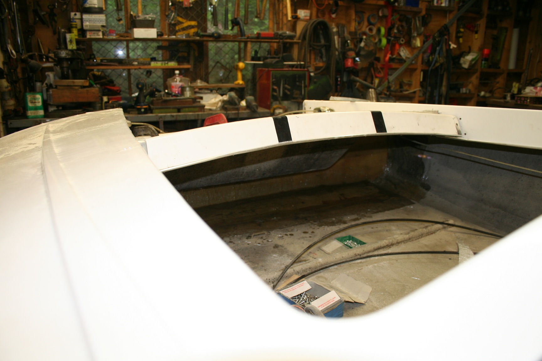

WW it looks like you are still a bit lucky, those srtingers look in fair shape in the pics,in fact it dosent look like its been all that long since someone was in there, too bad they didnt do a better job sealing it up. you may still see the water this summer-fall season. dont give up on that evinrude YET!

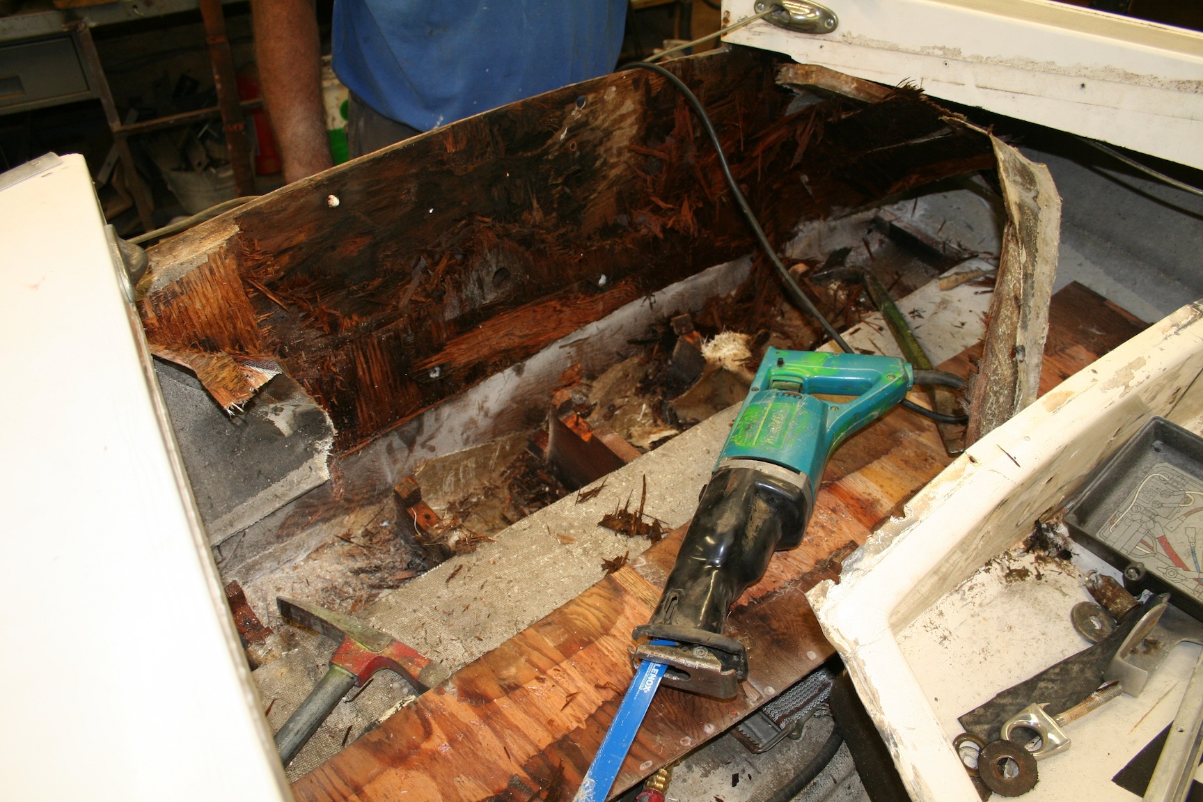

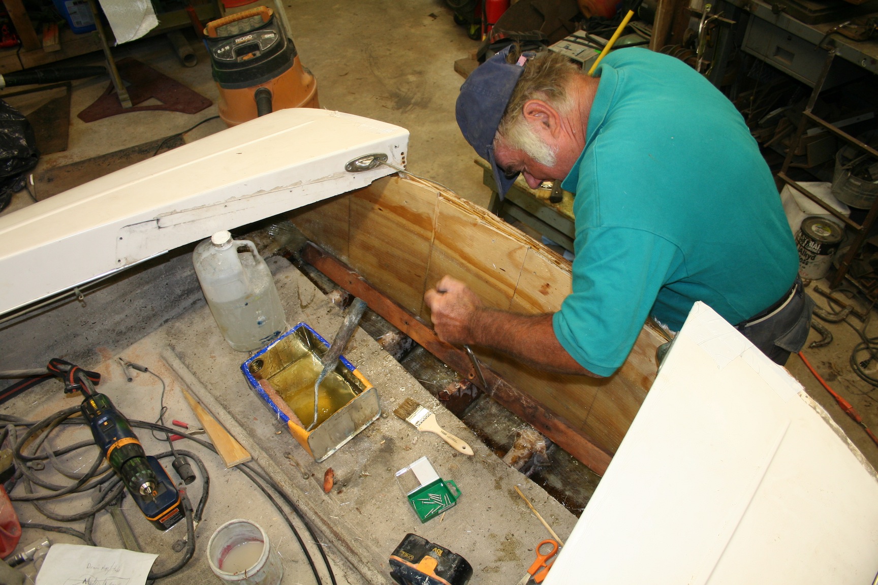

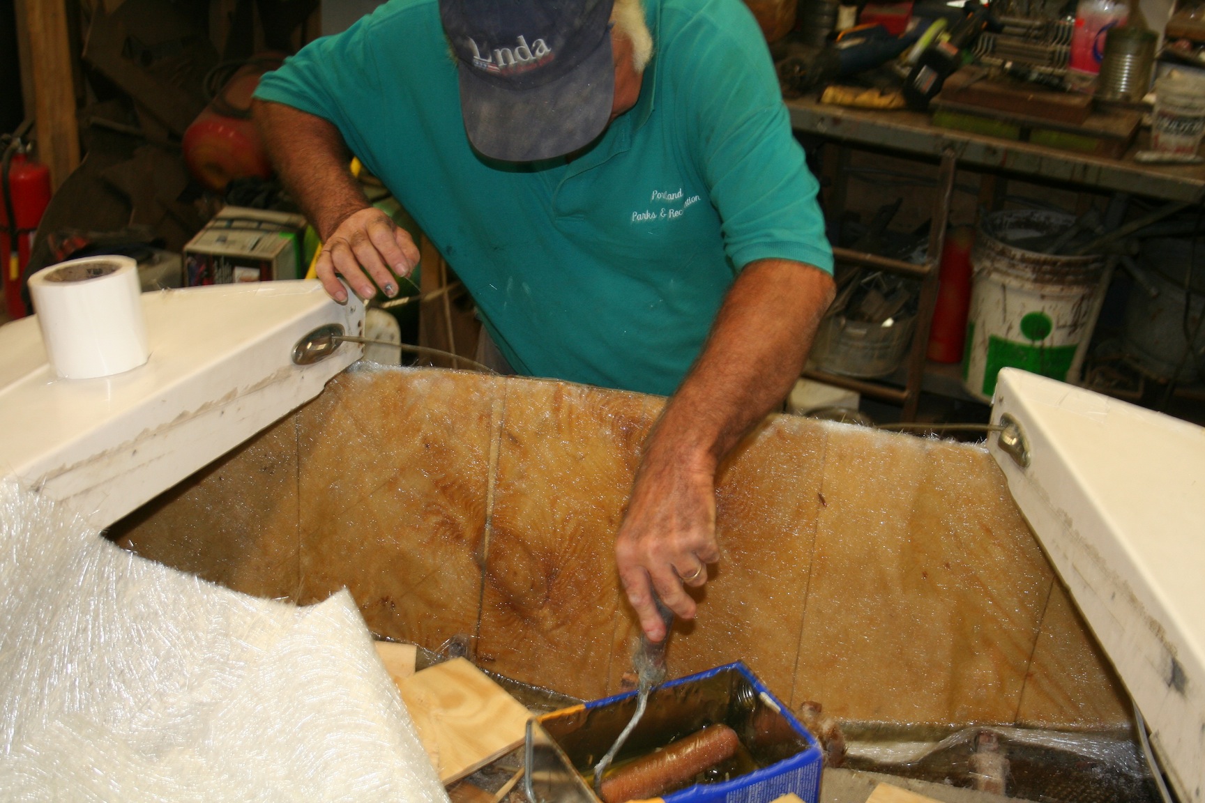

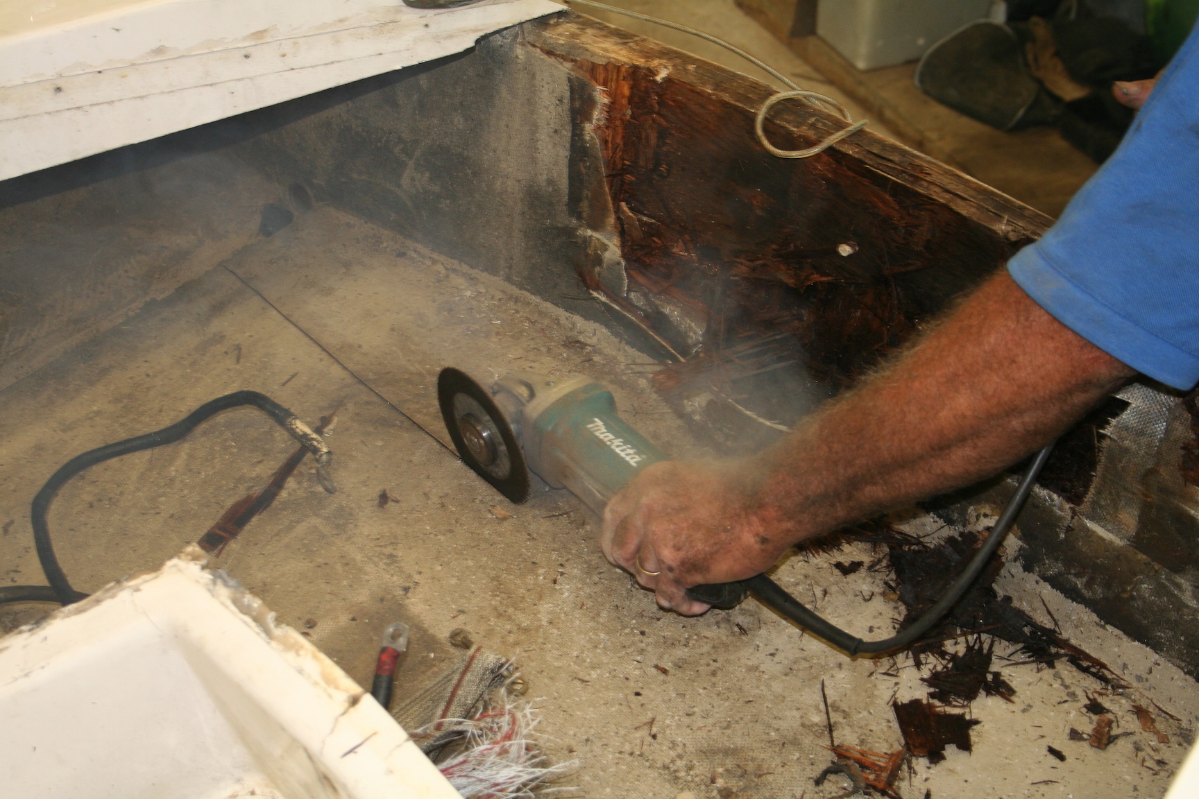

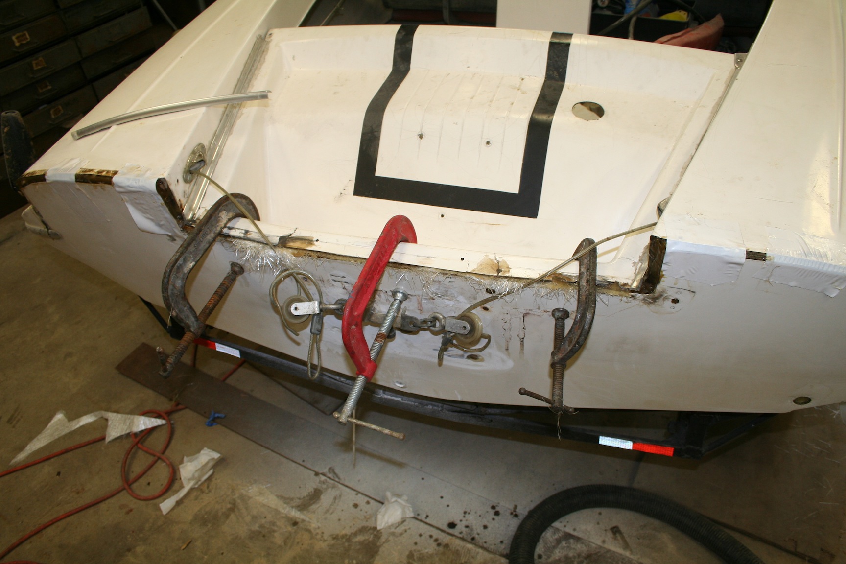

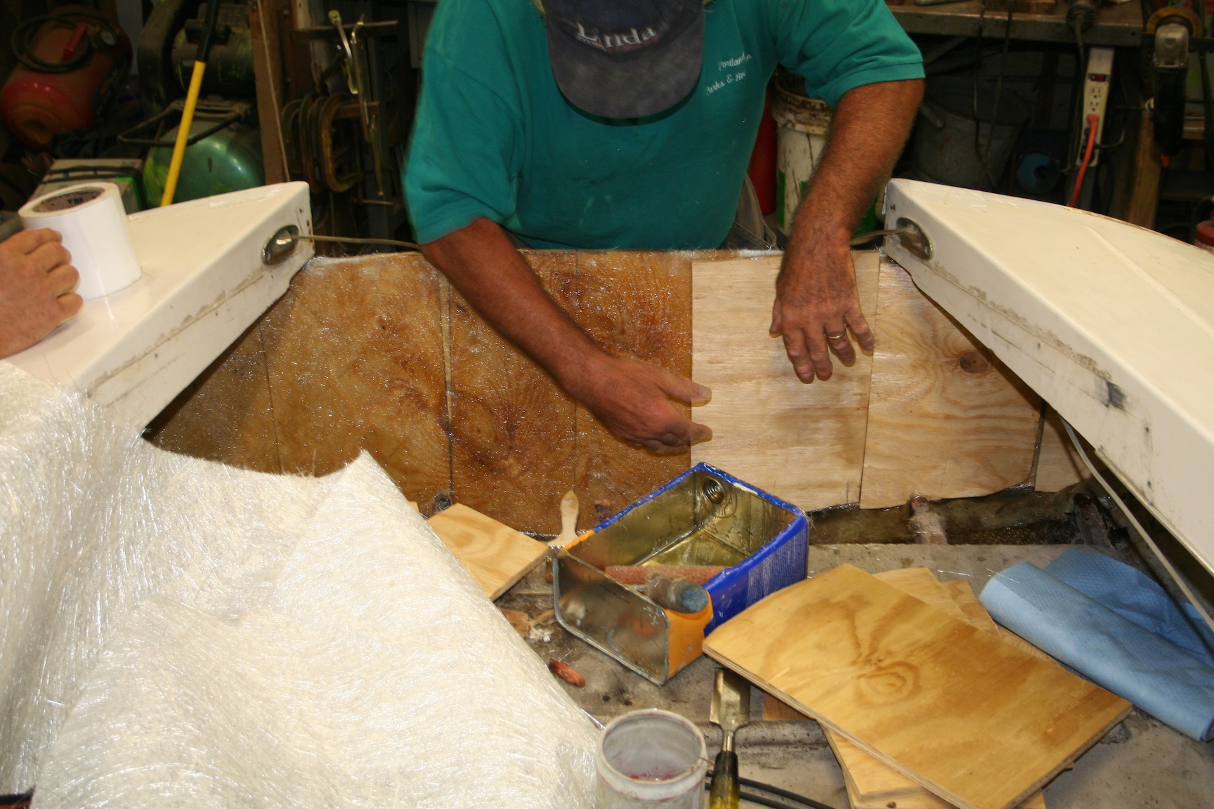

i went to buzzes for advice and he said we were in luck. bernard is the guy who rebuilt his g3 and he happen to be finishing a job in the parking lot. we talked to him, told him the problem and he stood up and said, "lets go!"
2 1/2 hours and the job is almost finished.

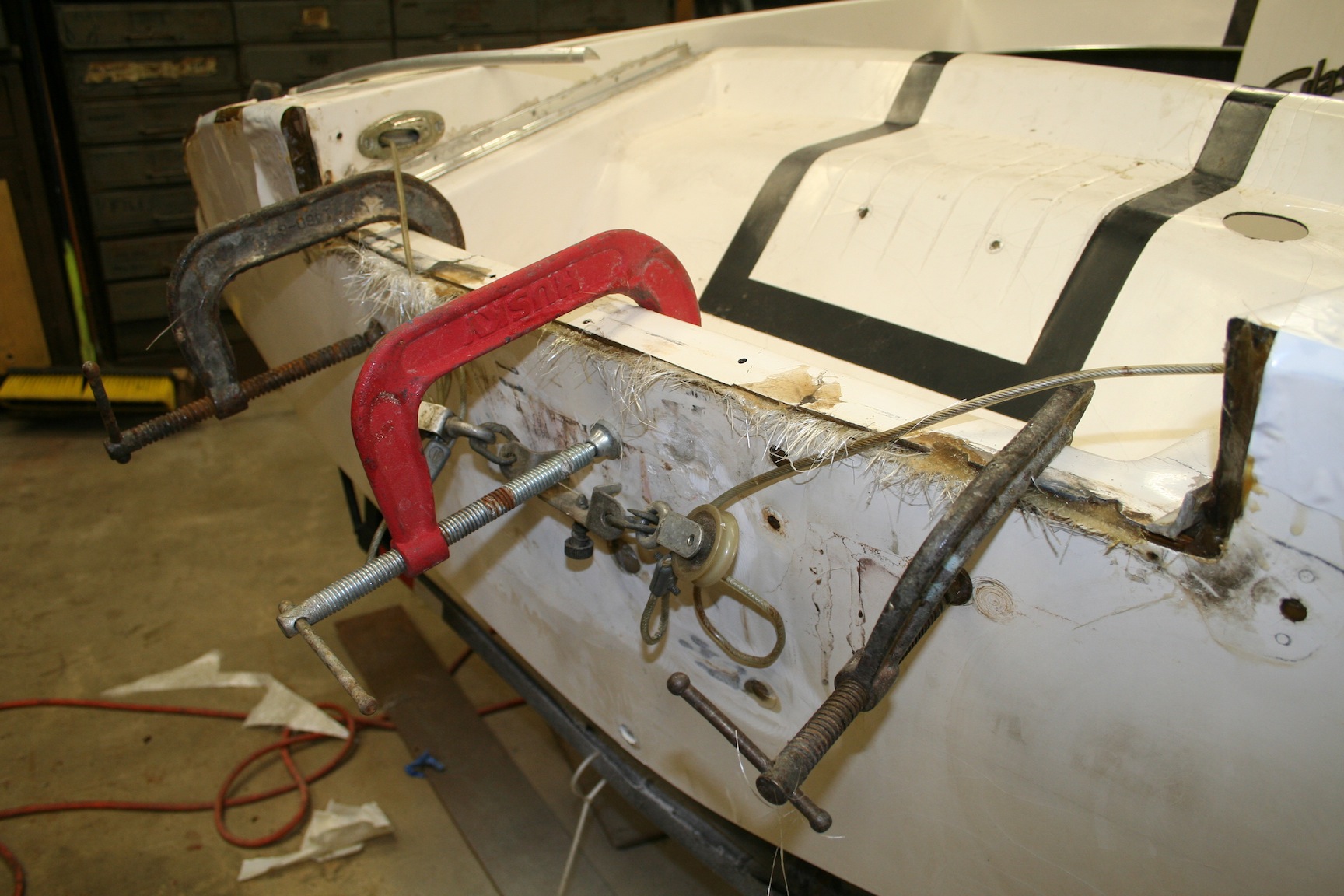

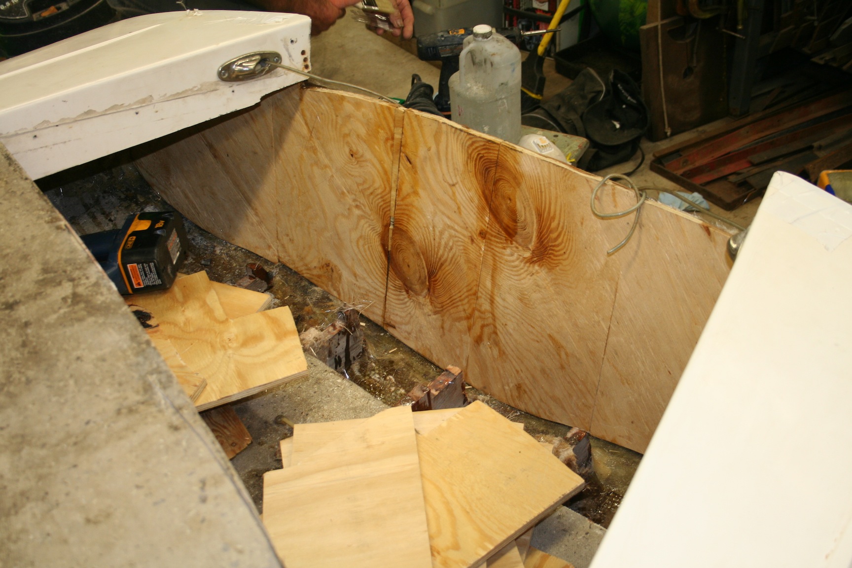

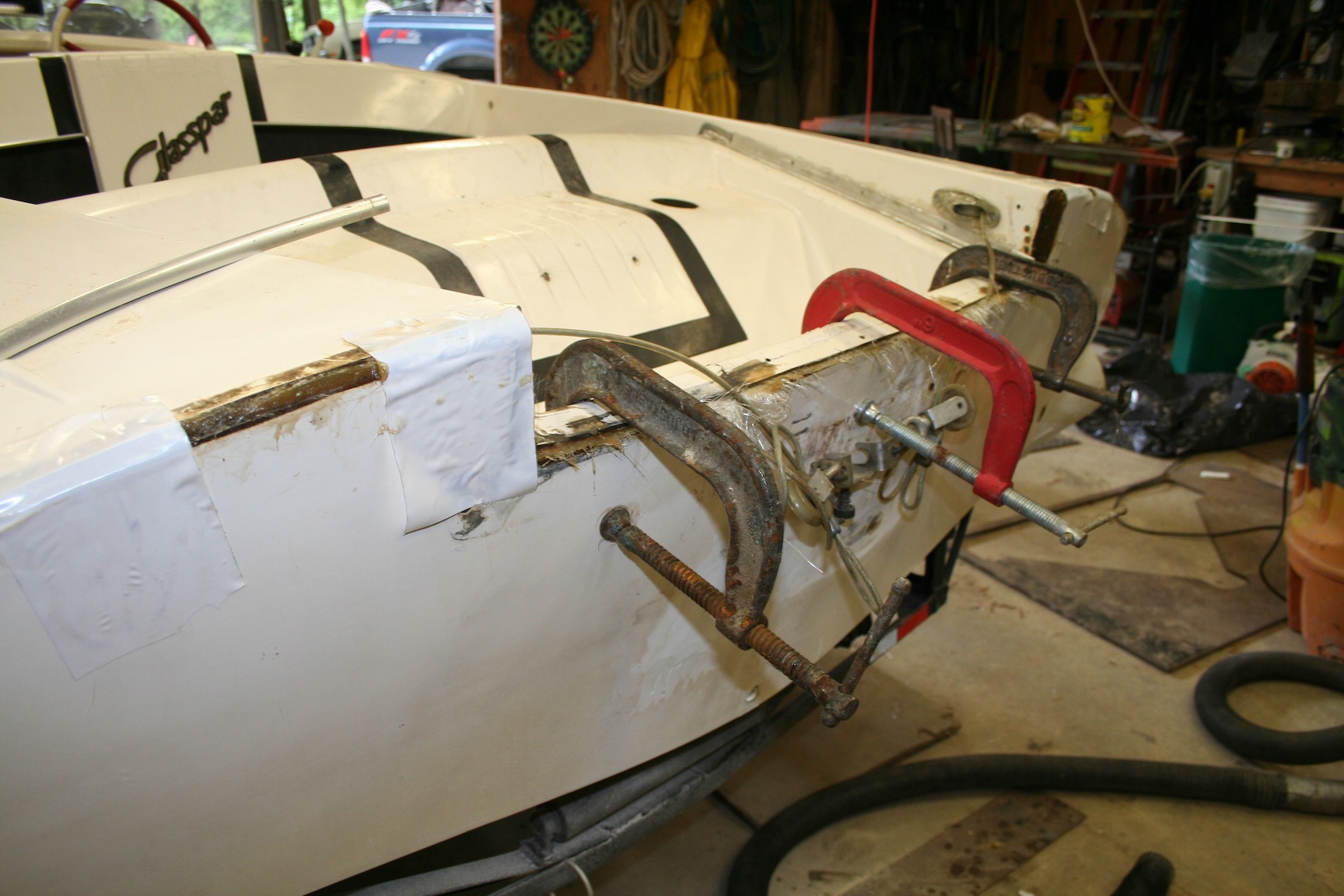

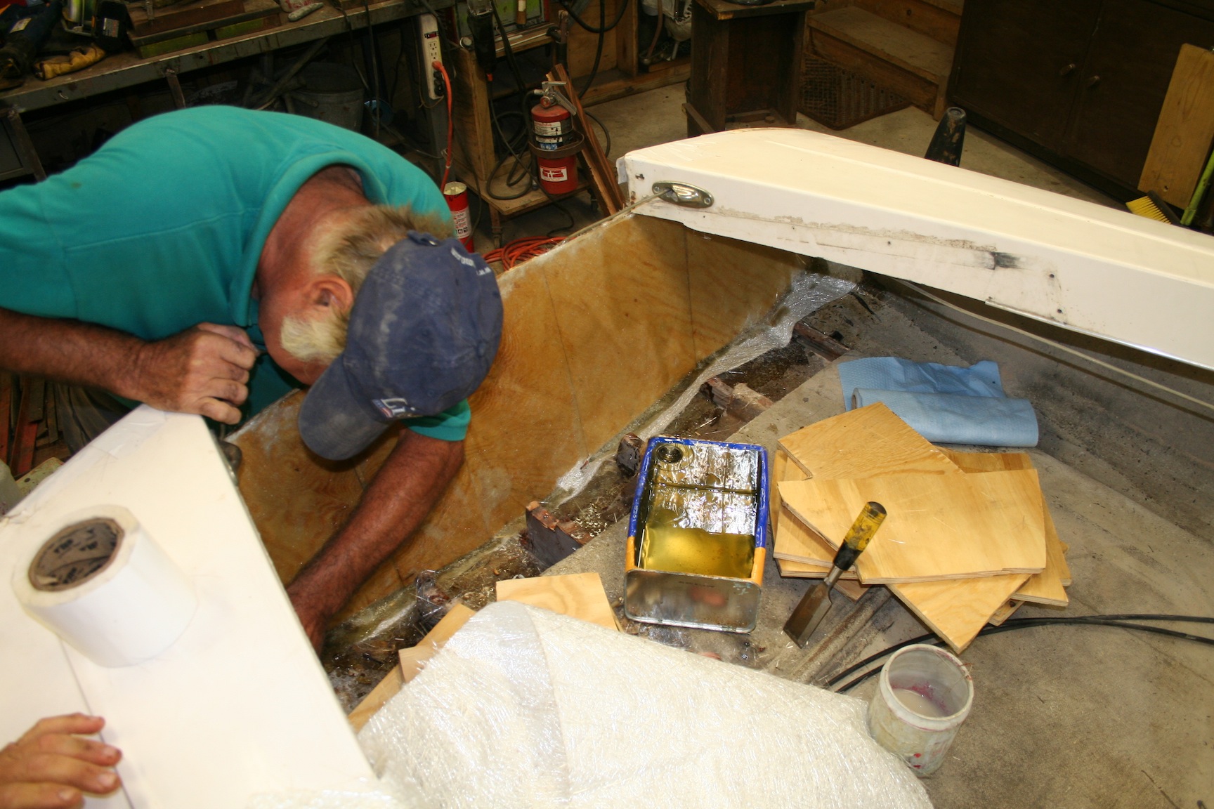

Re:BAD LUCK 15 years 2 months ago #42013
ALMOST DONE!!!!!
Re:BAD LUCK 15 years 2 months ago #42041
WOW......Ive never seen a transom put in like that before......I have removed some rotten ones though......I must say, Im shocked...

why exactly are you shocked? What's your opinion on this method of transom rebuild?

Re:BAD LUCK 15 years 2 months ago #42075
This must be some kind of world RECORD! A new transom in 2 1/2 hours? gotta wonder, how it could be possible without cutting at least a few corners in the process.... Looks good in the pictures, though....might be ok, for the 40hp LARK, just hope Derek doesn't have to RE-do it again after putting on some triple digit horsepower....good luck!
NUT
Re:BAD LUCK 15 years 2 months ago #42087
I like the method of rebuilding a transom that way. Its fast, easy, and should be strong.
Not much different than coring the floor of the "potato chip" hot rod boats. A G-3 which
was designed for 60hp and run with 75-80hp without ill effects will be just fine with that transom.
Derek should be very pleased he can get his boat back in the water before winter sets in. Some of us
have taken months to do the same job. Now put that OMC back on and have FUN!
