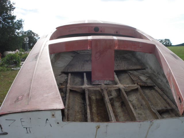

Here are some pictures of my project. As you can see, there's a little work ahead. Mike

Just a little work ahead... do you have the motor splash well for the boat? Its a critical componenet.

Yes, I have the motor splash well. That's one of the few parts that did come with the boat. I'll start the work on the main part of the boat and continue to look for the parts I need. Mike
Re:New to Glasspar's 15 years 2 months ago #40820
Can't tell how good the stringers are from the pic as long as there is no rot I would say to put a couple of layers of glass ib them and beef them up. As long as you can get them now it the time. Let see a pic of the transom from the inside to see how good it is down at the bottom of it. If good you might want to add a couple of knee boards too.

The strings appear good, I had planned on applying additional fiberglass over them. The transom is non-existant. It was removed by someone prior to me getting the boat. I work for a company that machines and forms wood. I was planning on making a form to hold the transom in shape until it's cured to get the correct curvature. Mike
