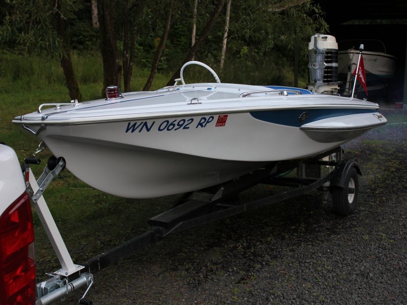

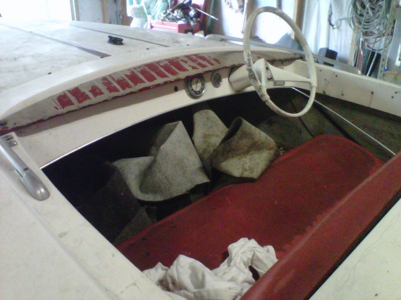

So I have finally finished my G3, a project that kept me off of the streets through the winter and spring months. I bought a derelict boat down near Salem, Oregon that needed a floor and transom and a few pieces of splash well trim. Thank's to Thom (Dr_Frankenmerc), I bought a few pieces and copied (sand cast) a few others. Darrell (ClassicMerc) restored a 1963 85 hp Ghost White Merc for me. I painted the exterior with Awlgrip and wet sanded and polished the paint and all the trim... It was a ton of work, but it came out well.
I just finished up getting the engine on this week, pulled it down to Shelton to see Thom, so he could inspect my engine connections (steering, controls, tach & gauge power) and bless it before I fired it up. All went well, and its now got some driveway running time on it. I borrowed a test prop from Thom and headed for the lake for some underway break in time this morning, only to find out I had a dead battery. So I if nothing else, I got a float test out of it.
I pulled some selected photos from the hundred or so that I have... for your viewing enjoyment:
Here is the timeline in pictures Dec 2010 to July 2011:
Bandit - 1959 Glasspar G3

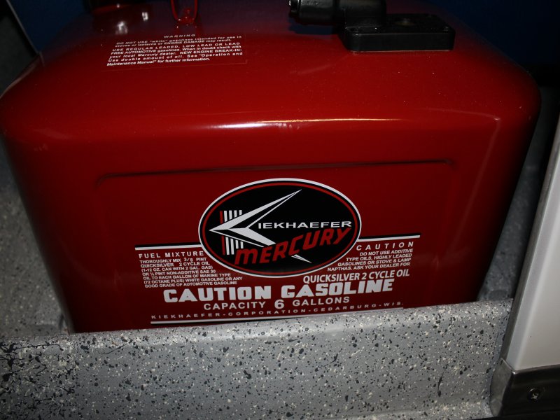

Dean your gas tank looks great and the metalic blue is pretty sweet:). Think Nuts seen this thread ;) but it might be a blessing he can't reply just yet,lol

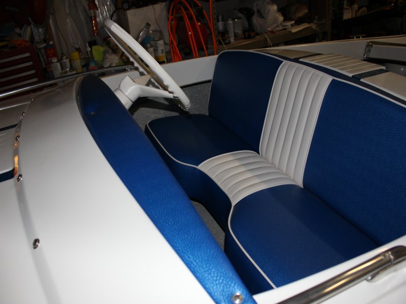

I didn't want to post anything until after Dean unveiled his completed project.
To fully appreciate the attention to detail Dean has put into his G3, you would really need to have it right in front of you in the bright sunlight.
You could even be armed with a huge magnifying glass to aid your inspection.
This baby is immaculate in every way and absolutely breathtaking.
Dean clearly spent a great deal of time researching the best ways to complete each step of his build, and then took on each task with obvious passion.
Even after the professional painter hired to lay on the final coats of paint had finished, Dean went back over the entire hull wet-sanding away any traces of 'orange peel' or imperfection until he had produced a gorgeous finish.
All the aluminum is polished and immaculate. Insanely immaculate.
The upholstery Dean selected is beautiful and compliments the metalflake blue accents on the hull.
The interior is as detailed as the finely polished hull.
Even the bidge and other areas not easily seen are completed as if they were to focus of attention. Clearly hours upon hours have been spent by Dean to insure every inch - both inside and outside - is pleasing to the eye.
Based on a lot of pictures Dean had shared as he progressed, I anticipated seeing a 'real nice job' when the day came that I would see it up close,...But I wasn't prepared for what I saw when that time finally came.
Chip Foose and his crew of experts would bow in respect for the level of excellence Dean has reached with his G3.
Just my humble opinion.
Thom

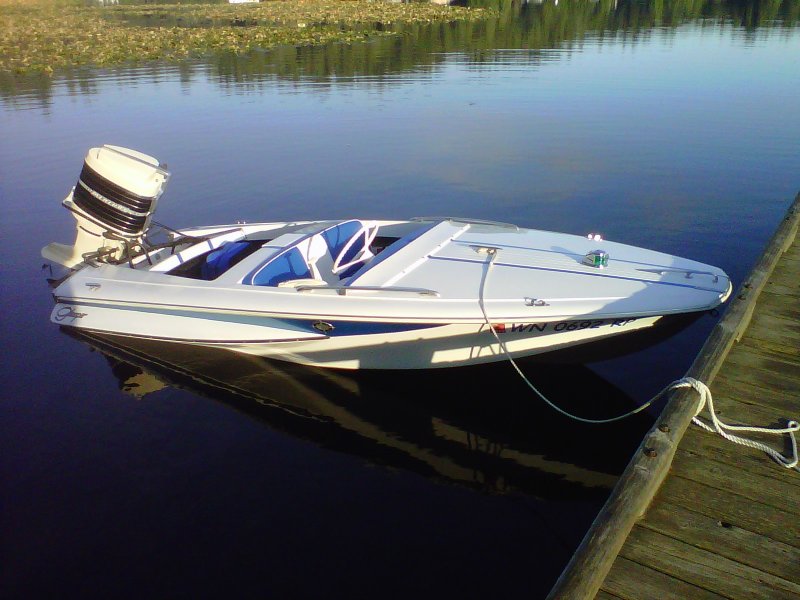

With just over 3 hours of run time on my break-in, I have began to reach WOT. My first attempt to WOT uncovered a fuel flow problem that caused starvation above 4000 RPM. I found due a faulty fuel line fitting at the tank end. Installed a Merc OEM fitting and headed back to the lake today... problem fixed.
Tried a 19P prop today, but it's a little too tall... I only get 4900 RPM until I trim the motor to the point that I get air into the prop, then I get about 5200 RPM. I think I need 500 more engine RPM so I am going to try a 17P next.

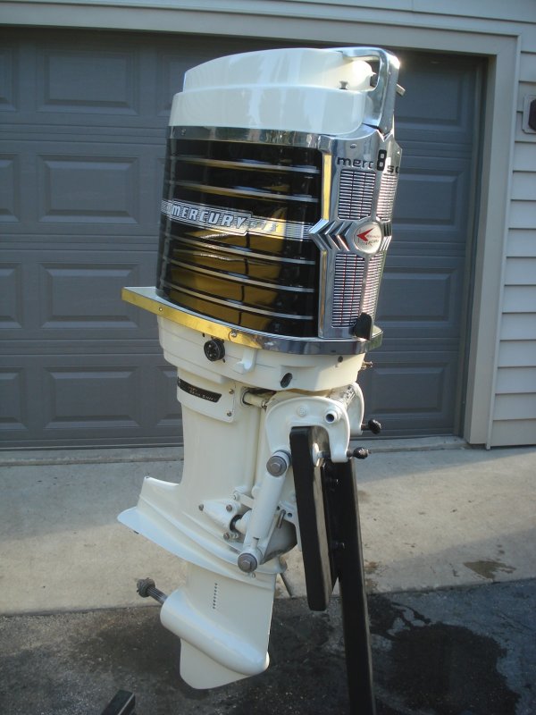

NUT, Thanks! You guys set the bar pretty high with your boats... If I get my trailer replaced before next summer, you might even see the "Bandit" down at your next year's Shastafest.
It's clear that you just LOVE :kiss: my "ghost white" Merc, I would have been disappointed if you liked it any less! This motor actually came after the "Dock Buster" era, I think it was Dr. Frankenmerc who referred to these as the "V4 Busters".
I didn't understand your term "absolutely hideous" so I looked it up in the OMC owner's manual glossary, and it means "(1) an image of a stack-6 that scares the crap out of an OMC owner, (2) an OMC's nemisis". So now I get why you almost lost your dinner when you saw it... Don't be scared man, its just friendly beast of an outboard.
