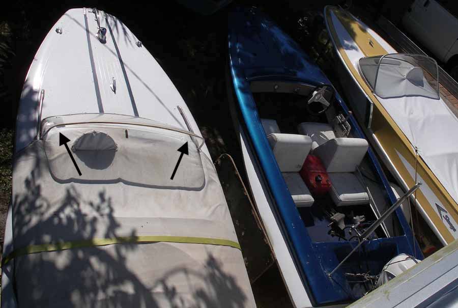

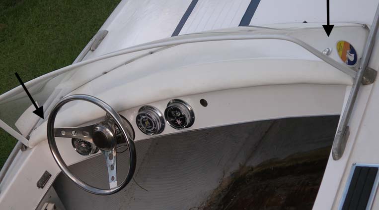

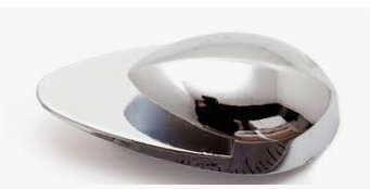

Kerry, I have a custom made cover on my centredeck, using a 1"x 3/32" aluminium flatbar bar sewn into the cover at the front, in conjunction with two 'rear hood/tonneau retaining clips' from an MGB (1970-1980s). These chromed retainers are fitted under the windscreen, are unobtrusive and approx 1-1/4" long x 3/4" wide. This gives a neat appearance and secure fastening at the front and weatherproof. Elastic rubber is used to tension the cover at the rear corners, hooked onto the rear cleats. Another sewn-in bar, acting as a 'hood bow', straddles the larger rear cockpit crossways, ensuring puddles don't form and collect rain. Removed, the whole thing rolls into a neat and small package.
Here is a pic of the MGB fitting, I will try find a pic of my whole tonneau/cover, which covers only the two cockpits but not the motor. The idea could be adapted or altered to suit your wishes.
Ken.
Boat cover for the early G3.. 5 years 3 months ago #145248
Here's the best I can find for now, but it gives you the idea.
I have used this method on many boats over the years. We get heavy tropical rainstorms here and this works fine. Travels well at 70mph without flapping or lifting.
An old pic from above with arrows showing where the clips are located. The other two pics show a bit more.
Hope this gives you some ideas.
