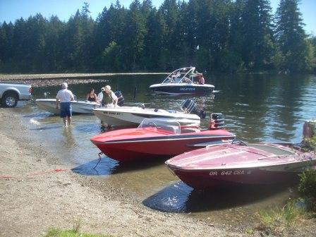

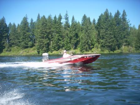

I run a1960 center deck with a 62 Merc 700. For pulling skiers I use a 15" pitch 2 blade and the motor trimmed down. For general cruising around with various loads 2 blade 17". For speed runs I have a 21" pitch 2 blade motor trimmed way up and all weight biased to the stern.
I have a pdf file of older merc motors and props reccomemded for specific purposed. Let me know and I can email it to you. for a G3 prop and trim is vital for different purposes.

Thanks for the info. This is the kind of feedback I was looking for. Your boat looks just like mine, i.e. red deck and white trim. Do you have a white hull and black accent above the sponsons? If so, we've got twins. I would appreciate having the PDF file for reference. I'm not all that into speed, but a little can't hurt. Email to: This email address is being protected from spambots. You need JavaScript enabled to view it.. Thanks.

couple pix of H Haynes's 700FGS powered G-3
