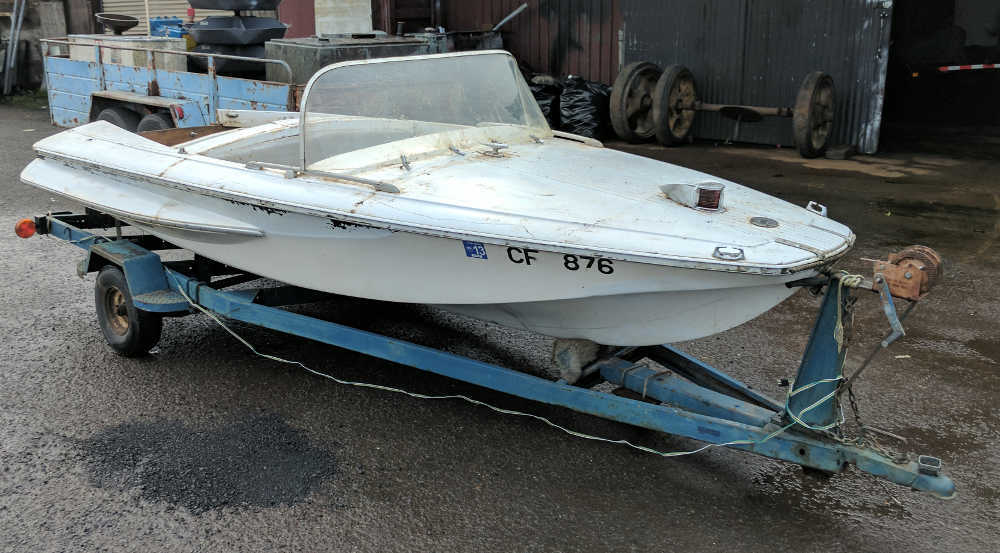

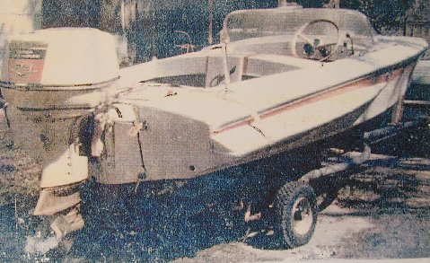

Here is that ad that I saw with the boat for sale.

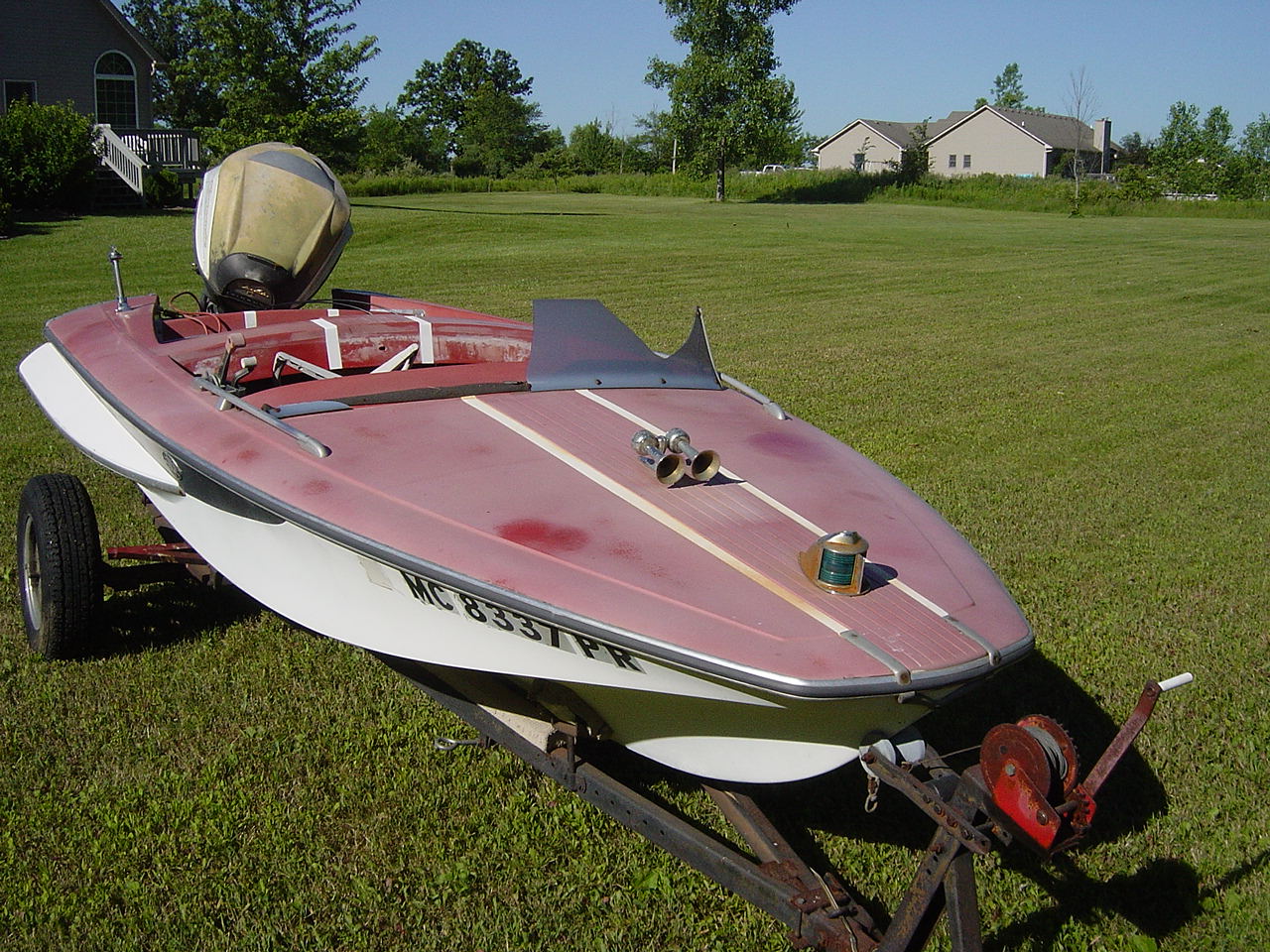

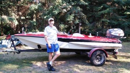

And here is a picture of it in front of my shop.
Re:New to me G3 9 years 9 months ago #130271
Chris, it looks like you have a pretty nice G-3 there. Have you had a chance to check the transom or floor condition yet? Also, what size Johnson Outboard was on that boat? I couldn't tell from the pictures. When my Dad first purchased our 1960 G-3 he had it set-up with a 1960 Johnson 40 H.P. Outboard, but about a year later traded that in for a 1960 Johnson 75 H.P. which helped my older Brother be able to get up on skis as he was very tall. That 1960 Johnson 75 was on our G-3 for almost 20 years before my Dad replaced it.

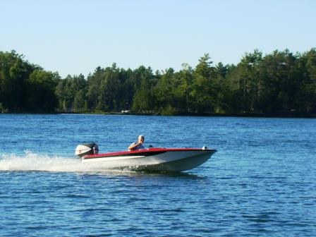

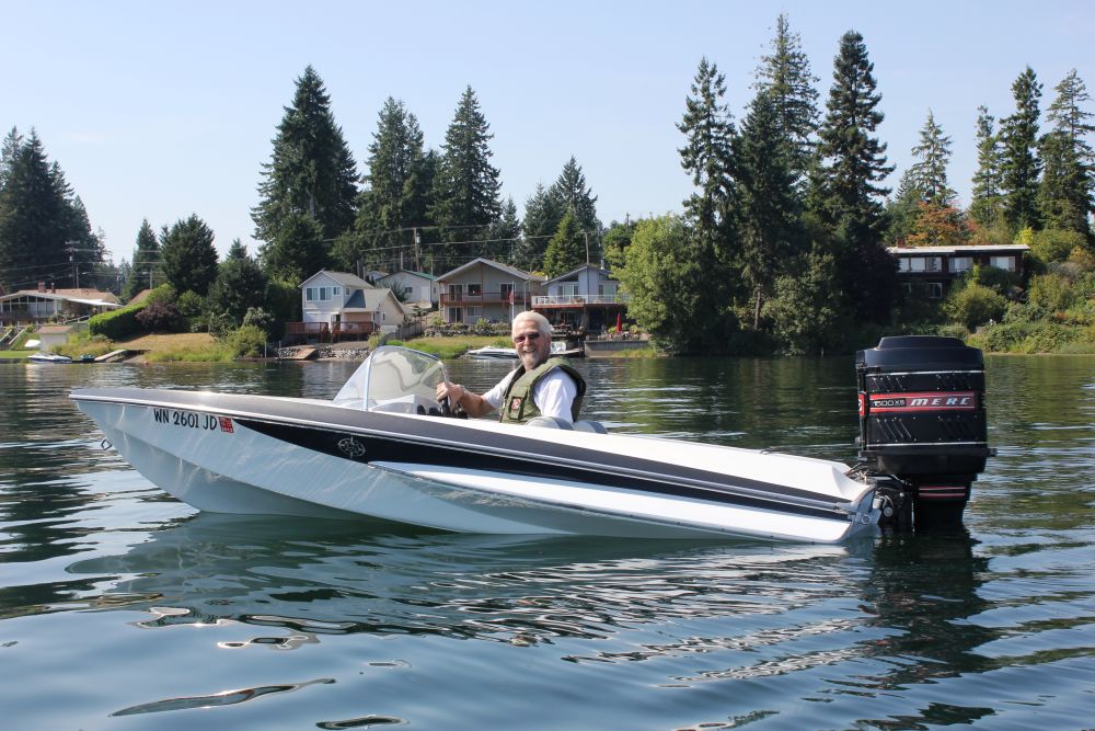

Very nice sir!! Now, after restoring it, you will need to have more hp (60-75 hp) on the G-3! It was a go-fast ski boat when new and it can't go fast with a 35 hp engine! Here is mine with a 1969 100 hp Merc! I raced boats for 20 years including a 1960 G-3 I bought new in 1960 with a 75-hp engine!! Enjoy and keep us posted on its progress!!
My first one with 75 Johnson and the one I have now with the 1000 Merc "tower of power (1969)"
You don't need 100 hp, as it is a bit scary, but 60 to 75 hp works great on the G-3!!

Here is pic of the G-3 I now have with the 100 hp Merc!! Run this one and never get the bottom wet!!!!lol

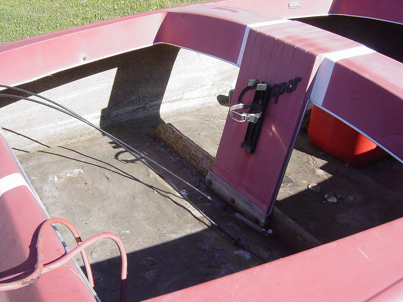

I spent some more time inspecting and taking pictures of the boat yesterday. I have updated the webpage  http://fattiretrading.com/g3.html with new photos.  Two or three of the stringers ( I want to call them joists) under the front deck have completely rotted away. Were the outer deck stringers originally double, or did someone sister new ones in later?
Thanks,
Chris
Re:New to me G3 9 years 8 months ago #130337
WOW Chris,.....you definitely have your work cut out for you Sir!
As Jim said, no, that is NOT the original seat and it looks like the prior owners tried to re-fiberglass under the front deck but did not use any fiberglass resin to make the cloth adhere to the old surface! However, those seat brackets fiberglassed into the floor DO LOOK ORIGINAL!
Chris, those deck stringers or "joists" also do NOT look original to me. On our 1960 G-3 Glasspar put fiberglass tape AND resin over our deck stringers then painted over that with the original gray "Zolatone" Interior Paint that they used on most all of their boats. I will try to get a picture of here for you so you can see what I mean.
Also, I noticed on the transom that it appears they have "through bolted" a piece of wood to hold the motor on. But you will have to redo that transom anyway.

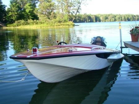

Here's a few before and afters of my project.
Douglas Speck
