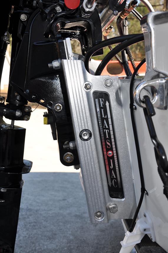

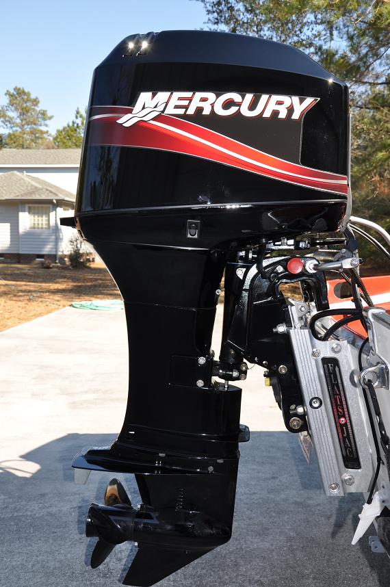

I faced almost the EXACT dilemma you are now in with our "one-family" owned 1960 G-3 back in 2009. Like you, our 1964 Mercury 65 HP Outboard was shot and I did not want to "raise the transom" as I don't like the way they look when that is done. I also wanted a new/or newer outboard that would be reliable for me and my family.
I ended up buying a NOS 2009 Mercury 50 H.P. Outboard from "Bass Pro Shops." They were closing out ALL carbureted outboards due to EPA emission regs and I got a VERY good deal on a new motor. At the time, as you said, all the newer outboards had the 20" lower units.
So,...I talked with several other G-3 owners and learned that "Bob's Machine" down in Florida made a very nice hydraulic jackplate for our boats with only a 3 7/8" setback!! I was told by a few members here and on other websites that a jackplate like this would NOT work on a G-3! That was absolutely FALSE Doug!! The "Bob's Machine" jackplate we installed has worked GREAT and I like being able to raise or lower the engine with the touch of a button! :)
I am including some pictures of our set-up so you can see how it looks on our 1960 G-3 with the original transom:

Also, another picture of our set-up:
