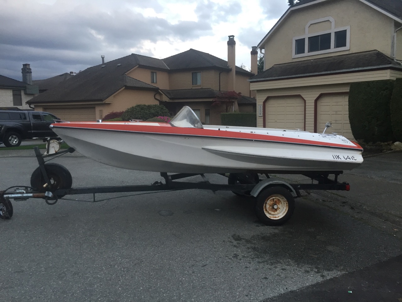

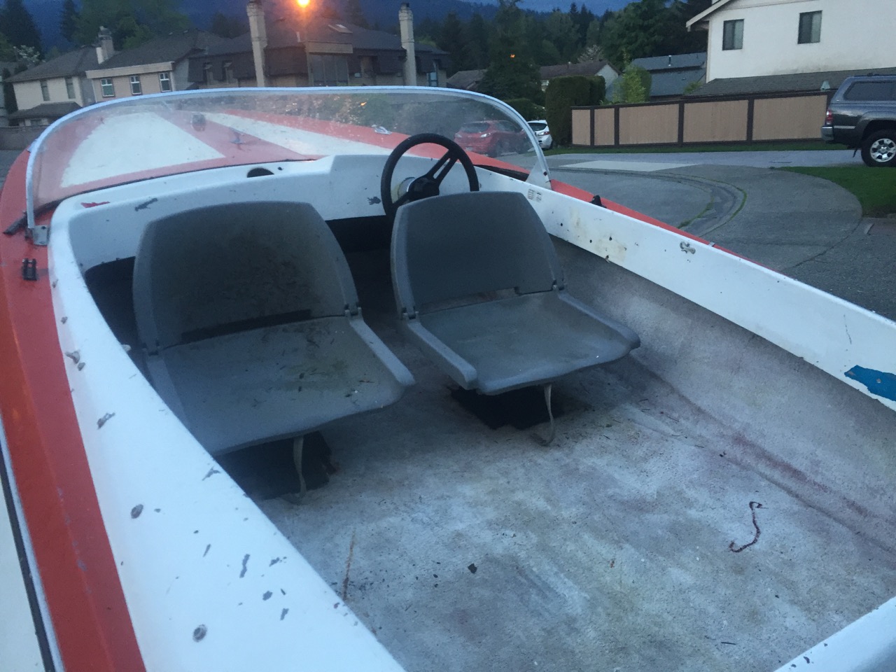

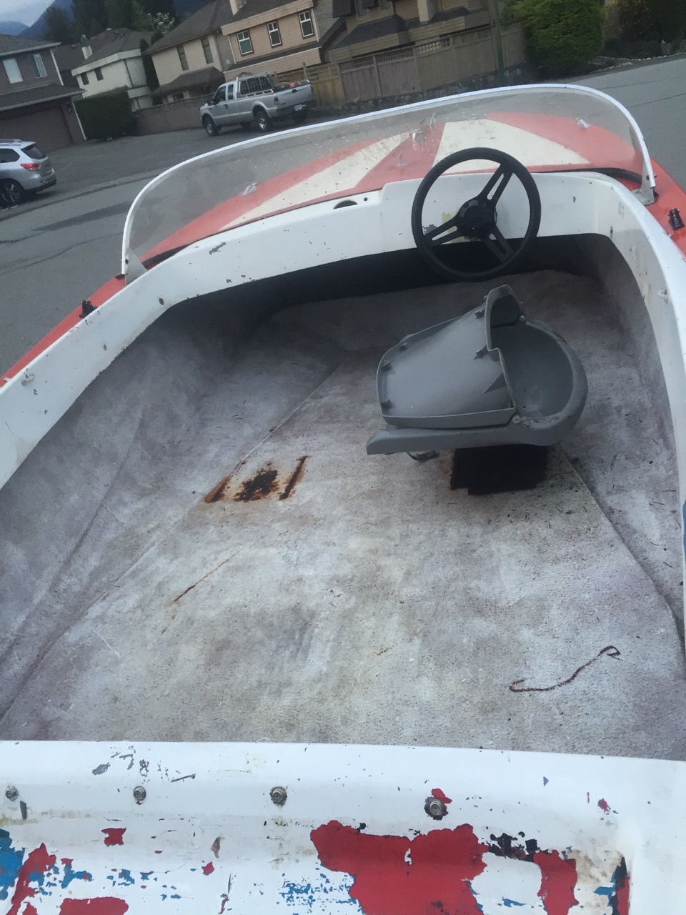

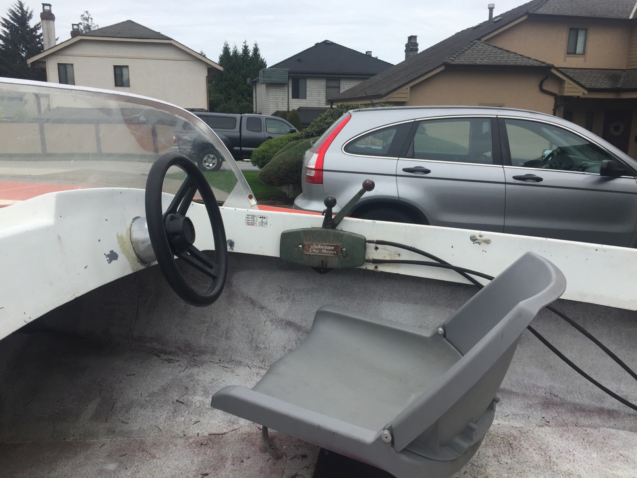

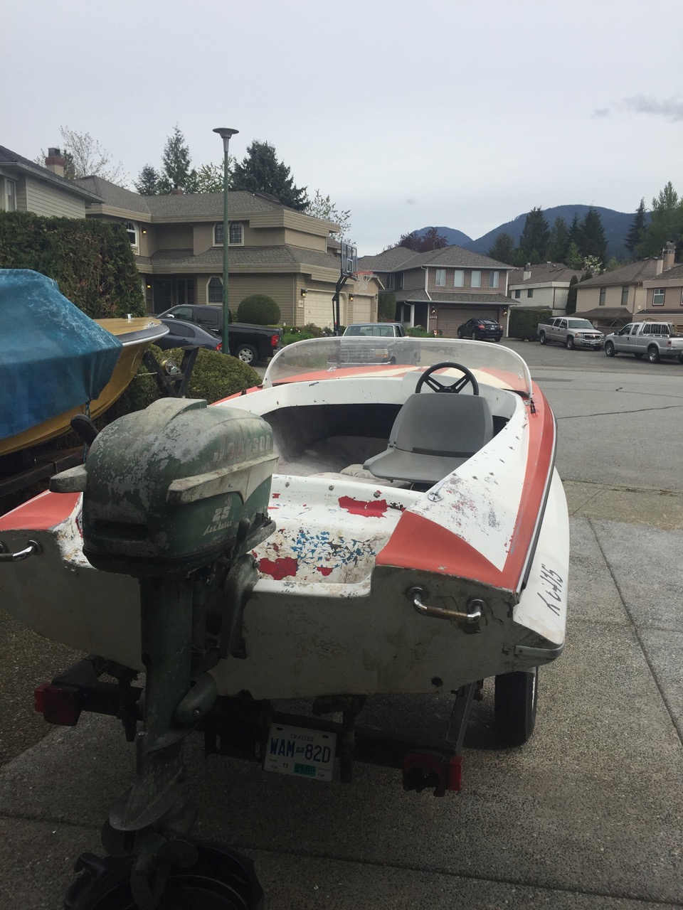

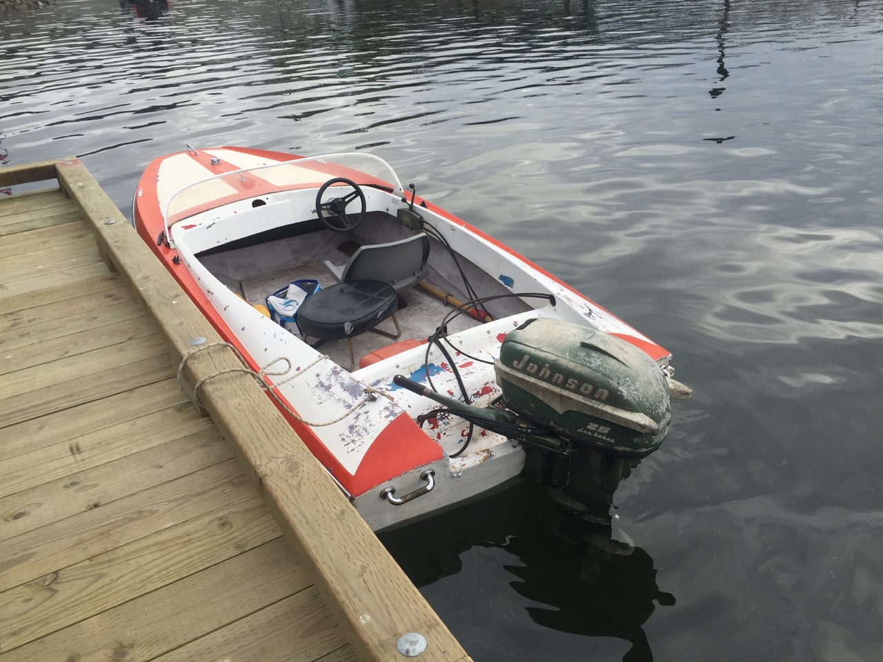

Hello everyone :-)
Just got my approval email so I had to post!
I recently acquired what I'm pretty sure is a G3, some of the guys at screamandfly.com confirmed it and suggested I come here. Is there a way to find out what year this boat is?I couldn't find any markings or serial numbers, but I also haven't had much time to look yet and it needs to be pressure washed before I get up close and personal lol.
Let me know what you guys think.

Welcome Logo,
Yes you have an 'open cockpit' G3 probably made in '62 or '63 (the twin cockpit, or 'centre-deck' was made only from '59 to '61).
They originally came with a flip-back passenger seat (to observe a water skier) and it appears that your seats have been replaced at some stage.
No G3s were made in '64.
From '65 to '67 they came with back-to-back seats accommodating 4 people. It is possible yours is from this period, again with the seats replaced. The hulls were identical.
They are a fabulous boat and I am sure you will love it.
It is my observation that most owners keep and use their G3 for a long time – there has to be a reason for that!
This is a great site, much information available and many fine people here willing to assist if needed. It is worth the time to familiarise yourself with all the information and resources here.
Have fun.

Thank you for the welcome :-)

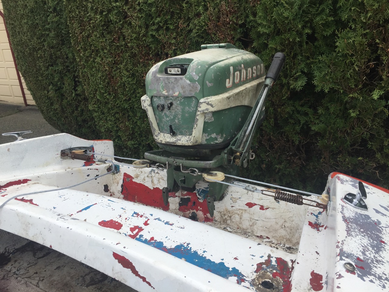

I just got the boat home, pressure whashed it a bit before bringing it over, there's at least 2 layers of paint that began peeling so it's been repainted. I believe the gelcoat is red on the deck with a white hull. The seats have definitely been replaced and will leave them on for the short term, I do however have a pair of back to back seats that I'm thinking of installing. Will have to shorten the boxes as they would too high as is.
Anyway, I'll post more pics over the weekend. Oh and I'm mounting a 1955 Johnson 25hp outboard on it for now, will find something with a bit more power later but I got this engine not long ago and have been bringing it back to life with the plans to do a full restore of it over next winter.

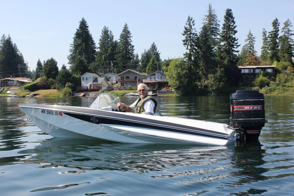

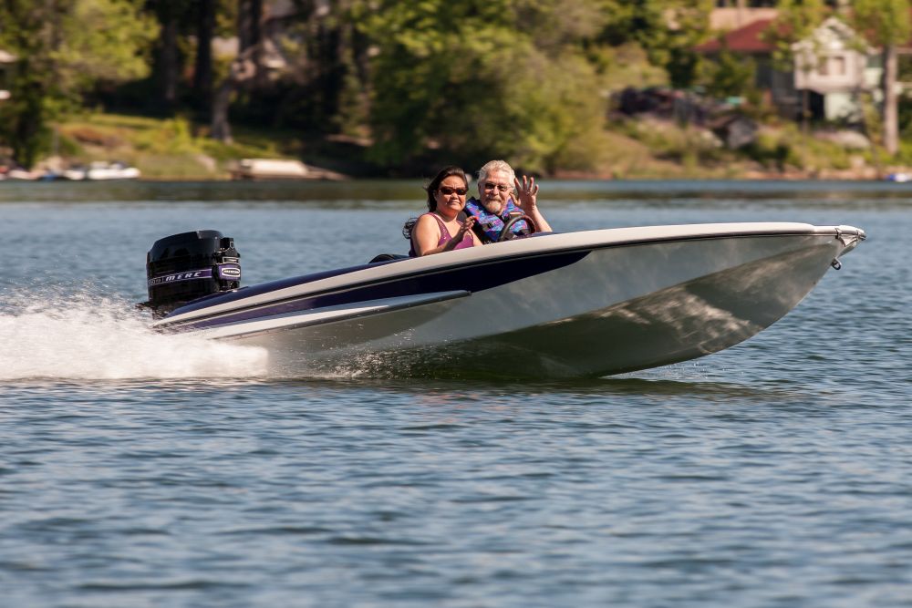

Originally the G-3 had a 15" transom, which requires a currently limited choice of motors.
Some G-3 rebuilders bump the transom up to 20" to accommodate the easier purchased outboards available today.

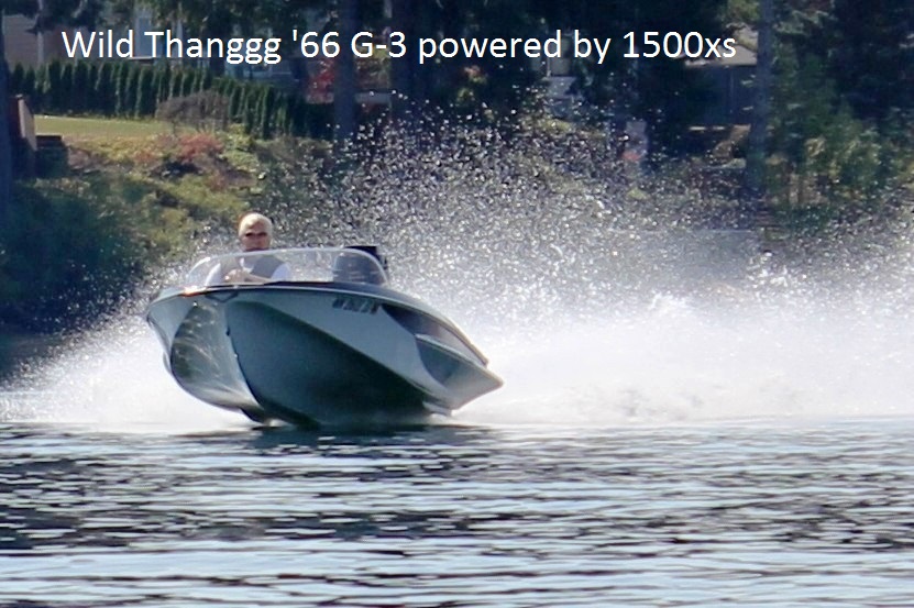

Being a die-hard Mercury fan, I left my "open cockpit G-3" the original 15" transom.
I installed a 1500xs on my '66 G-3, and installed an 850xs on my wife's '66 G-3.
Although my '66 GPS'd 72 MPH one time and ran consistent 66 MPH runs, momma's G-3 runs consistent low 50 MPH runs, which is perfect for the 'open cockpit' G-3. (earlier G-3s had a duel cockpit design that is the most desired, but I'm too tall to fit comfortably in a dual cockpit.

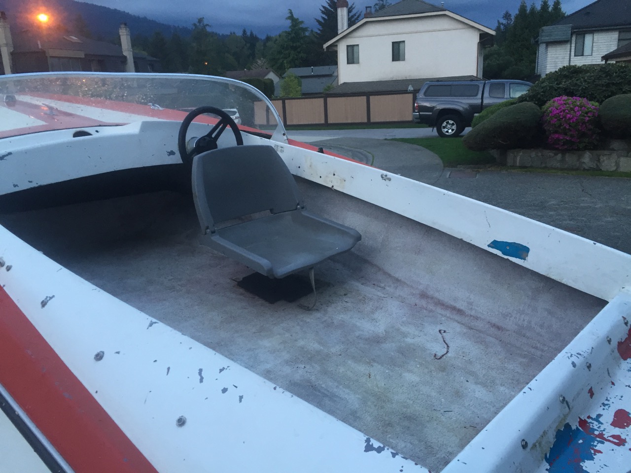

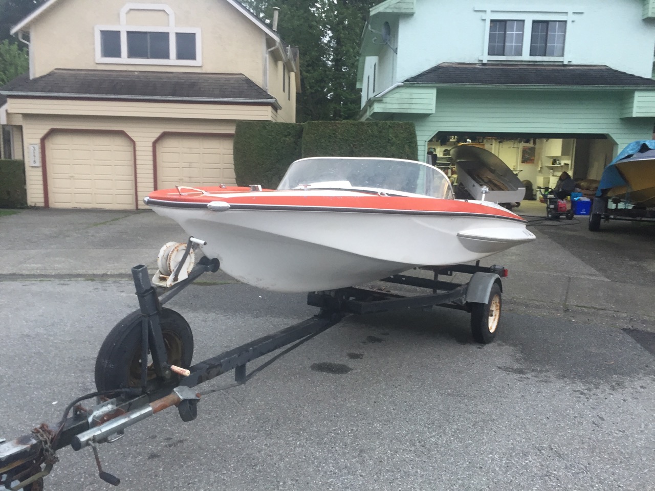

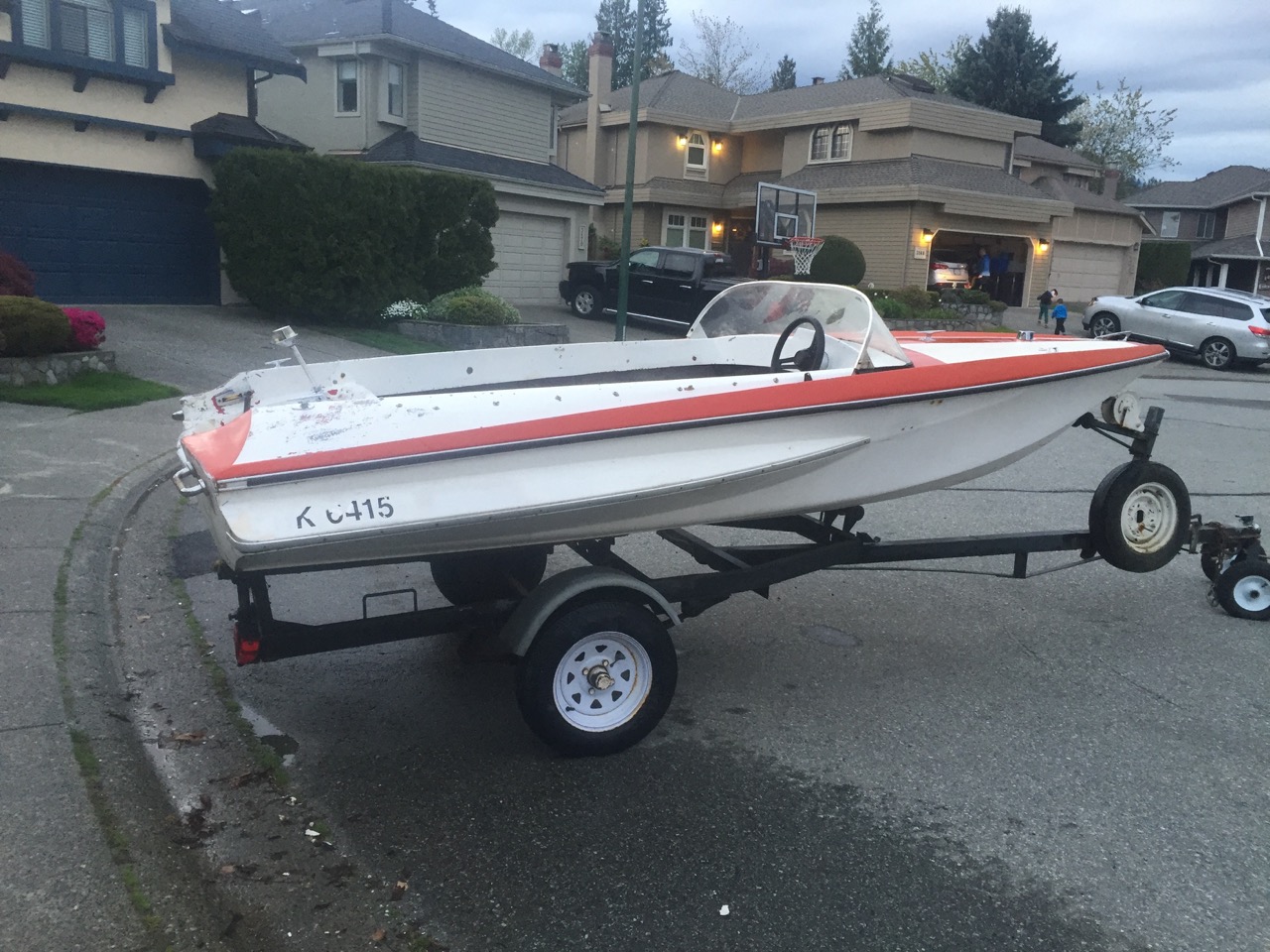

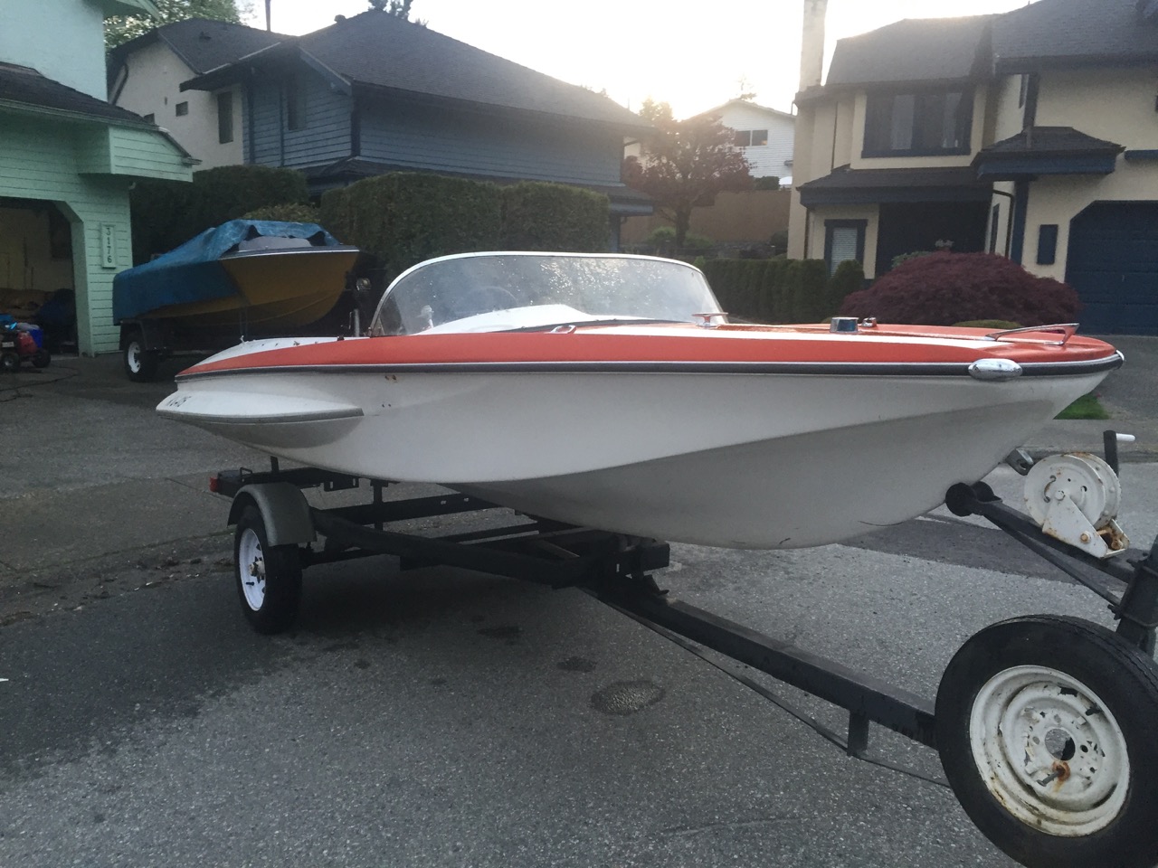

After spending a couple of hours cleaning it today :)
Re:New member with new to me G3 10 years 6 months ago #121429
She cleaned up real good, nice find.
Welcome, Gene
Re:New member with new to me G3 10 years 6 months ago #121430
Not bad for a hundred bucks :P

Why would you waste time putting a 25hp on the g3, fishing? Wont even get a g3 on plane. A 35 hp its self is pretty bad. The guy I bought my first g3 from had a 35 from new and upgraded to 65 which was perfect for me. just saying?

Because that's what I have in my garage right now, and it will have no problem getting the G3 up on plane. It got my friends 16ft boat up on plane :) It is also no big deal to put it on as it's just a clamp bracket so won't need to drill holes for bolts. I am looking for a Mercury 850xs or like Doc's 1500xs, however the transom in its current state won't survive with either of those motors.

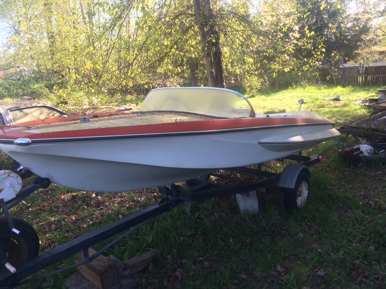

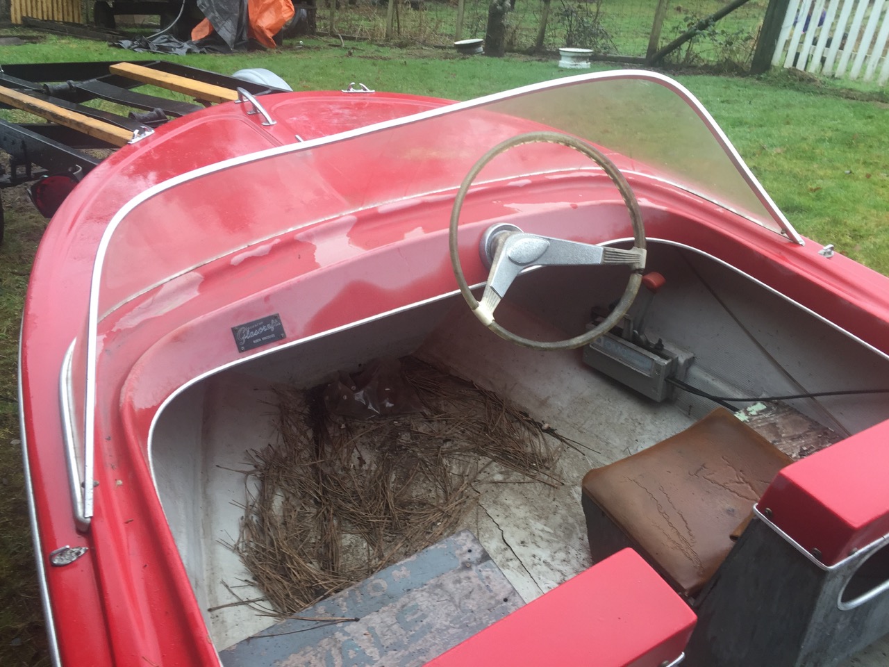

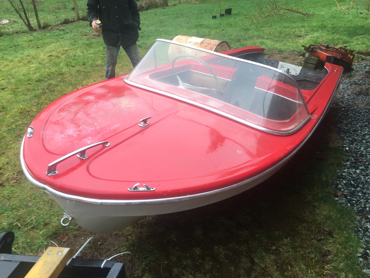

These are my other boats, one is undergoing a restoration at the moment and the other is good to go anytime.
I'm restoring a 1956 (I believe) 12.5ft Hourston Glasscraft (built in North Vancouver), the 1955 Johnson 25hp will go on this boat after being restored as well.
The other boat is a 1970's 14ft K&C Thermoglass with a 1994 Yamaha 70hp.

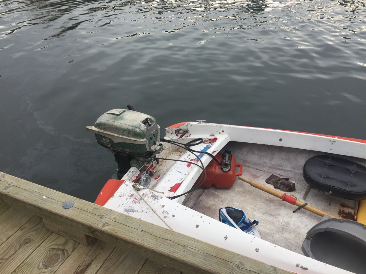

It doesn't sink and I got it up to 20mph with the old Johnson 25. Get's up on plane without any issues with 2 people on board.

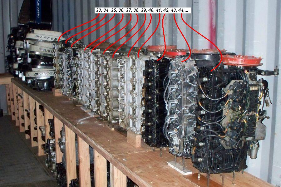

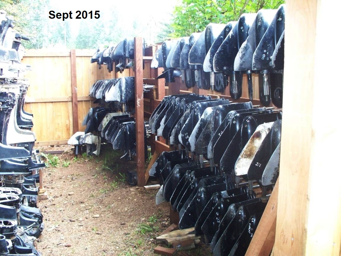

That motor will need a lot of work. Look, you are just over the boarder WA right? The "Doc" here in Shelton, WA near me in Olympia, either has or will build ya anything ya want. You can come down here and pick it up. Trust me, he sure has MANY motors and parts. But be up to you two to figure it out. You are in no rush, so if he don't chime in here soon, I'll ring his bell. And it will be ready to bolt up and go as he don't sell junk. Not cheap, but you would be putting money in any like that one posted anyway. Gonna do it, do it right. It will be worth it! Some Doc's "junk"..( and he built my motor for my Flatty..last pix)

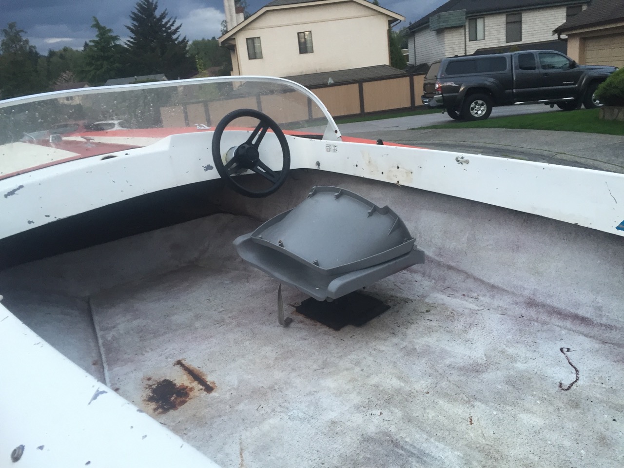

Well I see the spoonsoon drain plugs are installed in the back !! Can you see under the sump opening if you have wood or fiberglass stringers ?? Mine is a 1965 it has the fiberglass stringers !!!

And be careful when you install seats there's not much room for long screws , on the side You can go thru the floor right thru the bottom of the boat !
Re:New member with new to me G3 10 years 6 months ago #121638
There is no sump opening in my boat and the splash well isn't removable, it's part of the deck. I'm not tearing into it for a few months so I won't know about the stringers for a while.

The splash well is supposed to have all the metal trim and brackets that hold it up ! I have all the pieces but I gotta sand down and paint it before I put it back in ! But Some of the guys leave it out ,you get more leg room in the back seats
Re:New member with new to me G3 10 years 6 months ago #121652
It's not removable on my boat, it's molded right into the deck, no metal trim.

LogoF,
It looks like someone must have already done some work on the G3 since the splash-well is glassed into place.
Not suggesting your transom & stringers, etc aren't due for a full make-over, just pointing that bit of trivia out about the splash-well.
I did the same thing to Wild Thanggg to give more strength to the way the transom is secured to the hull.

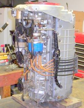

The 650 3 cyl you posted isn't a very good choice IMHO, but the shorty driveshaft housing (DSH) and lower unit can be used under a late '70s-early '80s 70 3 cyl provided you keep the 70 HP exhaust extension plate with the powerhead.
This 70-3 should no be mistaken for the '88-'92 loop-charged 75-3, which is a totally different animal that won't swap out with any of the aforementioned little beasties.
Another cool application that can be married to this shorty DSH is the '70s-'80s 3 & 4 cyl 500, or '89ish 40 hp 4 cyl. Not 'go fast' power plants, but food for thought. You would need to have all the relative cowlings that match the powerhead for these swaps, and although the gear ratio in that 650-3 lower unit might not be OEM correct for the other horse powers suggested, it will work just fine.
A lower shift shaft shuffle might come into play too.
I've already trolled past you with a few go fast shorty Mercs, and I hope you are still staying awake at night considering them, but I don't think I mentioned a freshly rebuilt & re-machined 1350 6 cyl shorty I also have to offer up.
Tease - tease - tease!!!
