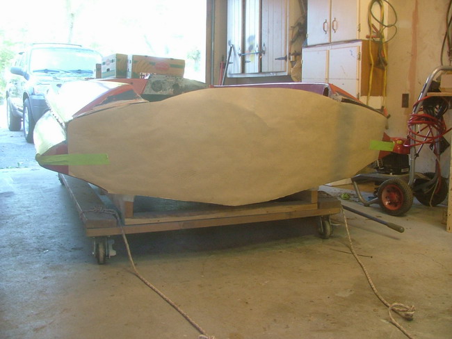

It looks like it is a '65-'67 model.
I did extensive modifications to the bottom of my '66, and clearly gained speed and cornering ability, but I also had to add after-planes to stabilize the beast.
I can not encourage any of my modifications. The G-3 is an awesome little sub-50 MPH boat, but above that is a risk of ruining a perfectly good little cruiser.
As Mark said,...Buy a Hydrostream if you want to break the sound barrier. That's what I did :-)
doc
